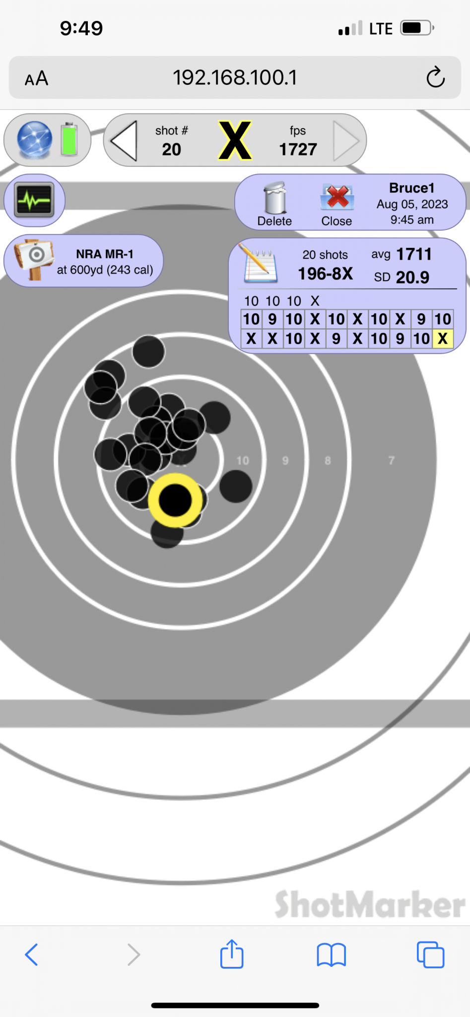

I will be the first to admit to my questionable sanity when it comes to shooting. I have used 1/4 minute scopes at mid range matches and have found that I can have a group building the edge of the x ring at 9:00 and one click on the 1/4 minute scope would move me not far enough but 2 clicks and I have movement more that I wanted. Three clicks on an 1/8 minute scope would have put me where I wanted. I am splitting hairs but with the option to make the finer movements I prefer it. As for clicking up or down for range; I come from the Smallbore World with a rear sight that was 15th minute clicks...1/8 minute will be a snap. Please remember I am returning to competitive shooting after an almost 20 year layoff and building on my previous experiences.
As I stated at the start my sanity when it comes to competitive shooting is always in question :ROFLMAO:

Well he can shoot smallbore prone at 100 yards like this: https://www.snipershide.com/shooting/threads/whats-a-good-100-yard-group-size.7189979/#post-11160497
So I believe him when he says he can find a 1/8 scope useful in mid range prone matches. Mid range is 300 - 600 yards in NRA competition.
And if he can use a 1/8 moa scope effectively at 600 yards, it ain't gonna hurt him at 1000.

Did you look at the target that he attached to the post you're quoting him on?
I mean, dude, unless you can do routinely better.............
I didn't see any reference on the picture. How large is the group? Is .6" going to effect the score?
I thought to myself, not too bad. Then I read 10 shots, irons and sling...
I couldn't do that in 100 tries if my life depended on it.
