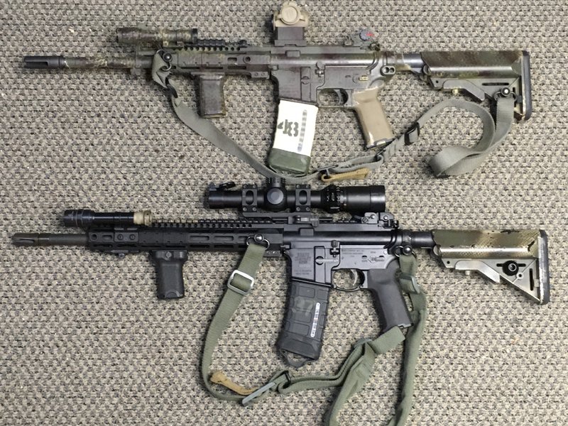

I appreciate this response and it’s counter to the approach I was going to take for my spr.
Big fan of the Burris 1-5X version.. love the features.. I find the reticle to be well thought out and useful to me and the daylight bright Horseshoe reticle. One of the best value optics out there in my opinion.
