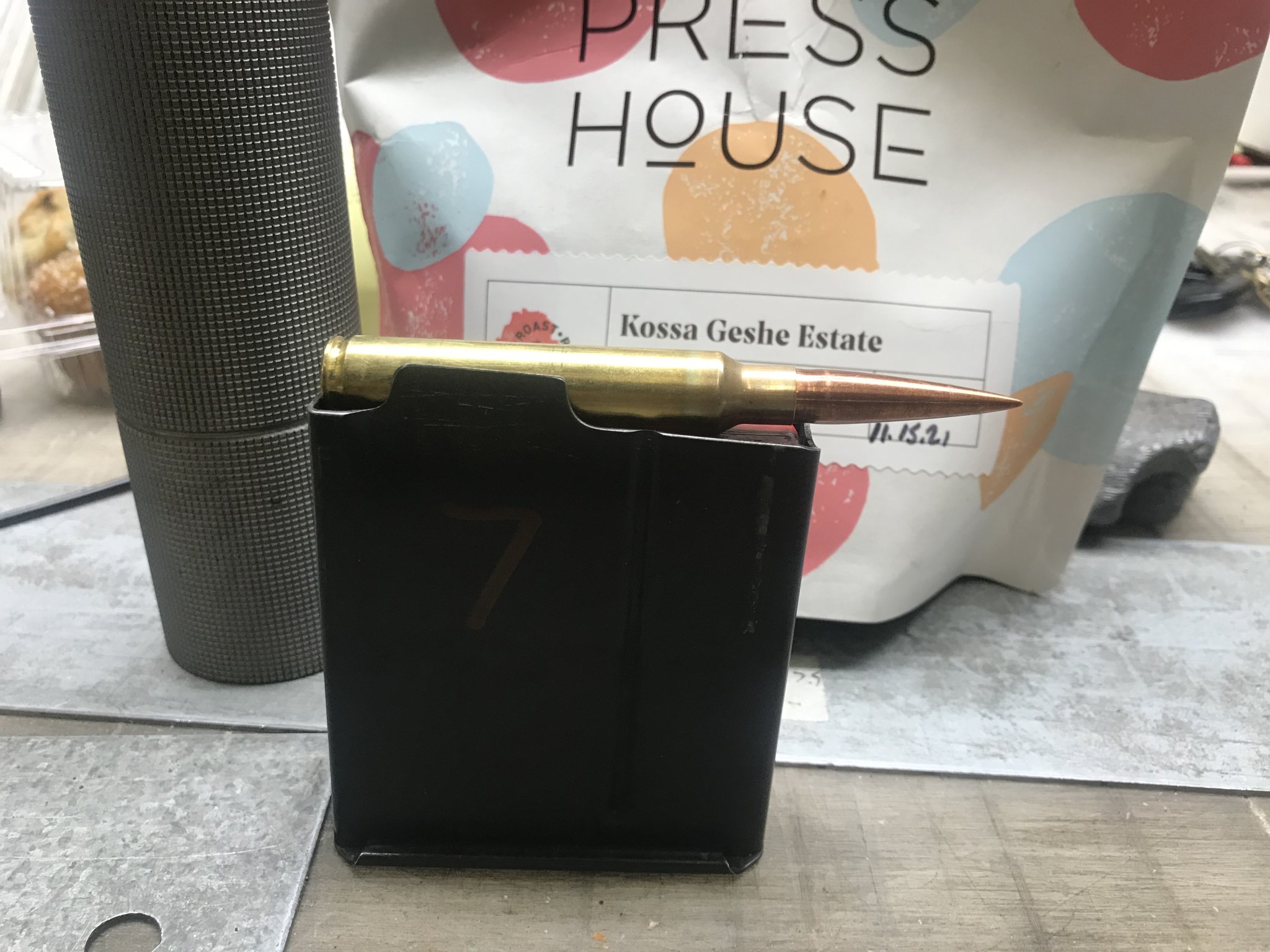

.338LM is also a good choice, but you have to be a bit more picky on the ammo, most standard ball match 250gr stuff isn't really the greatest for a mile and a lot of the 300gr stuff just isn't quite right. You'll probably want some match or solids in the 265gr to 285gr range and then you'll do good.

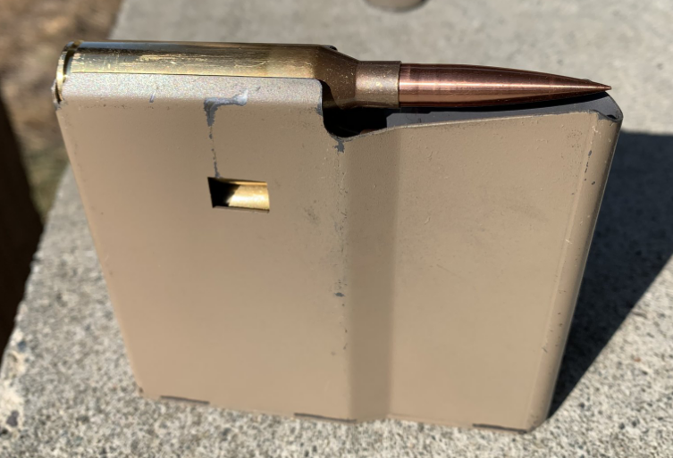

If you custom load some decent badlands solids and don't care about magazine length limitations (so you single feed), 2500 yards is not a problem and you can push a bit further.
.338LM is a great platform but it's limited by magazine length. If you go single feed and run some of the high BC solids or standard stuff you can get really good accurate distance. It's going to be a bit more work however than just grabbing the .300NM easy button
The good news is that pretty much most .338LM rifles can go .300NM with a barrel change and the same is true for most .300NM rifles going to .338LM

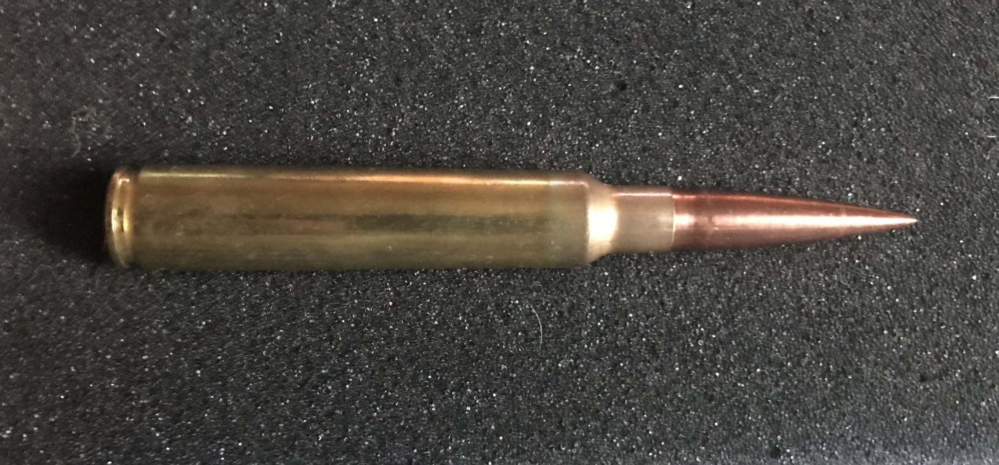

The 338nm solid might able fit the mag. After I burn my 338lm bbl, I went with 338nm.

When you are shooting 1 mile plus...why you guys trying to stuff the rounds into a magazine? This is single feed time. You have time to extract...load new round without taking eyes off glass...chambering and making your own corrections. Or maybe I'm different...I only have about 5,000 rounds at targets 1 mile and beyond....and yes..I still suck.
Because my brain is still stuck in the Army's tactical mindset. ;)
But yes, I single feed mostly anyway; it's just interesting to me when even a long cartridge combo ends up fitting my mags.

One of the biggest issues with solids (apart from magazine length) is you have to make sure your barrel twist rate is fast enough for them, or you'll get bad results.
Most of the makers list a minimum barrel twist, so for example if you have the older standard 1:10 twist on your .338, you might be limited to stuff in the 255gr range, but if you have a faster say 1:9 twist or 1:8 or such, you could move up to the much nicer 285gr stuff
Solids want to be driven fast and spun fast. You need to do both for good results.
