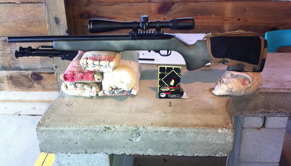

For those who want the long version: 10/22 I accurized about ten years ago, it used to shoot 1moa or better. At least 6k rounds downrange, groups and overall accuracy is deteriorating. I've been through the scope bases, v-block, re-bedded the action, I've played around with action screw torque and barrel preload... no improvement. I've even swapped optics. The bull barrel on it now is a cheapie (shooter's ridge) and served its purpose; since different ammo no longer makes any difference whatsoever I believe the throat is eroded. Time to upgrade;)
Have you checked for leading in barrel and tried to clean it out? I personally have never hear of an eroded throat on a 22lr........(unless abusive cleaning has taken place)
I had a cmp 40x that was not performing up to snuff.....I thought maybe somebody had messed up the barrel or something in the course of its life. Before I gave up on it and upon the advice of another rimfire shooter, I de-leaded the barrel and especially the chamber/throat area. I used a good brush and shooter's choice lead remover. Groups shrunk almost in half.
I have a 10/22 that I put an old cheapish butler creek bull barrel on a decade ago........it still shoots lights out but I do have to "de-lead" it once in a while.
group is at 60 yards and is a 10 round group
It's been a while since I've done bore maintenance to that degree, but good point... I will do that once again. In fact, last time I de-leaded it I bought Shooter's Choice for that very purpose. Great tip, thanks!

I just de-leaded it, and got a fair amount of crap (lead) out of the bore. Just for kicks I re-torqued the v-block, scope base, rings, and of course the action screw.

De-leading the barrel made all the difference, back to shooting minute or better:D
Thanks ker2222 for saving me a couple hundred bucks:cool:
