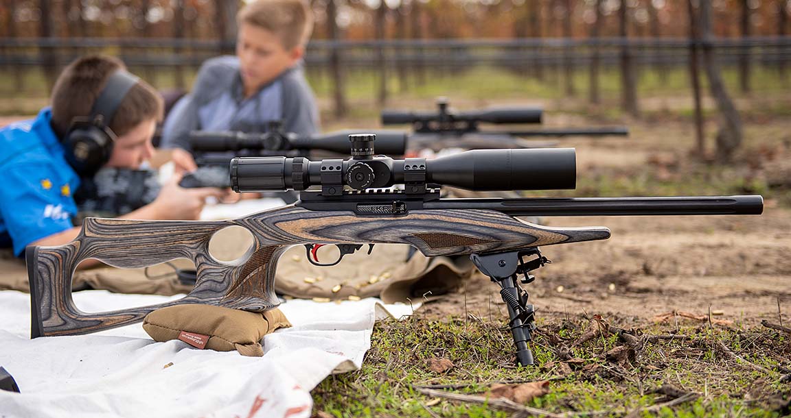

I built two identical rifles 8 years ago for my nephews who were 9 and 11 at the time. Started with a bare receiver, green mountain barrel, JWH bolt and charging handle, stock trigger that was cleaned up with a aftermarket shoe, I think the stock was a raptor, with the rings, scope, and bipod as in the photo, I had just over $800 in each of them. Easy enough to do it now without glass. And I've gotten more picky about glass as my B14r has an Athlon Cronus on it. :) Test target is 5 rounds of CCI SV at 25 yards after zeroing the scope so about 10 rounds total down the barrel. Made my own second hold down point using a brass screw that indexes with the cleaning hole at the back of the receiver, rock solid. The JWH bolts have their initials on them.
That’s a badass build! What kind of stock is that?
I think it was called a raptor, it's on ebay as a volquartsen magnum these days. For the cost now I'd get a titan, they also index with the trigger group to act as a second anchor to lock the action into the stock.
Here's a link to the stock on ebay, https://www.ebay.com/itm/144285463940?hash=item2198157584:g:wA8AAOSwzzZhir~v
If you do a search on eBay you'll find lots of stocks in cool styles and colors.
Here's a link to the JWH bolts, with handles , https://www.jwhcustom.com/product-category/cnc-bolt-kits/
