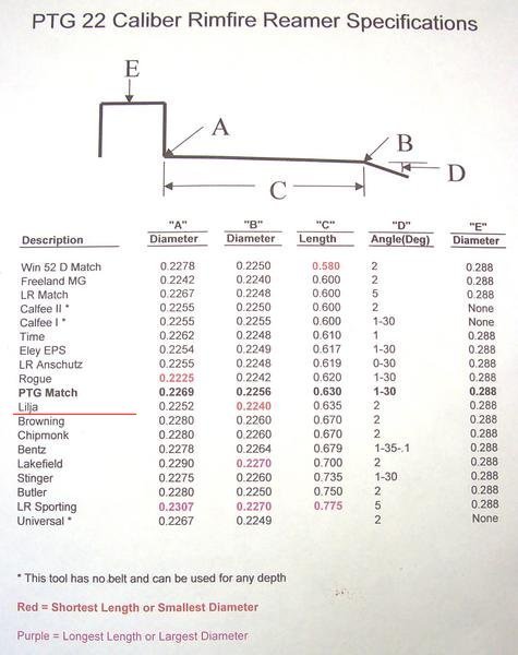

22 semi chambers are different than bolt chambers. 22minimag are working because the proj is smaller to accommodate more powder / velo.
Someone said try different ammo, which does help (like 32 or 36gr) but realistically you need your chamber lickes out with a correct reamer.
BENTZ chamber is not bad.

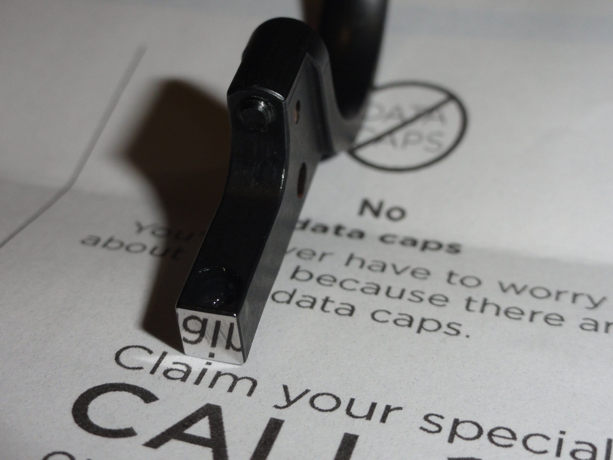

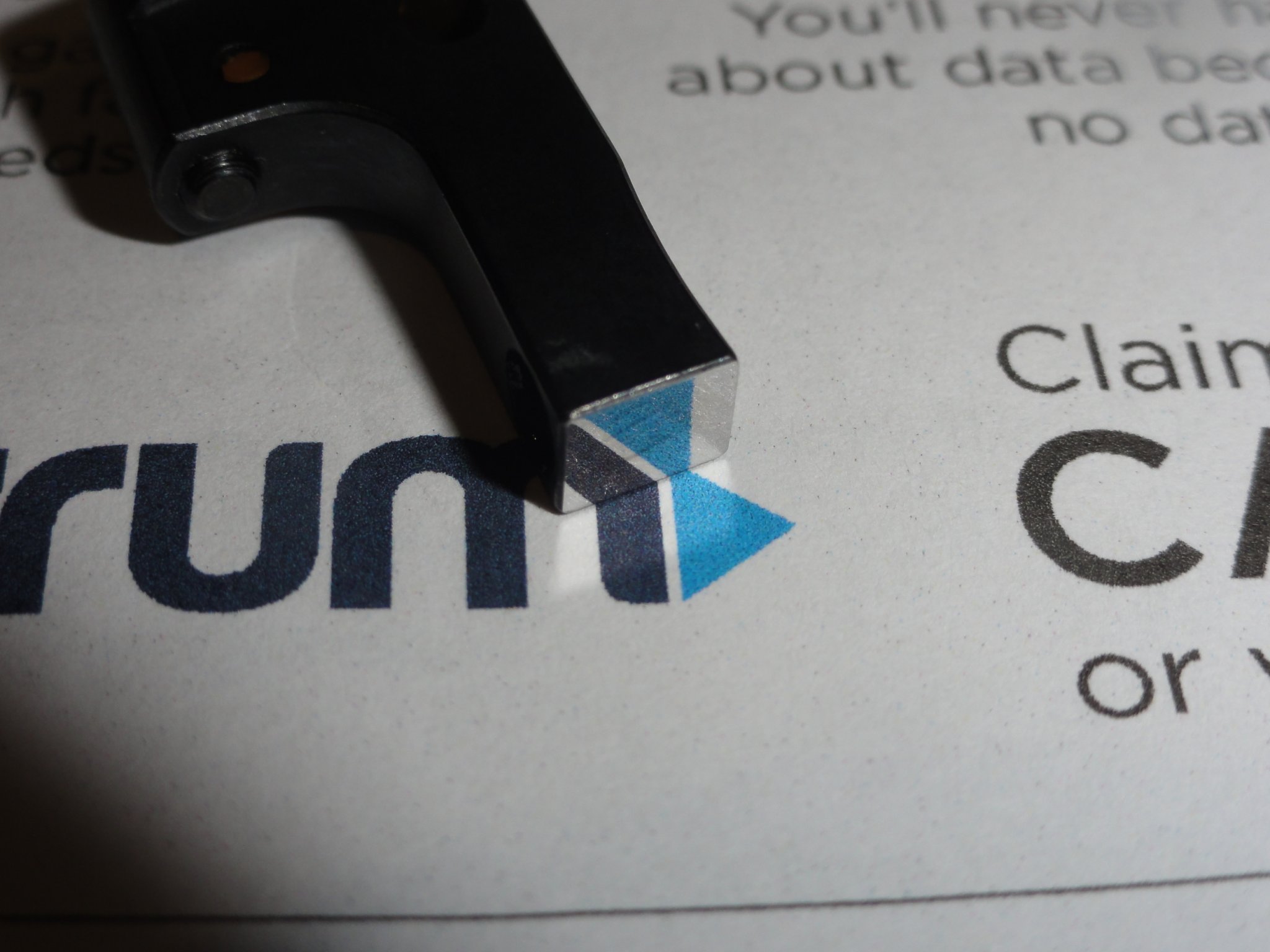

My first reason to reduced the magazine spring rate is for better cartridge release. If you look at and feel the metal feed lip area, you will notice that it is semi coarse. I'm not positive but my guess is that it is manufactured using the MIM process. Regardless of process, the feed lips have a surface finish about like 600 grit wet/dry paper and your bullet casing that is likely 1/4 hard cartridge brass is pushed against that surface by the internal magazine spring. I would like to point out that many of my other magazines have much lighter springs and also have feed lips that are much smoother. They also have a much smaller contact area that touches the cartridge.
Since you have 20 of them and you can work on them, please find one that still has the factory spring tension and reduce the tension of one of them to just over 1/2. Load them both and feel and see how they react. Pay particular attention to the manual unloading of the factory mag.
Notice how draggy and stop and go the cartridge exits the factory mag. It is my assertion that the rough surface finish coupled with the factory spring rate is not ideal. The magazine with the reduced spring rate will load and unload like butter. I saw no simple way to polish the feed lip area so the spring was the next on my list of things to try.
I believe that If I suggested that people could improve the trigger pull of their gun buy polishing the sear and reducing the trigger spring rate, nobody would dispute that point.
So what does anybody have to loose by trying out this idea? They can always put it back the way it was.
It is just my opinion in any case. Nobody has to abide by it or even try it. From your tone, why does it sound like you are apposed to it and have already dismissed it? That sounds just a little short sighted.
Shawn
