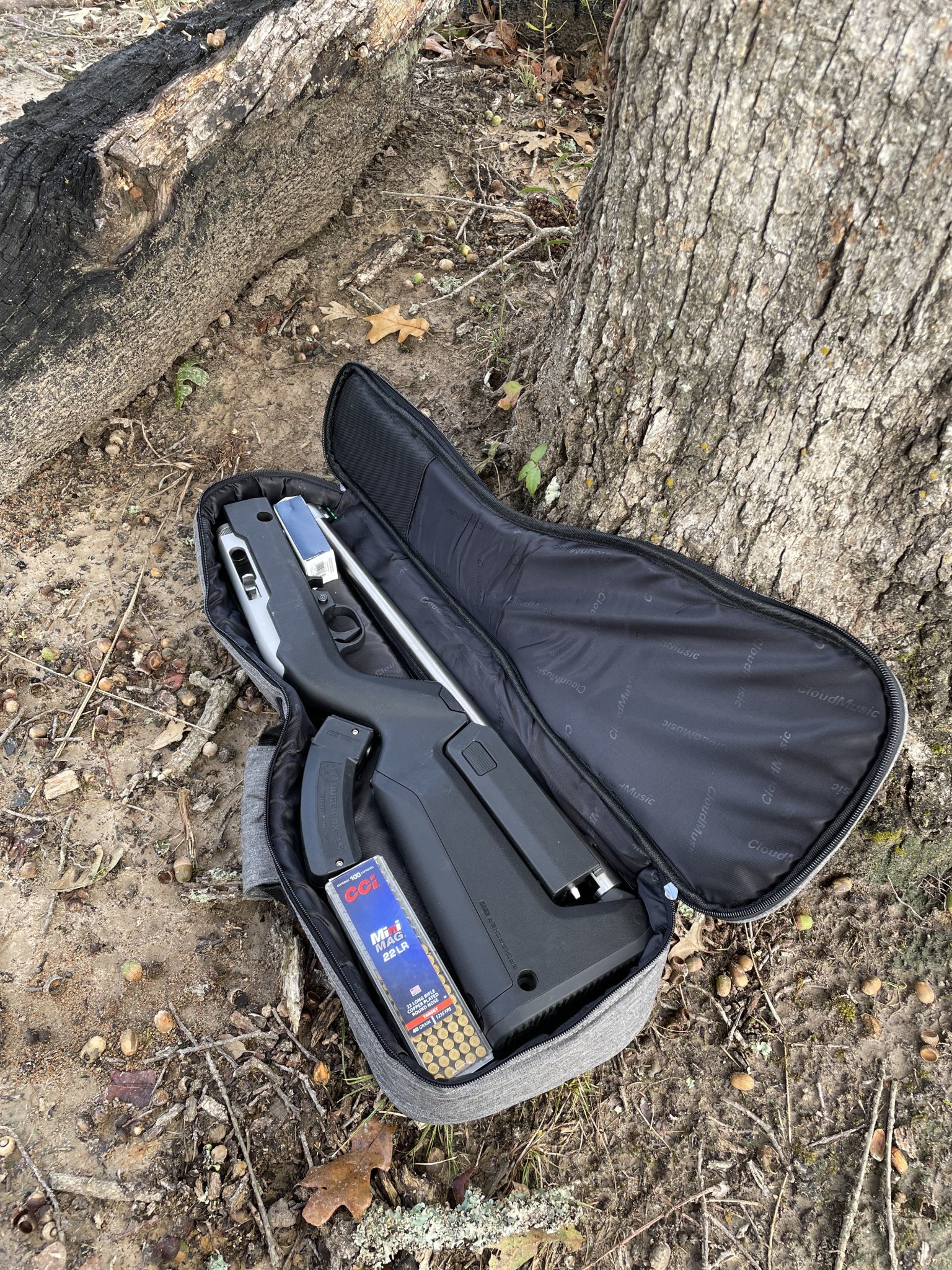

I sent a couple of triggers to the fine folks at Brimstone for their Tier 2 trigger work for my TD’s. Not as good as a $300 Kidd trigger but a worthy improvement at about a third of the cost and perfect given my accuracy expectations for a TD. The auto bolt release mod is also included in their trigger package. Take the savings and apply it towards a tax stamp.
If your rockin’ the Magpul backpacker furniture get ya an inexpensive ukulele case off Amazon - wearing iron sights it’s a perfect fit

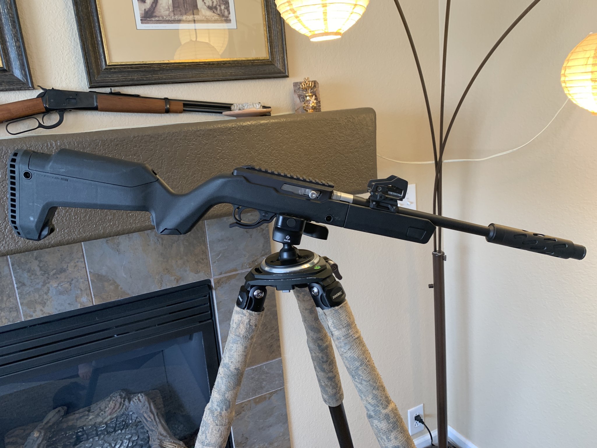

That Backpacker stock is pretty cool and I love the ukulele case. I went with the Magpul Hunter X22 stock for my TD. Installed a DIY nylon bolt buffer, there are plenty of how to's on the web. For the trigger I went with a Hornet Custom Black Max upgrade. Just couldn't justify the really expensive options for the purposes I have a 10/22 TD for. The Hornet made a big difference though. It's a fun rifle all around and the takedown feature fits well with your stated purposes. Mine does like CCI ammunition and for my home range I usually feed it Quiet-22 Semi-Auto. No suppressors allowed in my state so the reduced charge of those rounds helps keep the noise down for the neighbors.
View attachment 7756915View attachment 7756916
Oh, snap! That is slick.

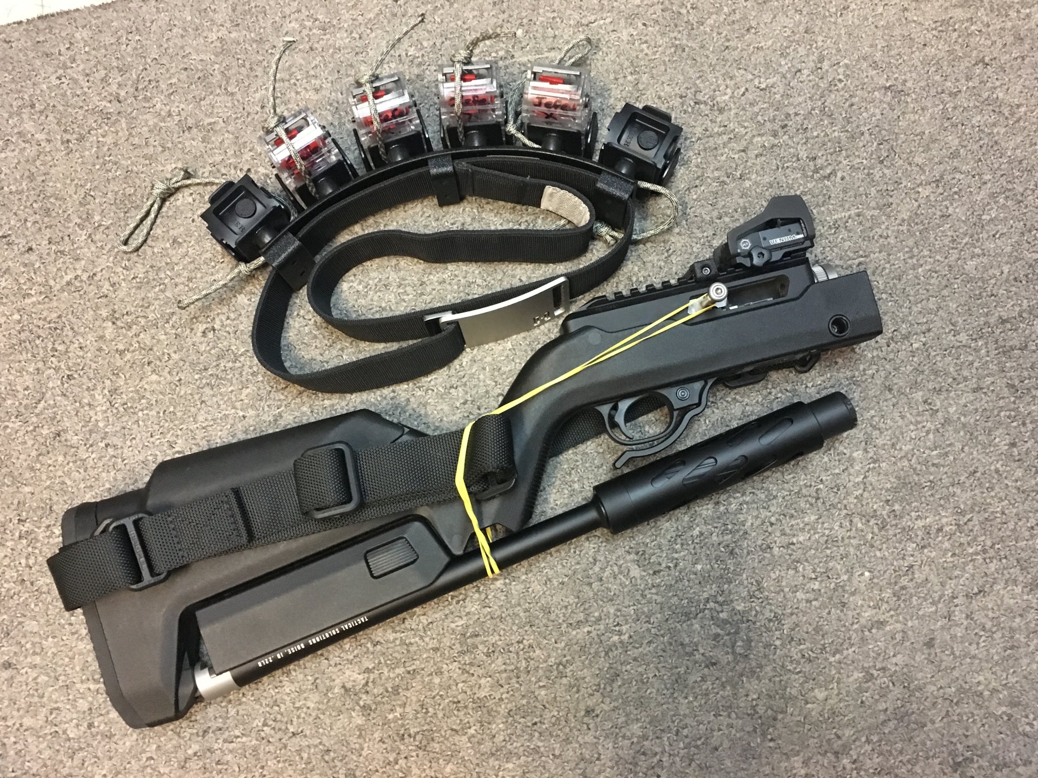

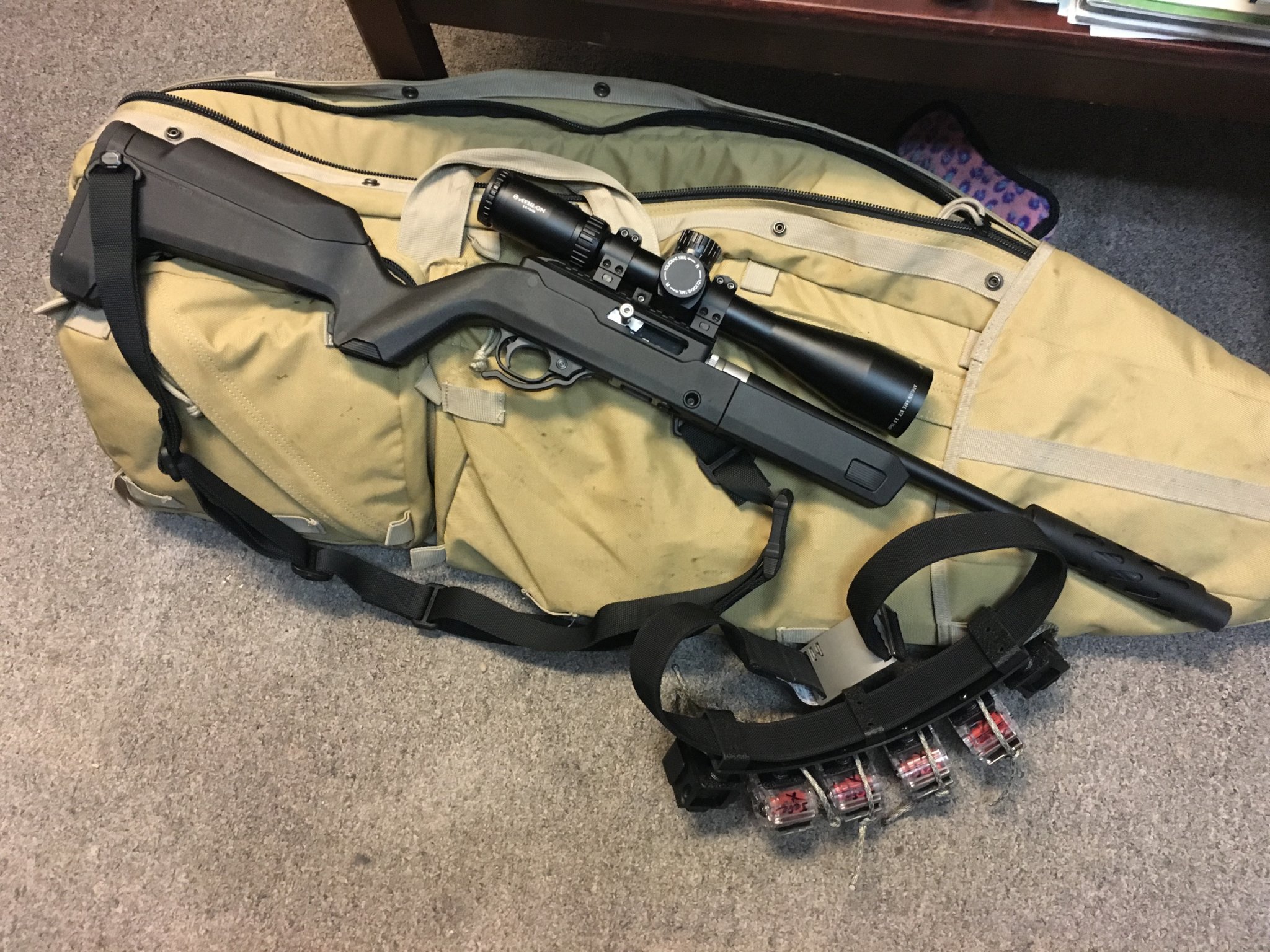

I sent my front half to Thompson Machine for an Operative build. And a bolt buffer to quiet the action noise.

So interesting how each mass produced item can have its own idiosyncrasies. My takedown didn't like free floating the barrel at all. Put the little Magpul shim back in and tightened it a bit up against the bottom of the barrel, and my groups tightened right up. It also sports a 3-9x scope on the receiver and I find it holds zero very well after taking it down and backpacking it.

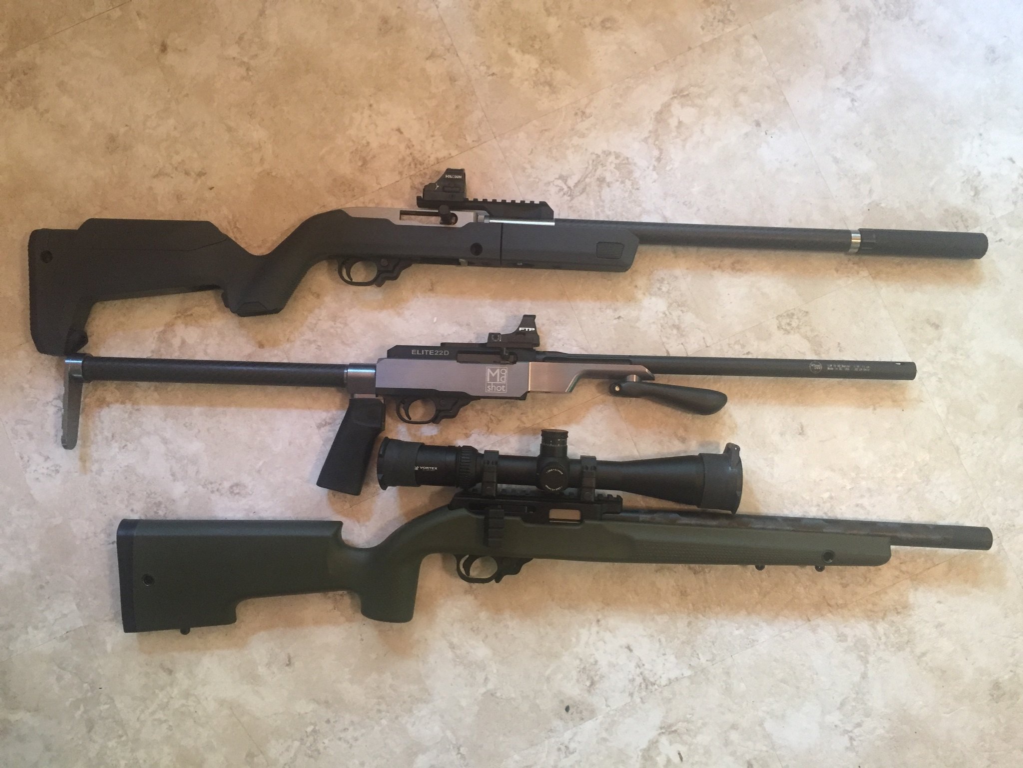

Although not as accurate as some of my other rimfires, my 10/22 TD is just so fun and convenient.View attachment 7756261
Really like that cantilever mount.
Can you get the stock to pack down with the rail in place?
Brimstone does a really nice job
