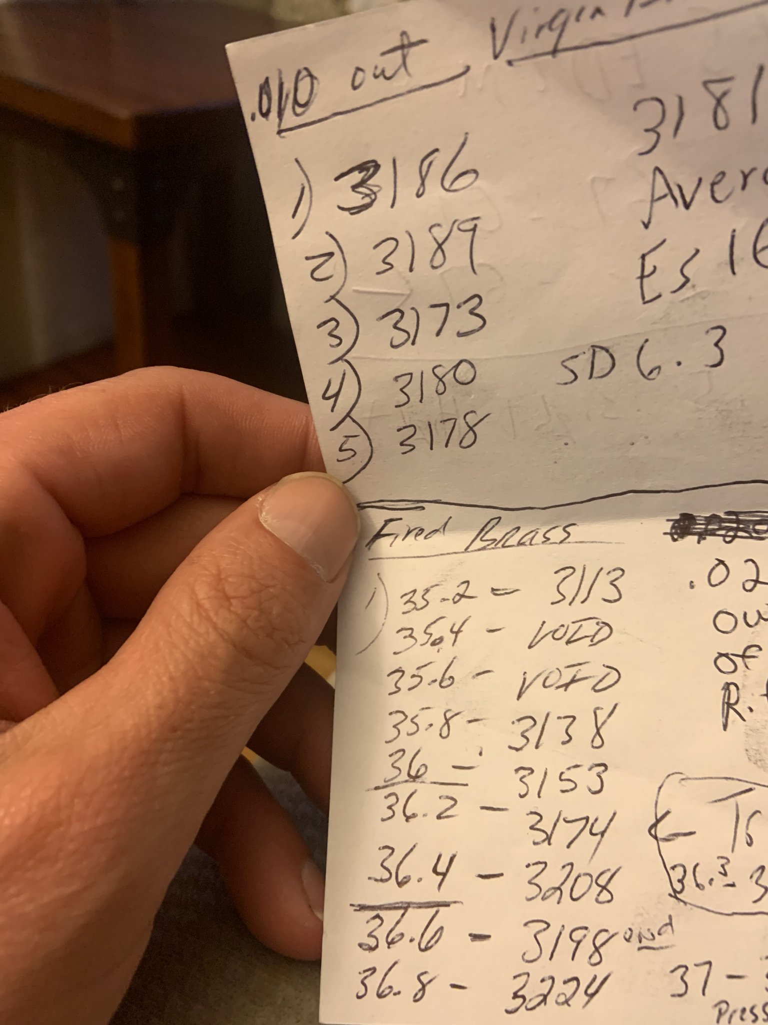

Ok, this is my first time messing with this method. I got some great numbers with virgin brass like 1fps apart in the nodes. Now fired brass I ran this test again and now I’m scratching my head on the numbers on the fired brass.
I guess I’m looking for some input from any ones experience with this method. Looks like I have a few charges I can play with but I’ll probably do a Ocw the LabRadar didn’t pick up 35.4-35.6
3-4 shot groups (x2) at 36.3, 36.4 and 36.5. I do 2 sets just in case one shines or it is not picked up on chrono. Best group, SD/ES wins.
