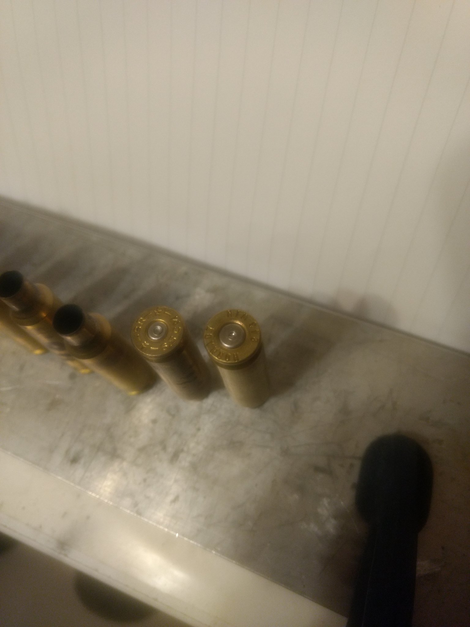

What primers are you using? I just shot my howa 1500 in 308 today. Was pushing 178gr eld match bullets 2712 FPS. Probably 100 down the tube today with no primer issues at all. I use CCI large primers for mine. Havent messed with a small primer case yet

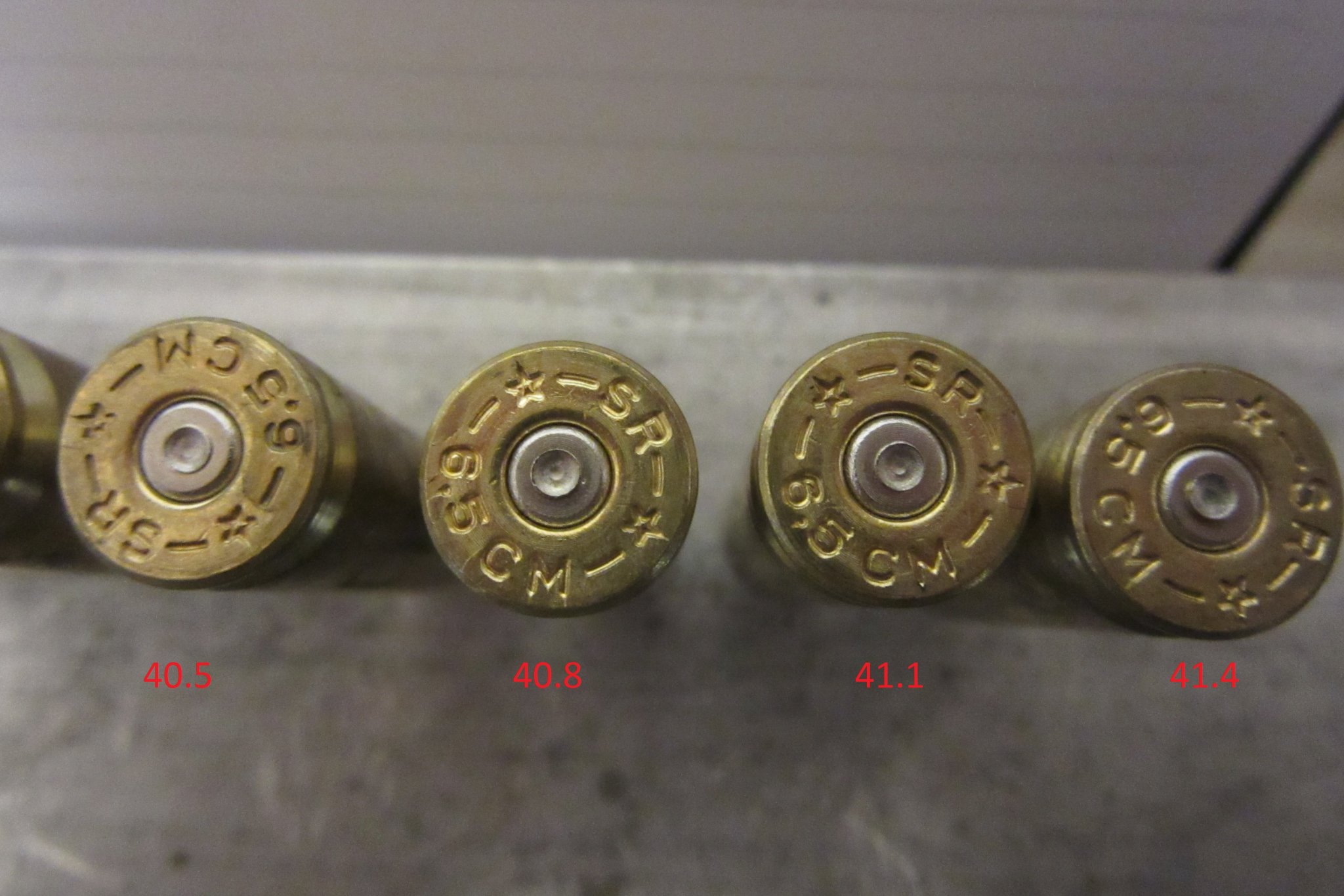

I guess I meant the primers cratering that much. Does that not mean too much pressure? I didn't feel any heavier then normal bolt lift.

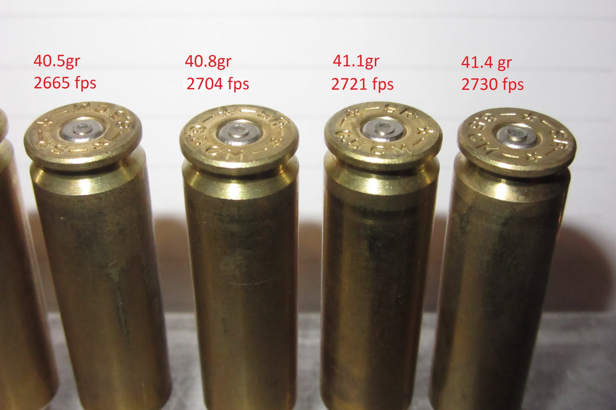

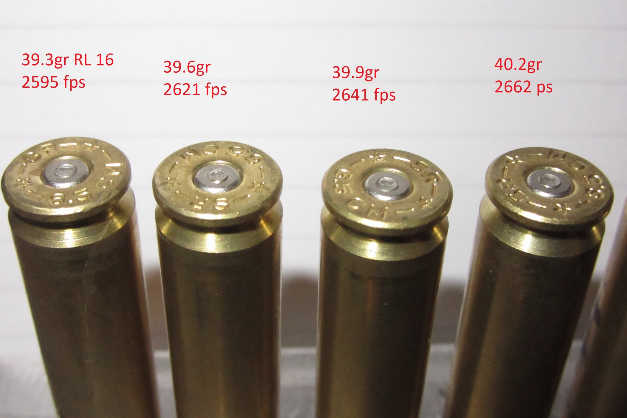

Primers can indicate pressure but they can also imitate pressure. Looks to me like the firing pin hole needs bushing. If that’s the only sign you were seeing I seriously doubt your pressure is way up. It does look like you were close to piercing a primer or two though.
So should I load some at 40.3 and see how they group and check sd's? Should I try different coal? I picked 2.84 to fit the magpul mag..during the fire forming and break in I was running 42g at 2750 fps..it was cratering primers but way not as much as this(but temps were freezing)..I played with coal...010 and .02 off the lands but it didn't make a difference in primer cratering so I went back to 2.84.

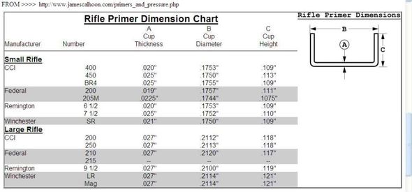

Aren't br4s just 400s weight sorted? I know the 450s have thicker material and considered using them but assumed it'd be easier getting single digit sd's with non magnum primers.

The primers can not tell you that. The eld primers are most likely cratering because of the physical structure of the bolt face/firing pin hole/firing pin; not from overpressure. Have the firing pin hole bushed so there is no void for the primer to flow into.
With zero heavy bolt lift and zero ejector marks I would not conclude that there is overpressure.
I would say that magnum primers will give you MORE consistency. Bigger flash= more consistent ignition. I use 450s in everything that is SRP.
No. BR4's have a thicker cup like the 450s, .025" thick vice .025" for the 400s. The cup is also slightly taller on a 450, and slightly (.0002") larger in diameter for the BR4s. For primer dimension reference.
As far as primer affecting SD/ES - that depends on the powder ignition, which can change with case capacity and temperature. Anecdotally, I saw no differences in accuracy or SD when loading like charges of 223 with cci 400s or BR4s.

39.6 looks like it has a an extractor imprint and an ejector wipe on 40.5. Comments (which I agree with) about the pin aside, make sure your chamber and rounds are free of all lube/oil.
Your correct...two of the eight have a faint ejector mark.
I lubed with lanolin/alcohol..sprayed while they were standing in loading block..I tried to keep it low but a small amount might have gotten in necks? I wiped the outside..but did nothing to the inside.
I seemed like an unusual amount of force required to seat the bullets with Forster bench rest seater. Although I did check several times and I only had .0015 neck tension on average.
Thoughts?
