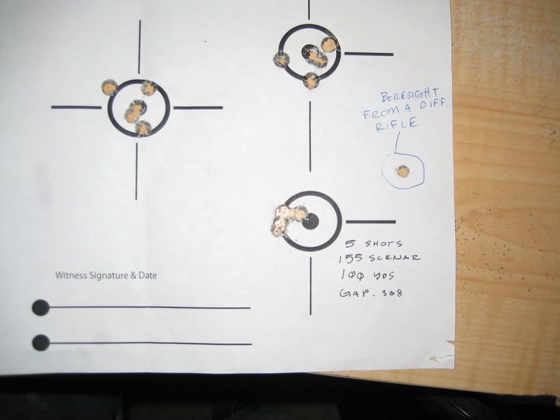

I can't speak for the center or top group but when I shot that bottom right group it wasn't to shabby :p
