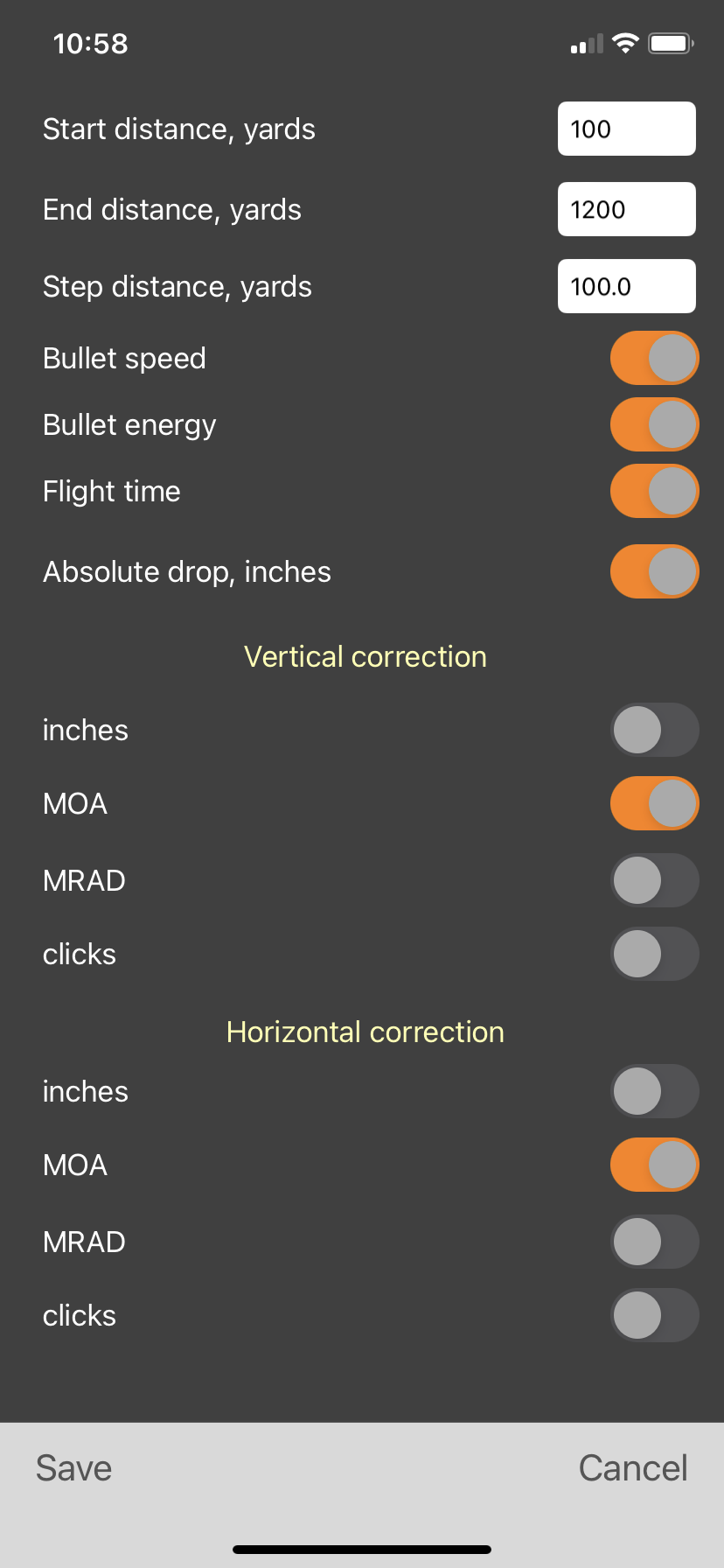

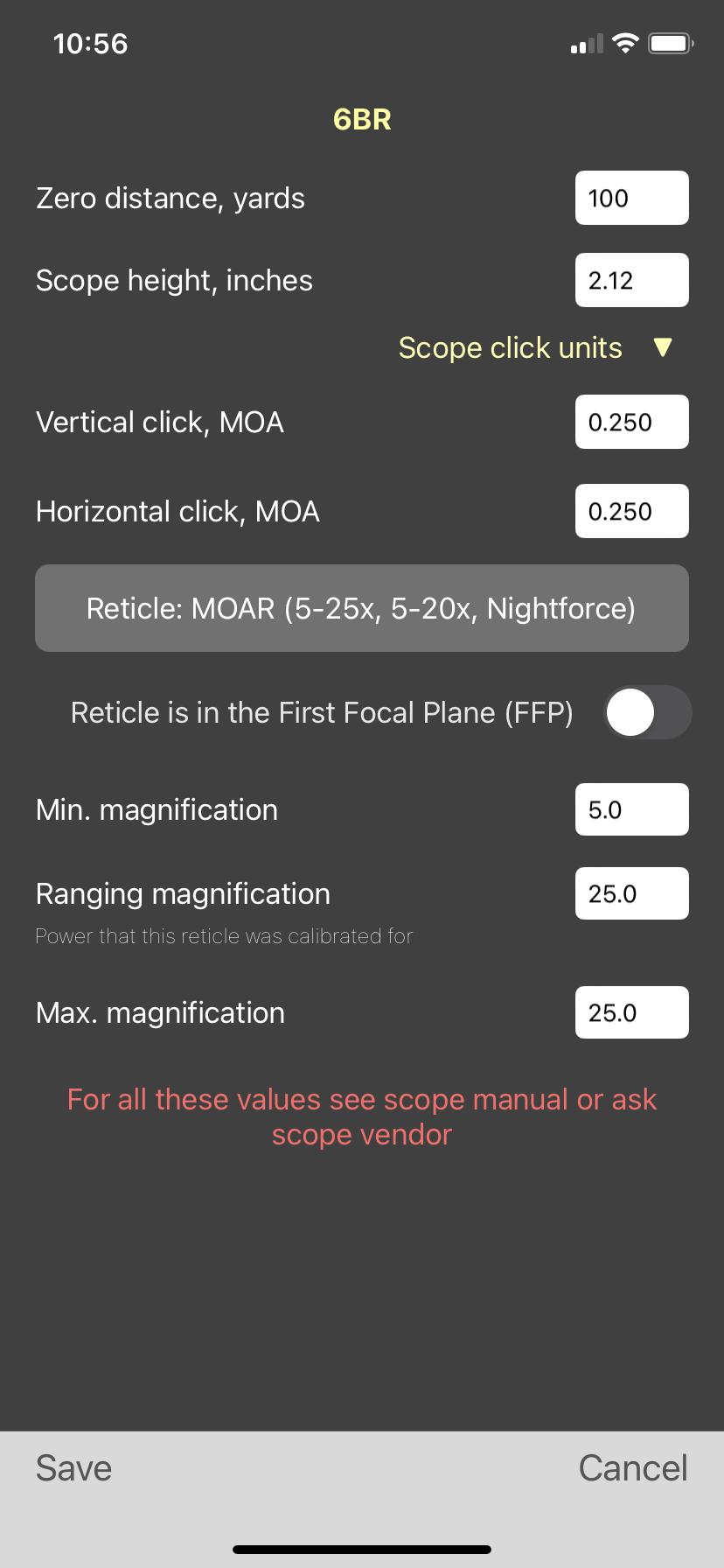

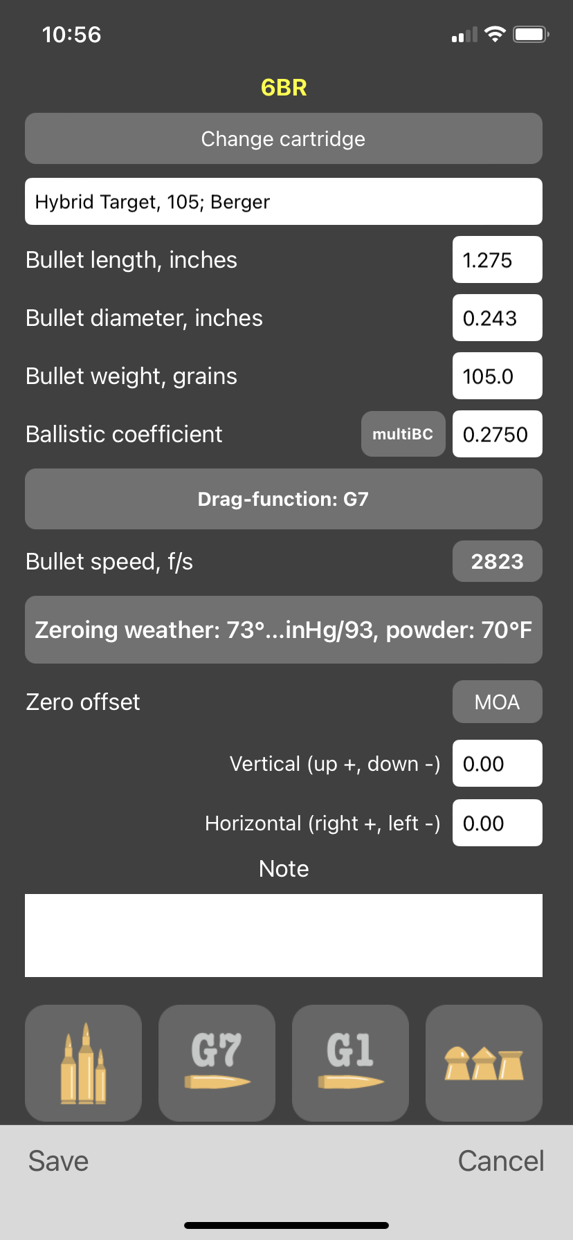

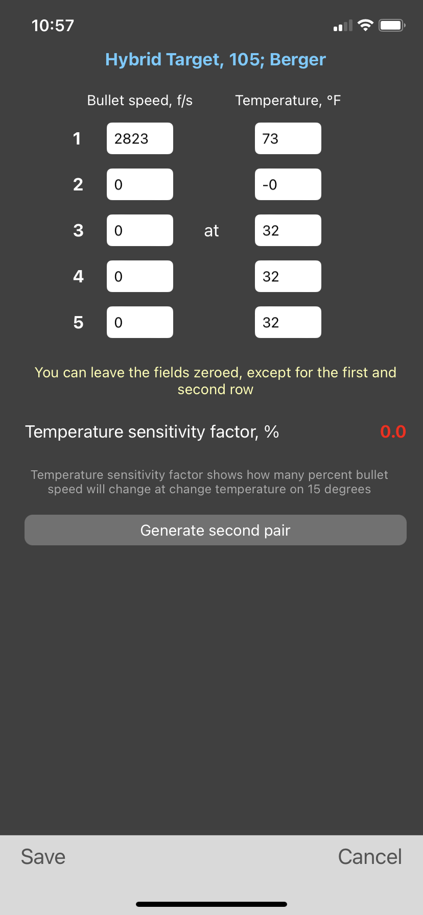

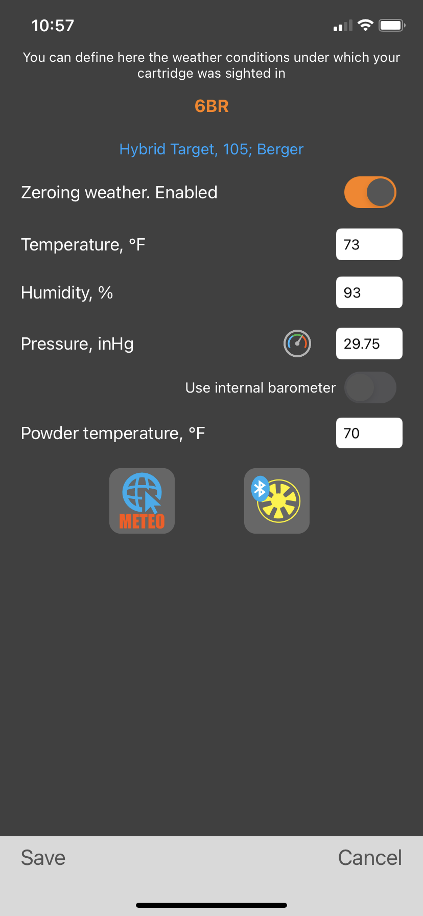

Scope height - 2.12
Velocity - 2825 fps
Firing direction to the East with 20 mph southeast wind
Location is south Texas - 33' elevation
Temp - 85 degrees / humidity 65%
As for atmospherics, please define for me if above is not enough. I sent some images. Thanks

Checked as well, its 16 MOA on Berger website and yes there was mirage. Wind was from 3 o clock about 20 mph
