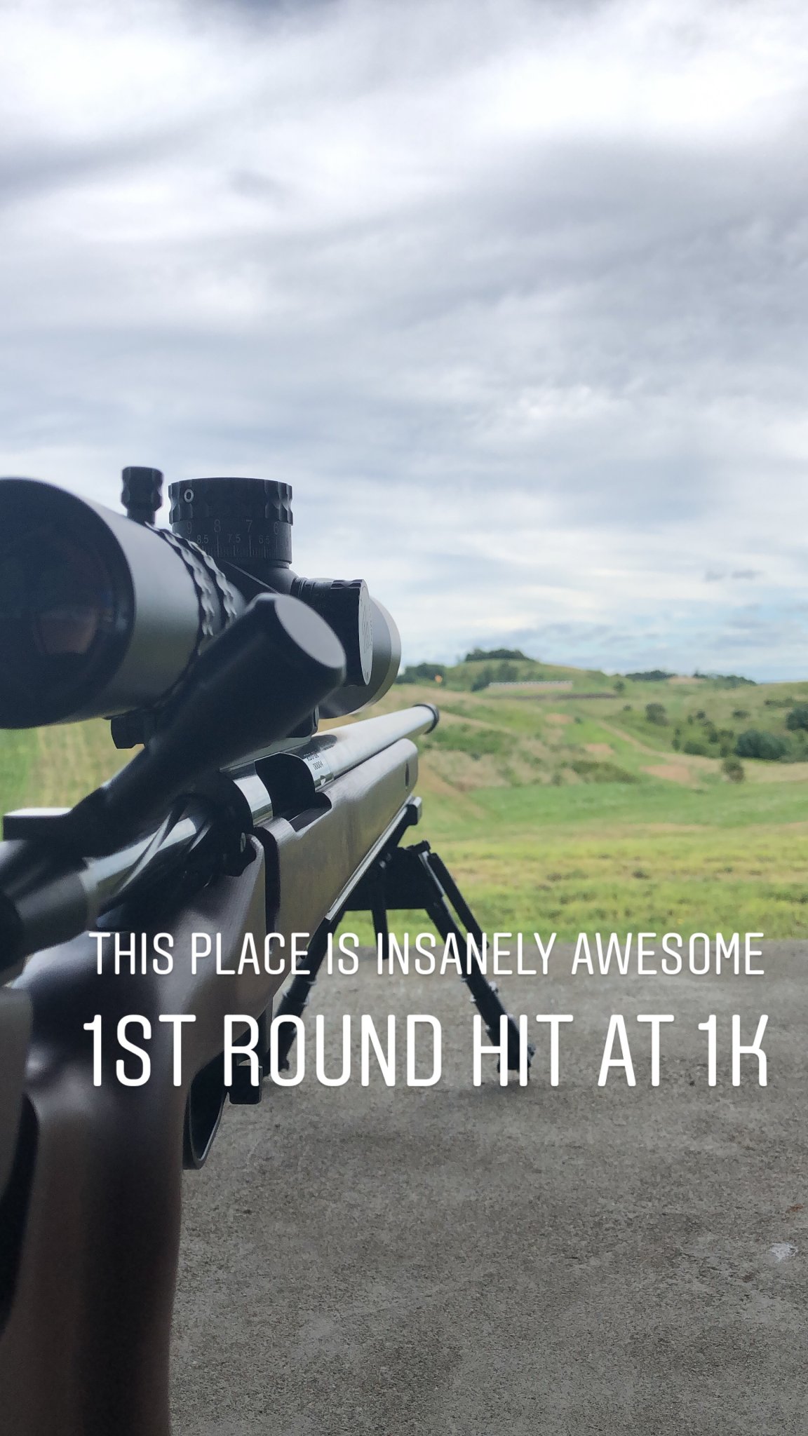

I shot big dog steel this weekend our at thunder valley precision. I arrived on Friday to check in and decided to check dope and participate in the king of the mile side match, since the facility was so cool and I’d never shot at a mile.
I’m shooting a 6 dasher at 2935fps. Using the AB custom curve in my kestrel.
I sit down and take a shot at 1000 yards, I am a half mil high. I’ve never seemed to have elevation issues before. I write it off as maybe a strange up draft, as my drop for my kestrel at 700 yards is spot on. Though shooters next to me are not experiencing the same issues.
Head over to the mile shoot, take my first shot, 2 mils high. Wow. What is going on?
I dive into my kestrel and verify all of my parameters and double check my speed over the magneto.
Out of curriousity, I change from the custom curve to a g7 BC, and turn it up until my mile dope lines up with what I observed. Which gives a g7 of .304
I head back to the 1000 yard target and try the dope that the .304 g7 gives, and it’s spot on, good center hit.
Anybody have an idea of what might be going on?

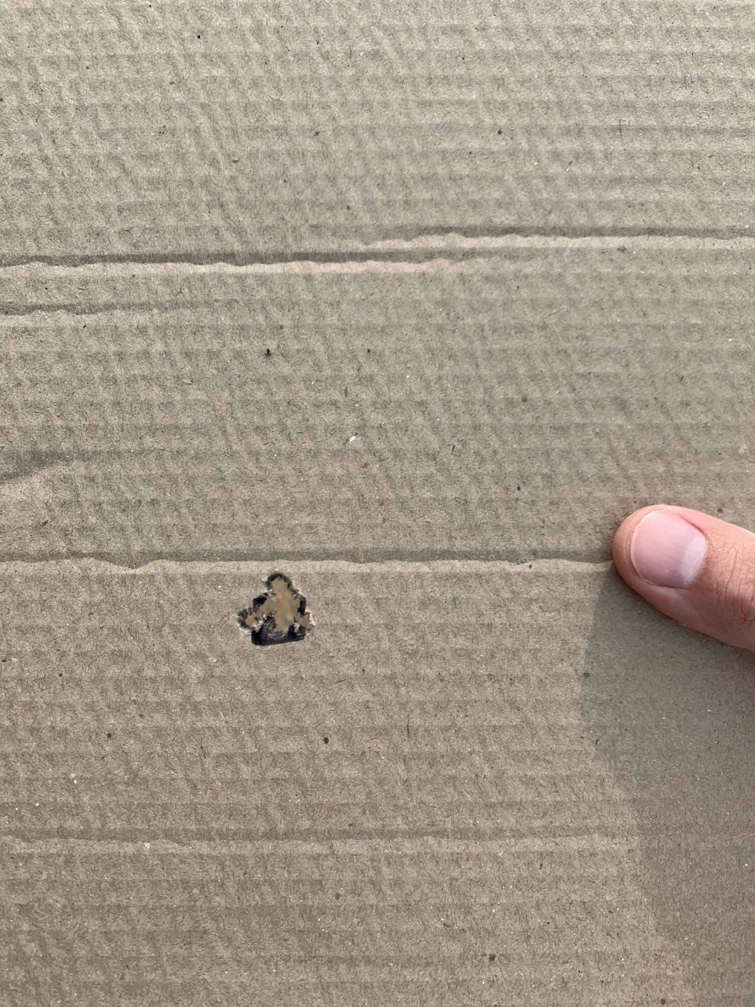

10 shot zero group from the day before is attached. D82A032A-F264-453C-85B1-4040D6CE1660.jpeg
Ya,
That is fine, but doesn't show the POA, off a bench depending on your recoil management you can hit high by .3 or so vs other positions.
You rock back under recoil if you are bladed and it causes the group to rise as well as it will bleed of MV
You'll shoot the same, but not in the same place

I totally get it, but, if that’s what was going on here, wouldn’t that have been present at all the other distances I shot inside 1000 from the same bench?

Got out to shoot today and hung a nice big plate at 976 yards. Checked zero, checked speed, all the same as before.
Custom curve, called for 7.4 mils. Put me .2 high on the plate
.304 G7 I used for the match 7.0 mils, put me .2 low on plate.
.286 g7 put me dead on waterline. With 7.2 mils.
