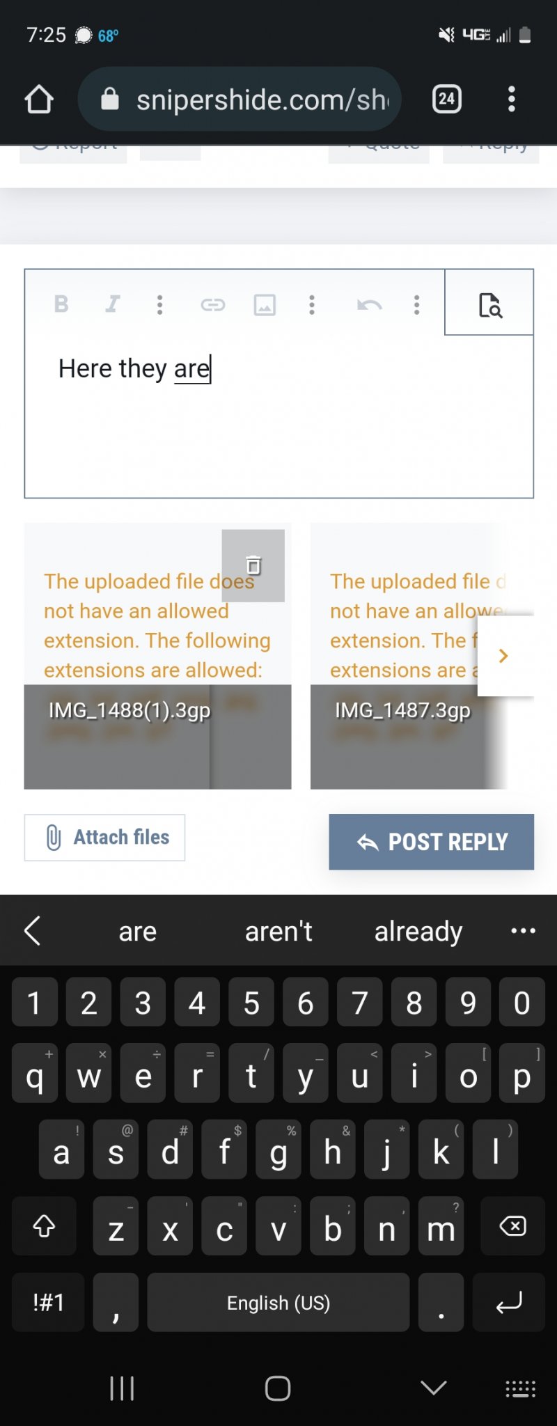

    Well. It won't even let me post them
    Reactions: 338dude
    Show a picture of the exploding 108…
    Read what I wrote again. The video quality that of the videos that he sent me are so bad that you can barely tell that the people are humans. Zooming in far enough to see anything is impossible. On his original videos on his phone you could see the credit score of the birds flying by. I'm guessing they won't let you text HD videos.
