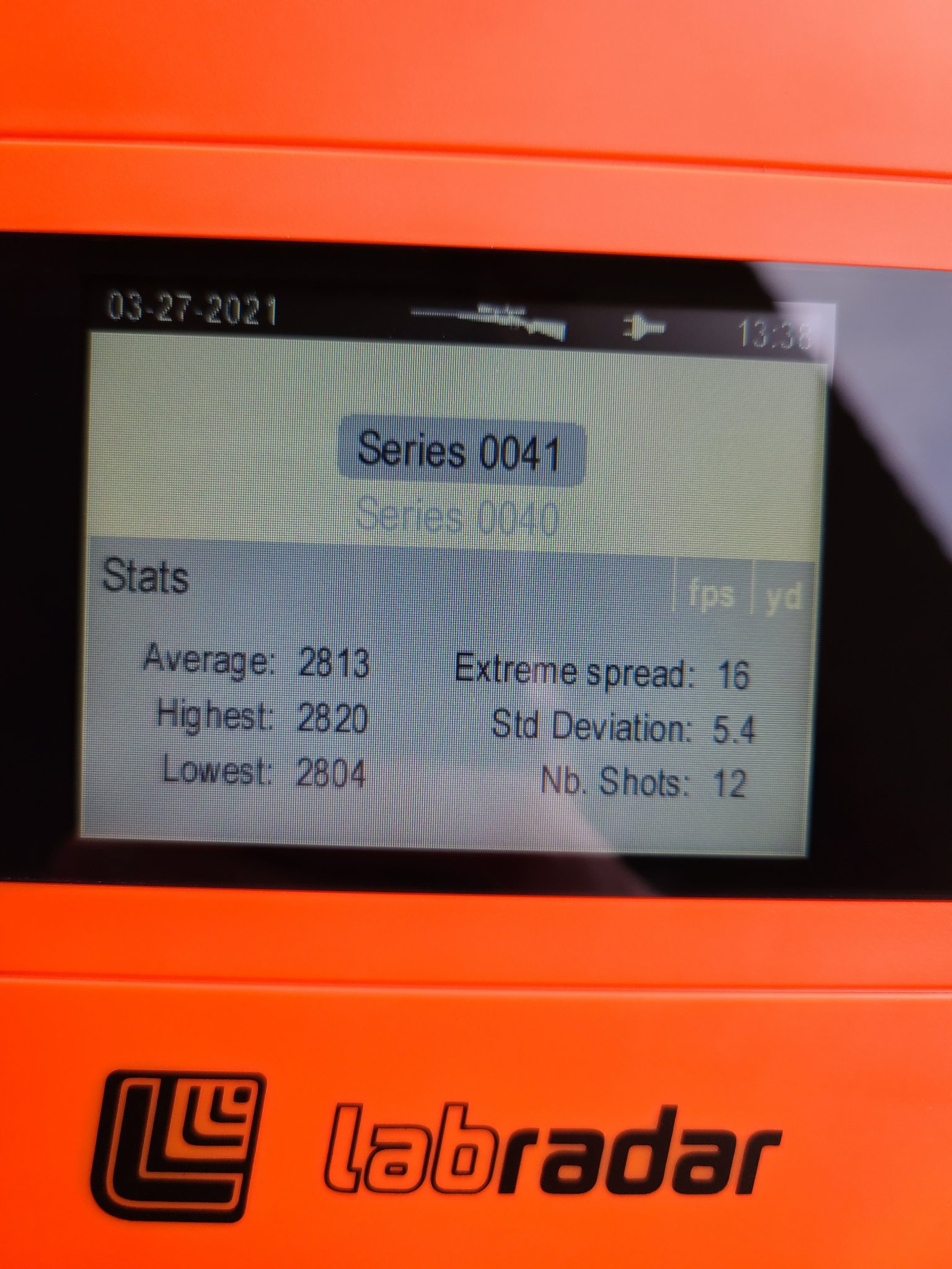

I agree it's slow. Maybe because it's new brass? Could it be because I only have 17 rounds through my barrel?

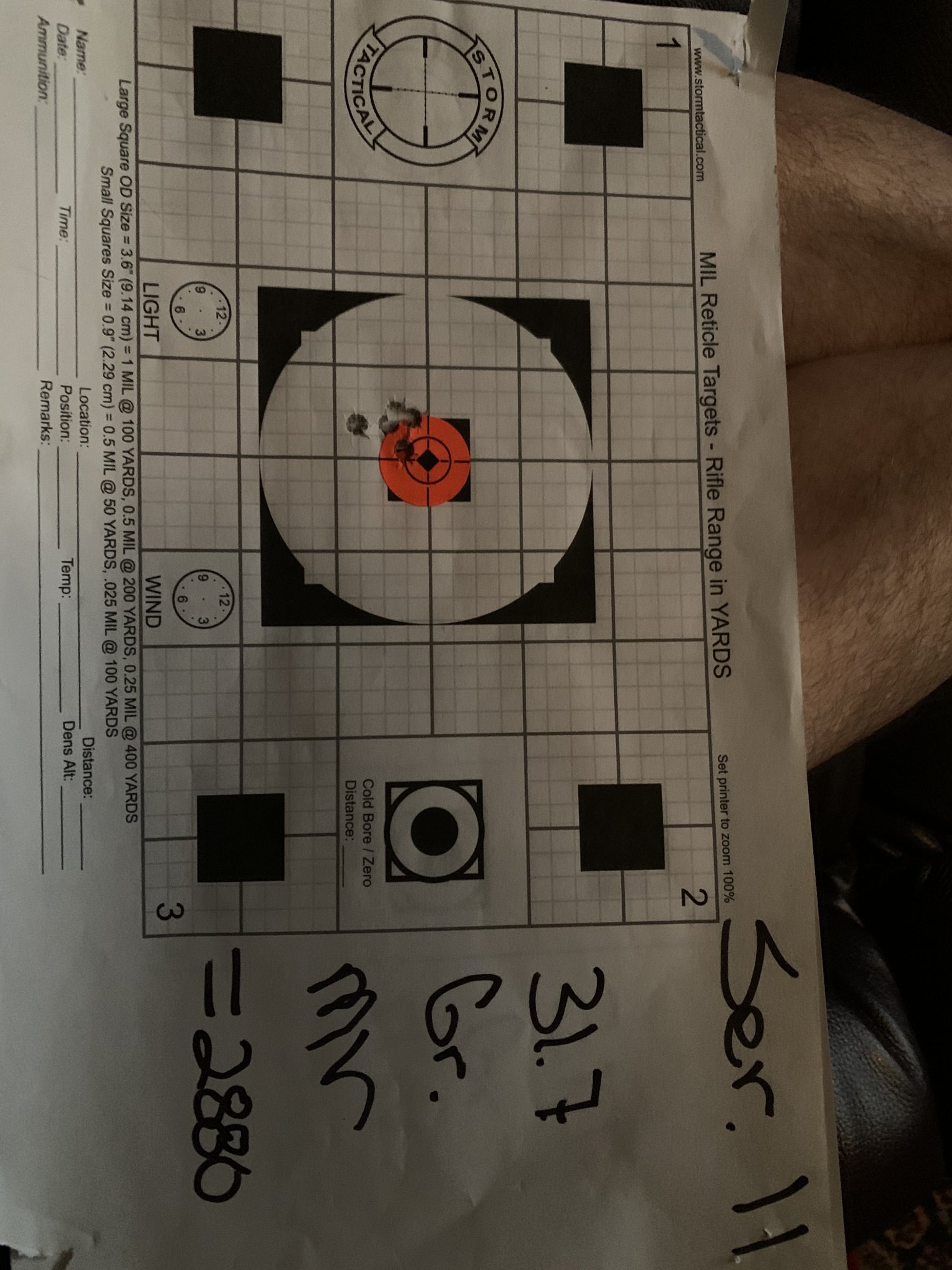

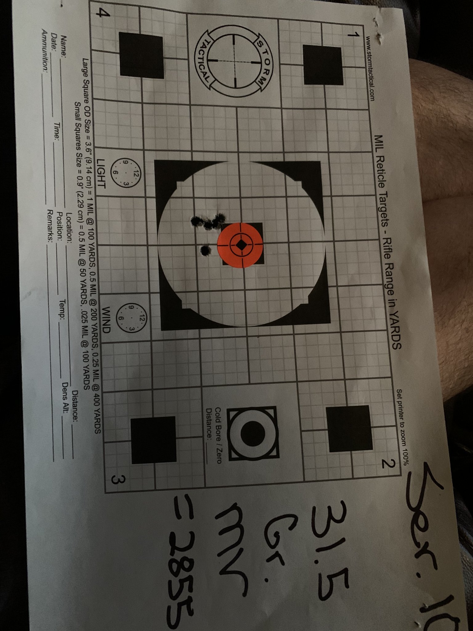

I’m getting 2880 w/ 31.7 Gr Varget and 2858 w/ 31.5 Gr. 26” w/ 110 ATips, Lapua brass and CCI 450’s... jumping .045
26” Kreiger 1-7.5
Same load with 105’s and was seeing 2915 with 31.7 Gr...

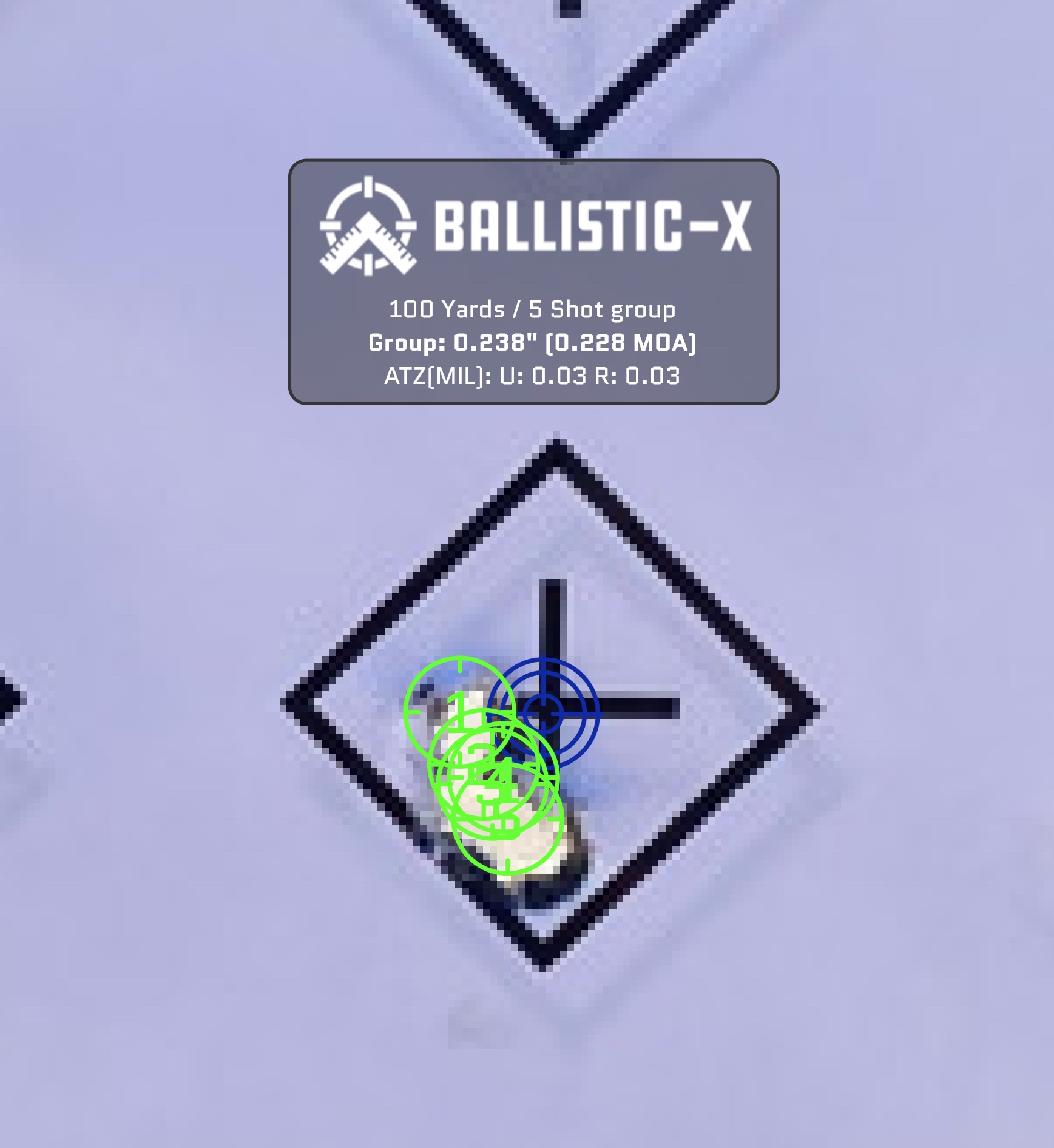

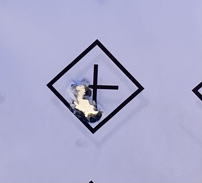

Did my ladder last week, settled on 31.7 Gr here’s 200 yard groups with the 110 Atips..
Barrel now with just over 100 rds on it..
MV verified on labradar...

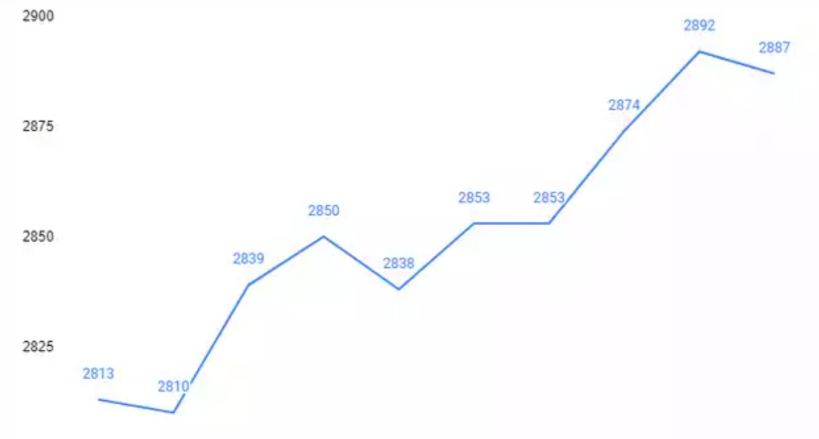

What are gavin and I doing so different that 31.8 grains are getting so much less fps? My 31.8 is getting 2813 fps. His was 2840.
https://ultimatereloader.com/2020/06/02/5-shots-one-hole-6-dasher-load-development-initial-results/

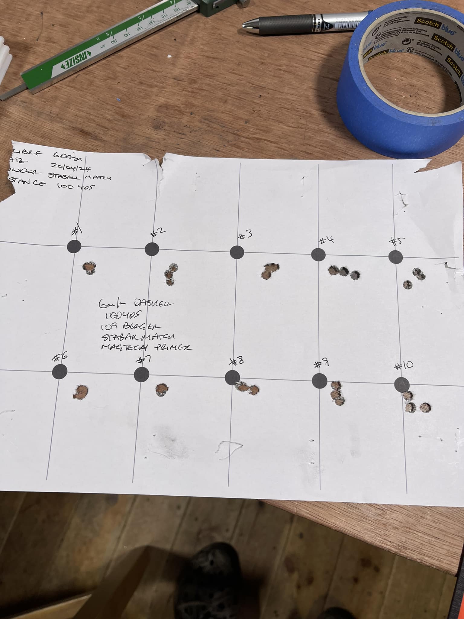

im now starting to play with the new winchester match powder and 109 bergers and after basic load dev it looks really good
