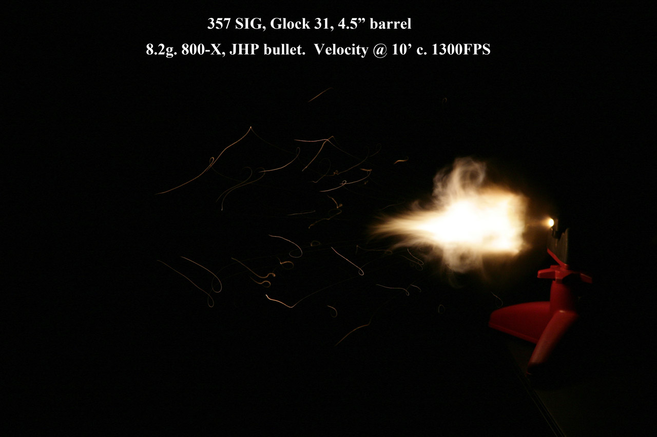

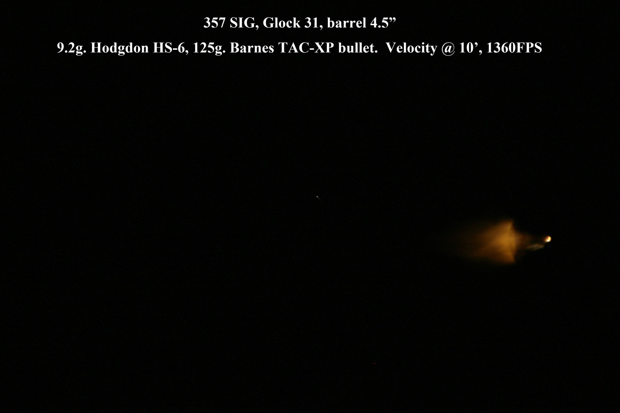

HS-6.. JUST-RIGHT burning rate, and, in contrast to 'Hi-FLASH' 800-X, it's VERY low in muzzleflash.
Pics are mine; I did a LOT of research on this.
