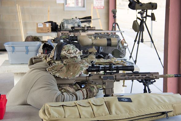

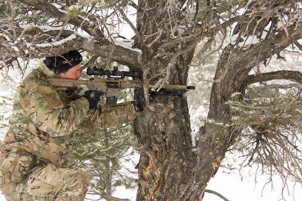

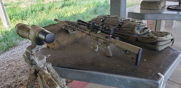

I just realized it has been 10 years since I put together the 17.6” Lilja from the first forum group buy. It’s a unique Wasp contour barrel that is really lightweight, but has been repeatedly-accurate and quite precise for such a light AR-15. It has also been boringly-reliable after many range trips, shooting courses, and load-testing sessions over these years.

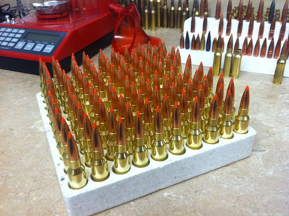

The main ammo I have fed this carbine is hand loads of 31.2gr of CFE223 under 123gr A-MAXs, as well as Hornady 123gr ELD-M factory ammo.
I basically shot this blaster from 2014-2017 almost exclusively for anything LR until I built the 12” Grendel. I shot some 16”, 22”, 20”, and 18” as well, but really focused on that 17.6 Lilja until I did the 12”, then have mainly focused on the 12”. I usually take them both though. I had been shooting a 16” Grendel prior to this since 2009.

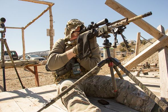

Since last year, I’ve been having my youngest son shoot it to get him trained-up and shooting steel at distance.
tempImage9ch6FO.heic
He has shot it at 300yds, 400yds, and 1000yds so far with a very high hit rate. I think he only had 1 miss at 1000yds out of 4 or 5 rounds of the new 100gr ELD-VT.
6.5 Grendel 17.6” Lilja
Lilja 17.6” Wasp contour barrel with MLGS, .076” gas port, bedded into the upper
Precision Firearms NOX Flash Hider
Maxim/Precision Firearms Grendel bolt
Standard bolt carrier (later replaced with Bootleg adjustable gas carrier)
M4 with No Forward Assist upper, Cerakote FDE by me
Midwest Industries Free Float handguard with 12 o’clock continuous rail, FDE
BCM Gunfighter Charge Handle
Old School PSA A2 forged lower, Cerakote FDE
Geissele SSA, then LaRue MBT-2S trigger
SPR or Magpul MOE+ grip
VLTOR Clubfoot or LaRue RAT stock
Carbine RET, Cerakote FDE
Carbine spring
Carbine buffer
NightForce Unimount 20 MOA
Vortex Viper PST 2.5-10x32 the whole time, still tracking, dead-on at 100 to 600yds.
Weight without bipod or magazine was 7lbs 12oz initially with the Vltor Gen I Clubfoot. It balances out better with the LaRue RAT stock, but might be slightly heavier. Feels amazing in the hands, like an older M4 with the Wasp 727 barrels pre-SOPMOD heavy pipes.
It has been just a great little lightweight carbine that shoots more like a heavy bolt gun on-target.
Things I would do differently (nit-pics):
I would use an ADM UIC Ambi billet lower receiver or cut a PDQ lever channel into the A2 before I Cerakoted it.
I maybe would have spec’d the gas system to Intermediate Length and had PF do the work on the barrel with their ILGS set-up.
I would have gone with the LaRue RAT stock out of the gate maybe with the bag rider attachment from LaRue.
I would have preferred a handguard with a small 6 o’clock section of rail for a QD bipod option so I could use my TBAC bipod on it more easily.
I would have painted the scope and mount.
Maybe texture the SPR grip and Cerakote it FDE.
I would have Cerakoted the barrel FDE.

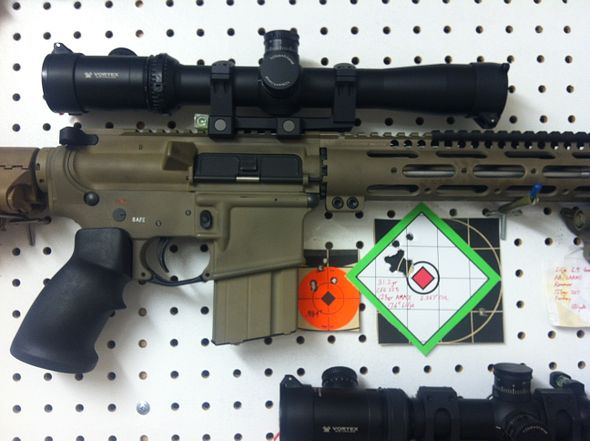

5rd and 9rd groups for the 123gr A-MAX/31.2gr CFE223 load at 100yds (before I put a Geissele in it, standard trigger):

Another thing I wanted to point out is that the only scope and mount I have ever put on it is what you see:
That scope has held zero, tracked back and forth through endless rotations for elevation changes ranging from 100-1000yds across a wide range of environmental extremes. Every time I dial it to the indicated dope from my ballistics program, I’m center-punching steel with the 123gr A-MAX and ELD-M loads. It has the old school shim zero stop in it, which has worked fine for me all these years.
It has been used in everything from hot/dry/high altitude to below-freezing, windy, and snow storms:
tempImageMxZhoV.heic
