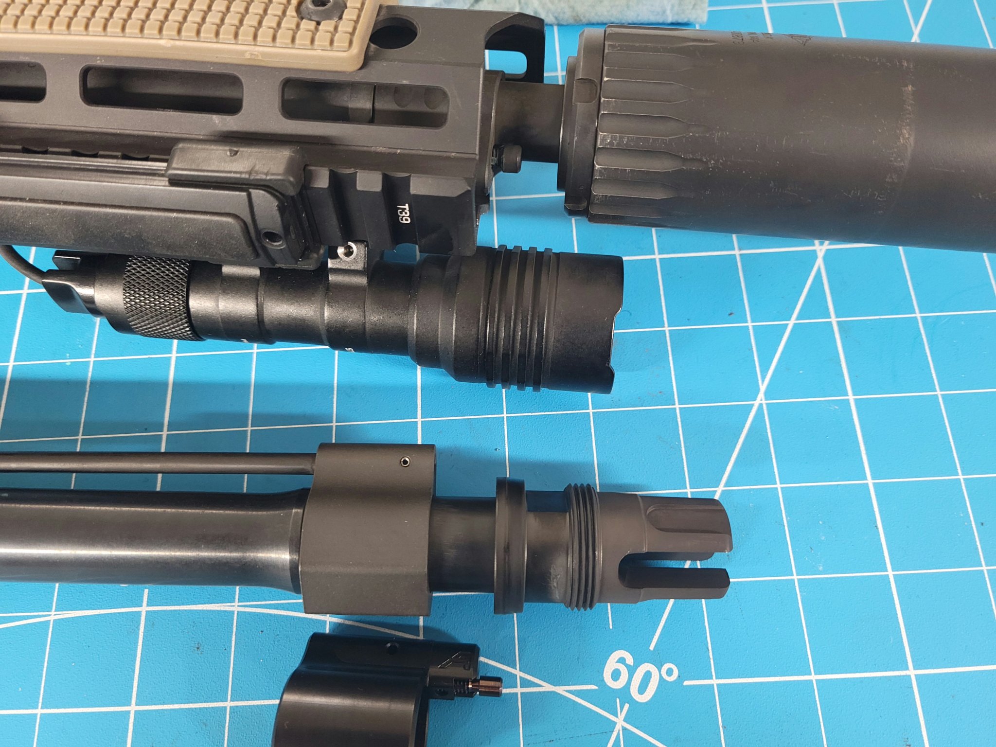

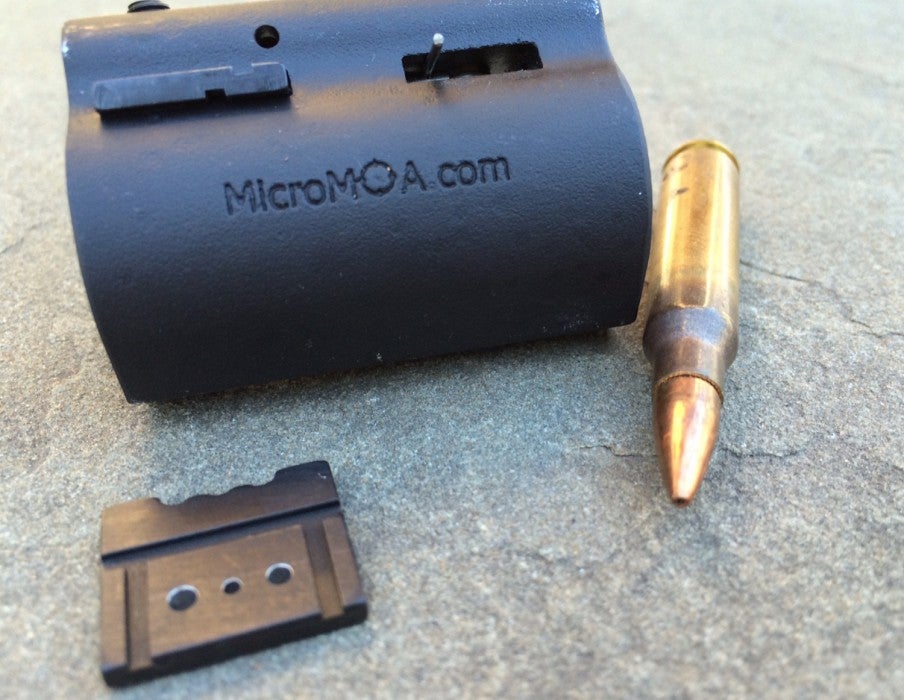

I have two 11.5" mid guns, one is new and I'm still working on the port size. Generally speaking, you can make them function without a silencer but, just like 10.5" carbine, they will be over gassed with a silencer. The old Micro MOA gas block would be good for this configuration.

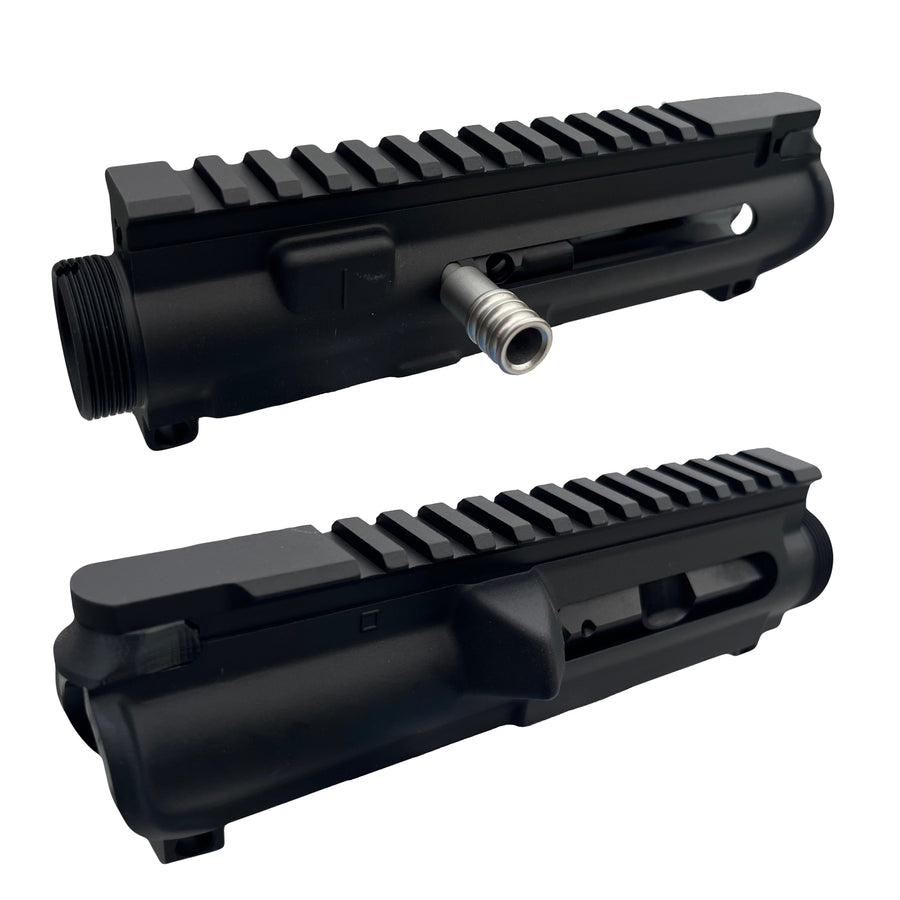

What about a Riflespeed gasblock? Easy to use though a bit expensive.
This upper is guaranteed to work with any gas system 🤣😉
The rifle speed gas block has the same shortcomings as the other needle valve blocks on the market. The old Micro MOA block was a dual port block that allowed custom port sizes and two positions for unsuppressed and suppressed. With that said, any adjustable gas block can work in this application.

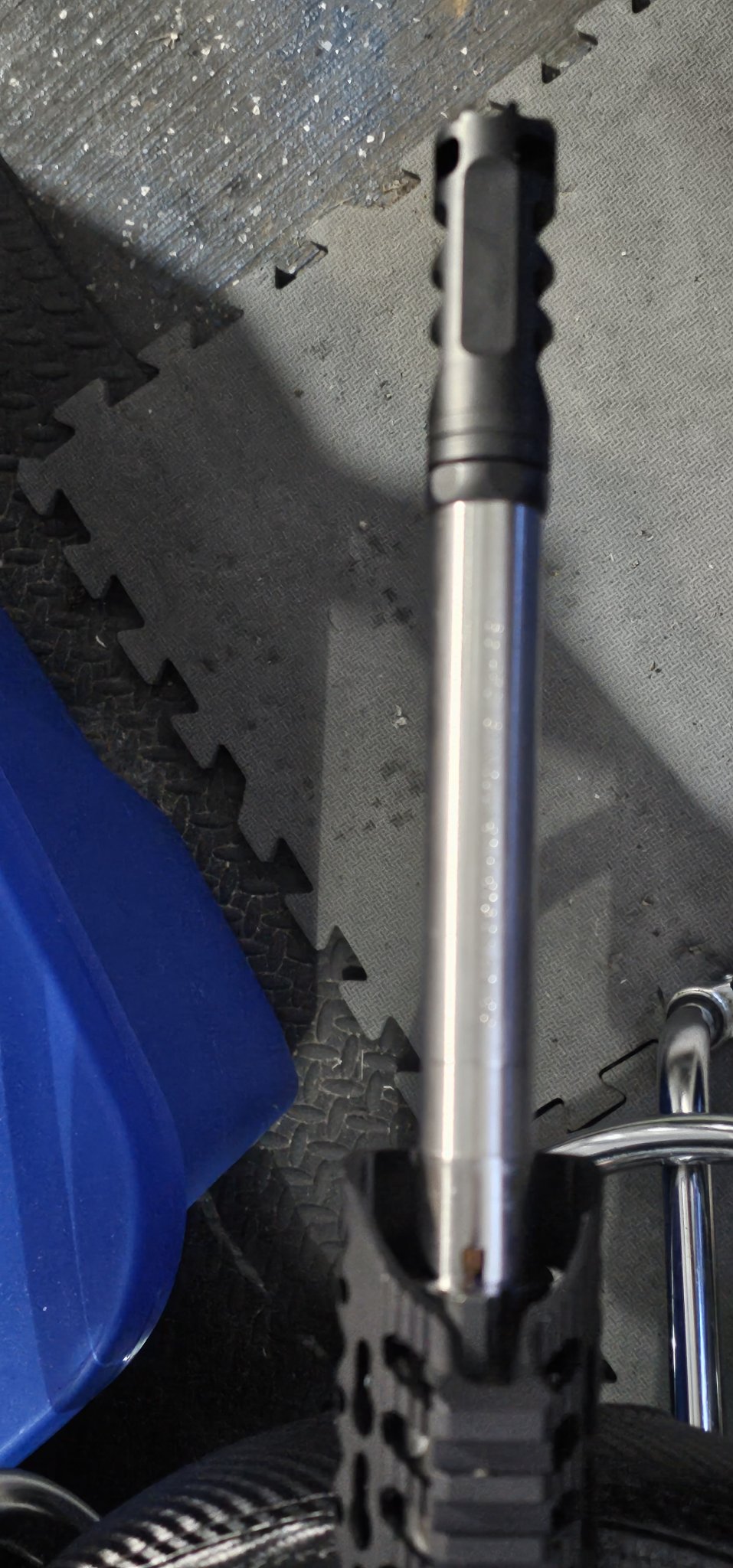

I have an 11.5" 223wylde that functions great. I'll need to check gas length. Most likely carbine as mid should be to long? The closer to the muzzle it is you reduce buffer weight and vise versa on further from. No suppressor tho. If wanting to go liter bcg then a much heavier (possibly H4) will be needed.

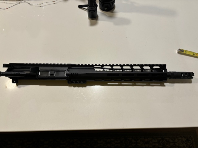

Would something like this function reliably without a suppressor ?
Again MID-Length gas on a 11.5" barrel... dwell time just to danged short ?
https://www.aimsurplus.com/products/lantac-115in-223556-complete-ar15-utp-upper-receiver
Could a LtWt BCG help function ? ... Lighter buffer spring and buffer ?
Pretty curious since I have never seen a 11.5" Mid-length gas.

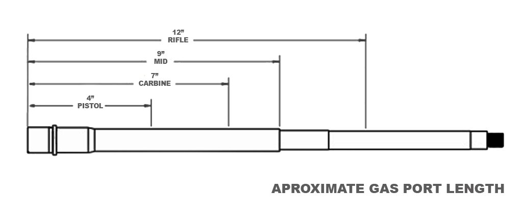

That's more like too much dwell time and not having enough barrel left for the gas. Lighter weight bullets moving faster than heavier 1's will have less time for the bcg to react. Time between port and muzzle is important for best function. Many years ago there was an semi-auto design with the port within 2" of the muzzle on a 16"+ barrel. I don't recall the type or the person who designed it? It functioned well from what I remember? Also don't recall if it was a piston or di operation?

FWIW...its my understanding, and put in simple terms, Dwell time is dependent on barrel length after the gas port.
So a carbine length gas system on a 11.5" barrel has more dwell time than the mid-length on the same 11.5" barrel.
Port pressure is measured from the chamber to the gas port.

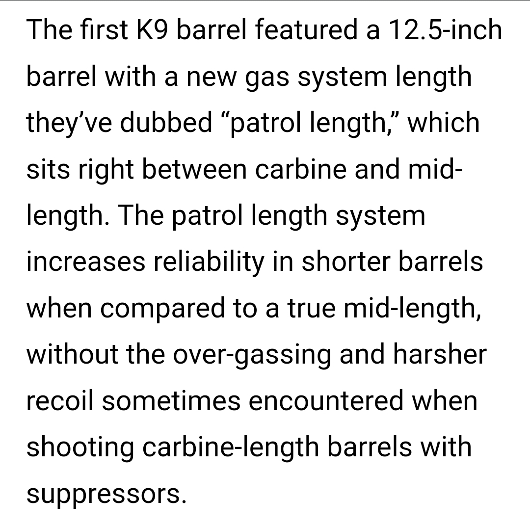

Quote... "The K9 11.5 offers a proprietary patrol length gas system that is smoother than carbine length, more reliable than mid-length. Features an optimized gas port to run reliably suppressed and/or unsuppressed."
https://www.roscomanufacturing.com/shop/barrels/k9-barrels/k9-11-5-kinetic-consulting-5-56-nato/
Now if it would state port size and location distance would be nice.
A buddy has the Roscoe 11.5 with the patrol gas system. It's not much shorter than a mid length tube. Less than an 1" difference is what he said when he measured the tubes.

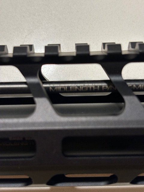

Turns out it is a Mid-Length , I will post some pics later.
And the barrel profile does not look like the Rosco K9 at all.
If everything works out I will measure the gas port size, and post that info.

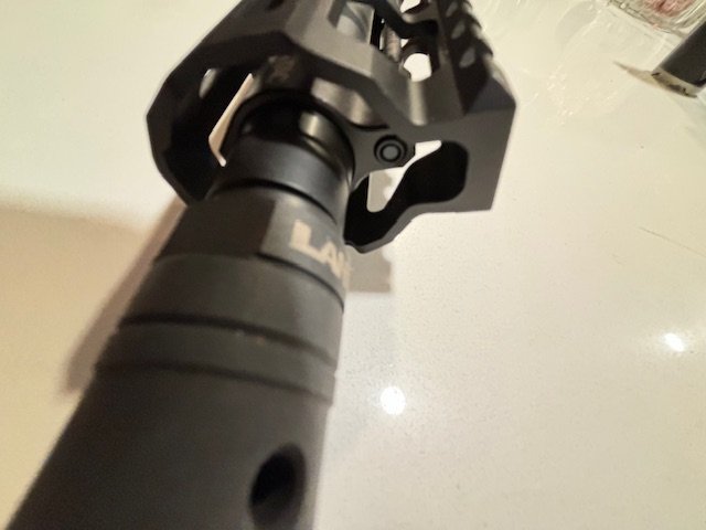

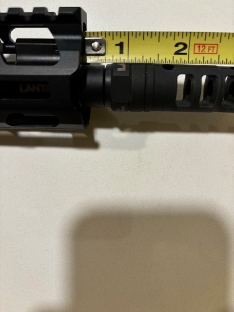

Pics.. of the 11.5"
The first pic is of the tape measure pushed against the front of the gas block
2nd just kinda shows the limited space for a click Adj. GB ( SLR ish )
3rd Funny the gas tube is marked. We will see how long it remains readable.

View attachment 8290967View attachment 8290969View attachment 8290971View attachment 8290972
Where the port is located is back about 1" from the front of the block. Gas port is about 2.5" from muzzle. That's to close. A light weight bcg might help?
