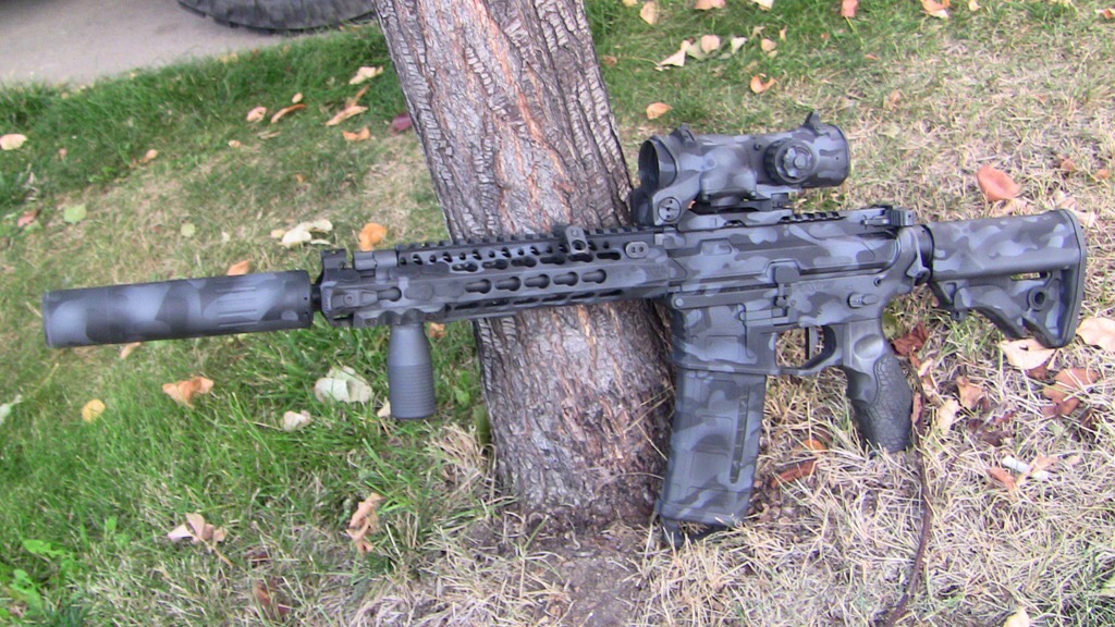

Adjustable gas blocks that fit under a DD Mk18 rail are easy. I'm running an Ergo under mine (Currently with a SOLGW 10.5" barrel after my LMT 10.5" barrel started to die), but a Seekins adjustable (not the lever style one) or most similar blocks should fit just fine. With the Ergo block, I can reach the side screw through one of the cooling holes in the RIS II handguard and the front screw from the end of the handguard with a long allen key.

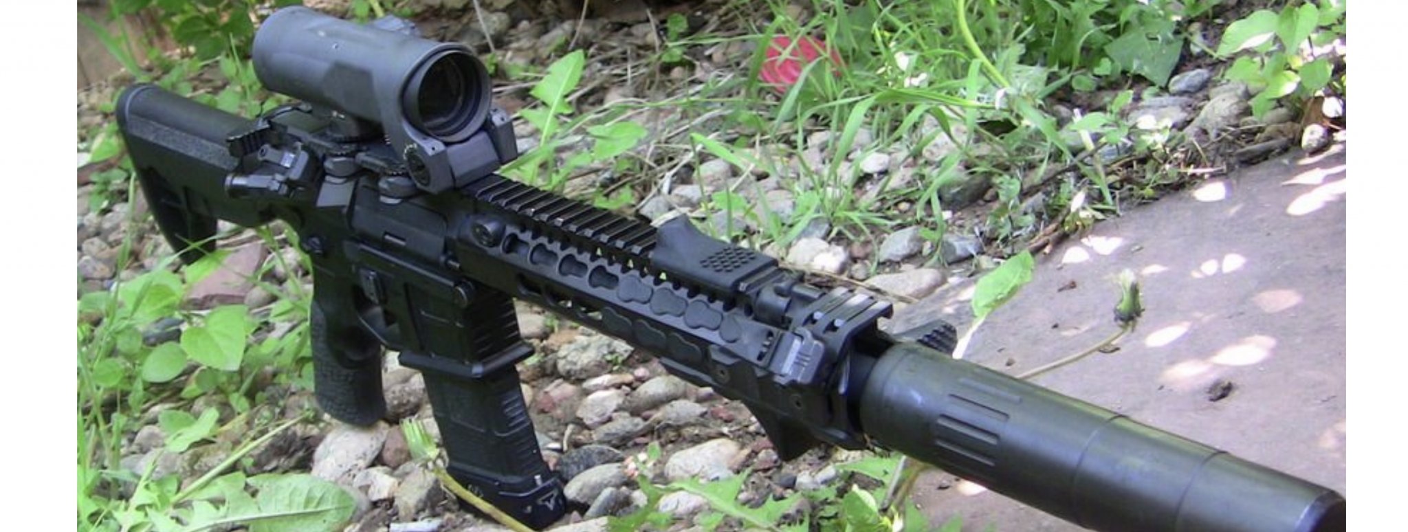

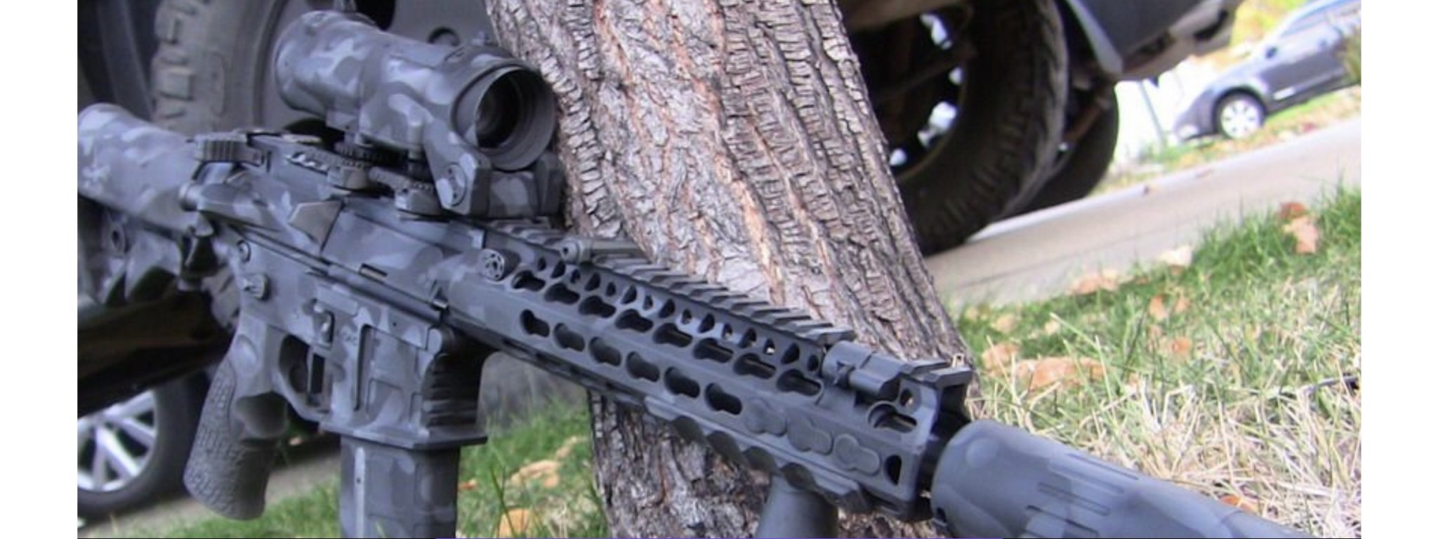

Here’s a BCM KMR handguard machined out to clear a Noveske Switchblock
I’m using the Superlative Arms low profile block and it works fine under the tight Seekins rail. It comes with an extra long Allen key for adjustment if yours ends up really far under the forearm, which I doubt would happen with an 11.5” barrel.

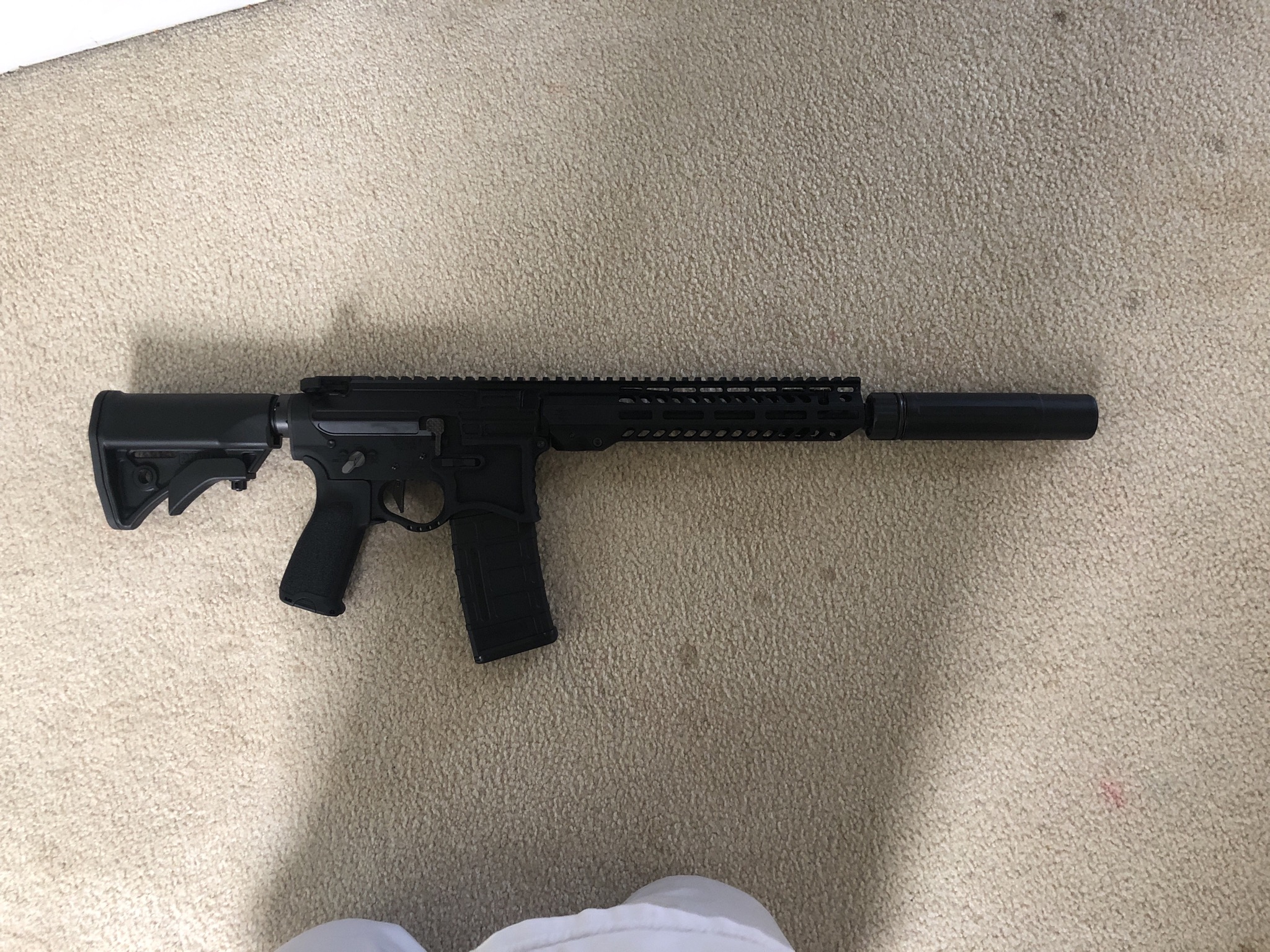

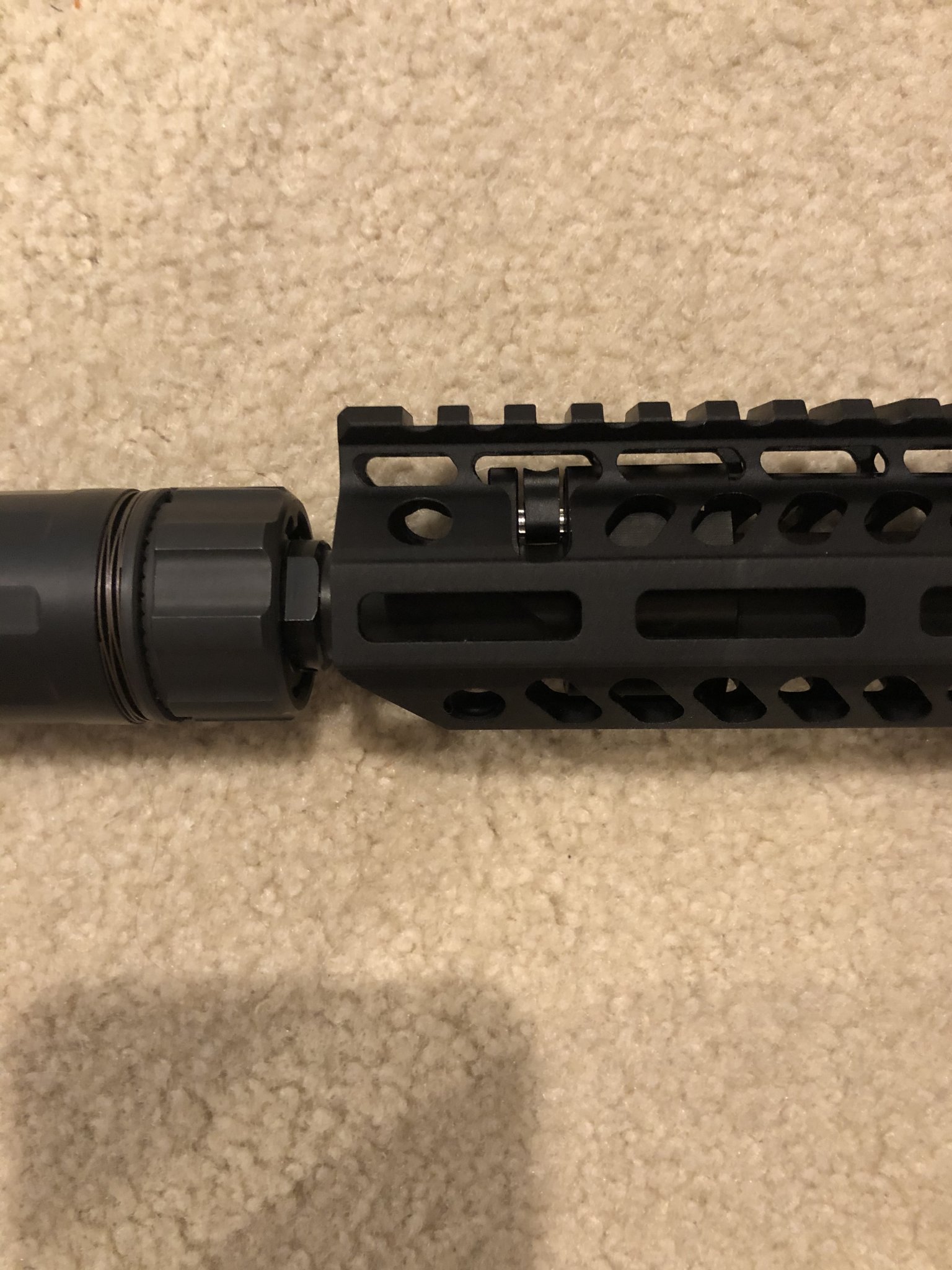

Seekins makes a nice 10.5in complete upper with their new quick throw adjustable gas block. I used it on my newest build. It’s very slick the handguard is machined out on the sides to give you access to the throw lever the top of the rail is continuous to allow mounting of MAWL, PEQ, DBAL, etc

Seekins makes a nice 10.5in complete upper with their new quick throw adjustable gas block. I used it on my newest build. It’s very slick the handguard is machined out on the sides to give you access to the throw lever the top of the rail is continuous to allow mounting of MAWL, PEQ, DBAL, etcView attachment 7346575View attachment 7346577
Can you get a better closeup of the cutout, please? The Seekins 10.5" doesn't seem to exist on their website anymore, and I wanted to go with a 11.5" anyway, but I'd love to get a better look at it, and at the other cutout rail you shared, for some ideas.
Yeah Seekins doesn’t list their 10.5 CQ PDW upper on their website. But I called them and placed an order for one. They do have a SKU number for it. I’ll snap a pic of my upper when I get home

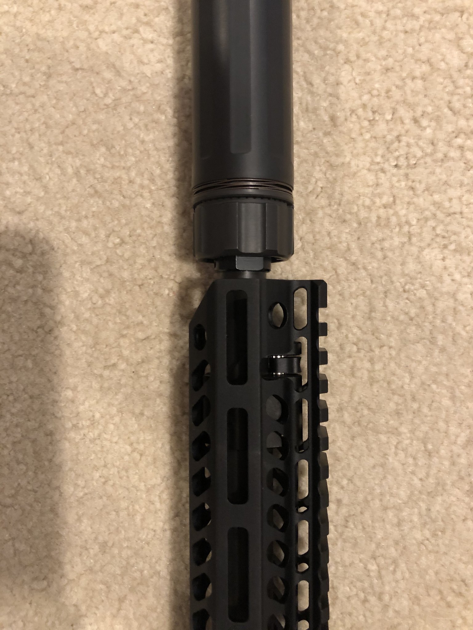

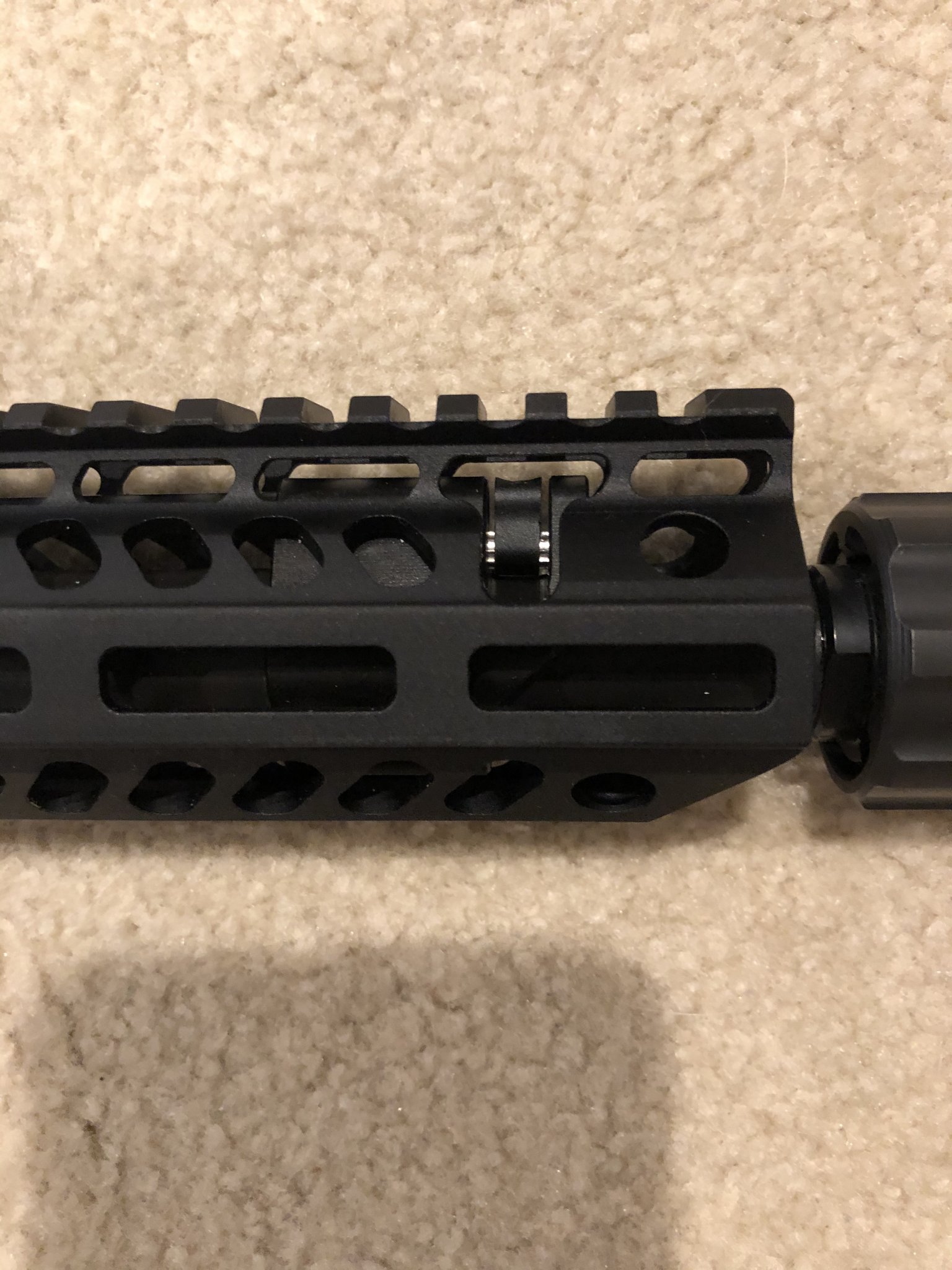

Here’s the Seekins quick throw adjustable gas block on their new 10.5in upper. I believe it has 40 detents in total to get it tuned. All the way right is suppressed. All the way left is unsuppressed. But you have 10-12 detents in between. So you can add / subtract gas precisely as needed.
