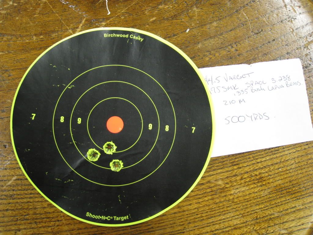

I just had one built 18" w/11.25 twist and got it to the range last week for a trial run..only made up 20 rds with 44.5 Varget and the 175's..only got it out to 500 but it looks promising. Just sent it to Kampfelds for some of his magic!!!

Well Cigarcop, I would have to say that the accuracy of your gun and or you is badass. Those are groups that I would like/love to have out of my gun at that range. I have some like that at 200 and 300 but not at 500.
Re: 11 twist 18 inch .308?
<div class="ubbcode-block"><div class="ubbcode-header">Originally Posted By: rundm</div><div class="ubbcode-body">Well Cigarcop, I would have to say that the accuracy of your gun and or you is badass. Those are groups that I would like/love to have out of my gun at that range. I have some like that at 200 and 300 but not at 500.</div></div>
I'll bet there is 4 more holes under that white piece of paper!
<div class="ubbcode-block"><div class="ubbcode-header">Originally Posted By: jasonk</div><div class="ubbcode-body">
</div></div>
I'll humor you one time my lil buddy....even an old crippled cop can have a good day once in awhile!!!
<div class="ubbcode-block"><div class="ubbcode-header">Originally Posted By: Cigarcop</div><div class="ubbcode-body"><div class="ubbcode-block"><div class="ubbcode-header">Originally Posted By: jasonk</div><div class="ubbcode-body">
</div></div>
</div></div>
Jesus, thats damn good shooting. Looks like you have Auto Aim on...Damn

<div class="ubbcode-block"><div class="ubbcode-header">Originally Posted By: Armed Ferret</div><div class="ubbcode-body">Cigarcop: 3.238 OAL? </div></div>
Yes, that is obviously with the comparator on the calipers for base to ogive measurement.
