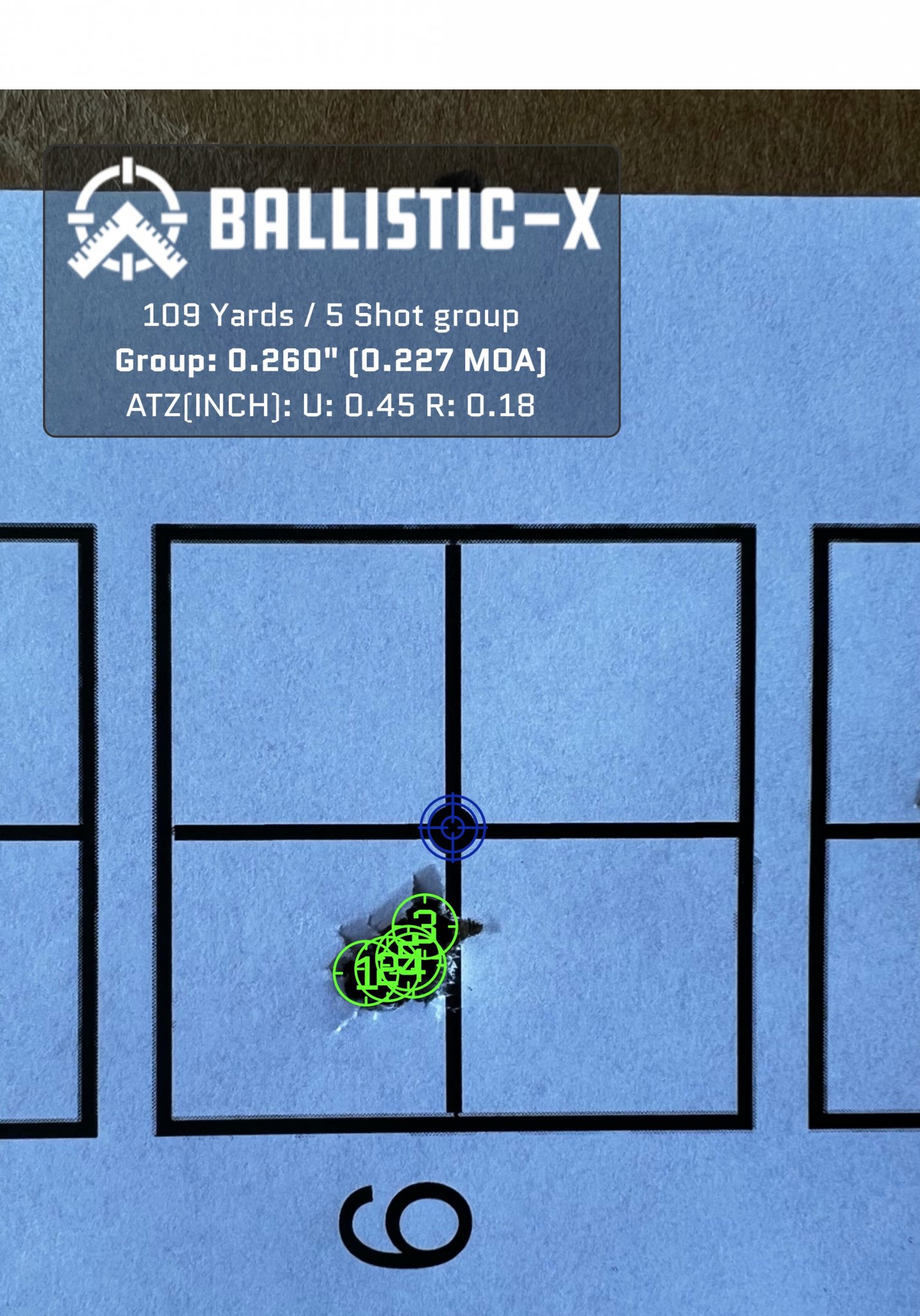

Likely this has been mentioned before but I can’t seem to find much info on it.
I have 1500 112 MB’s and want to try them in a dasher barrel. I have Alpha brass, Varget and cci 450’s.
Anyone trying this combo?

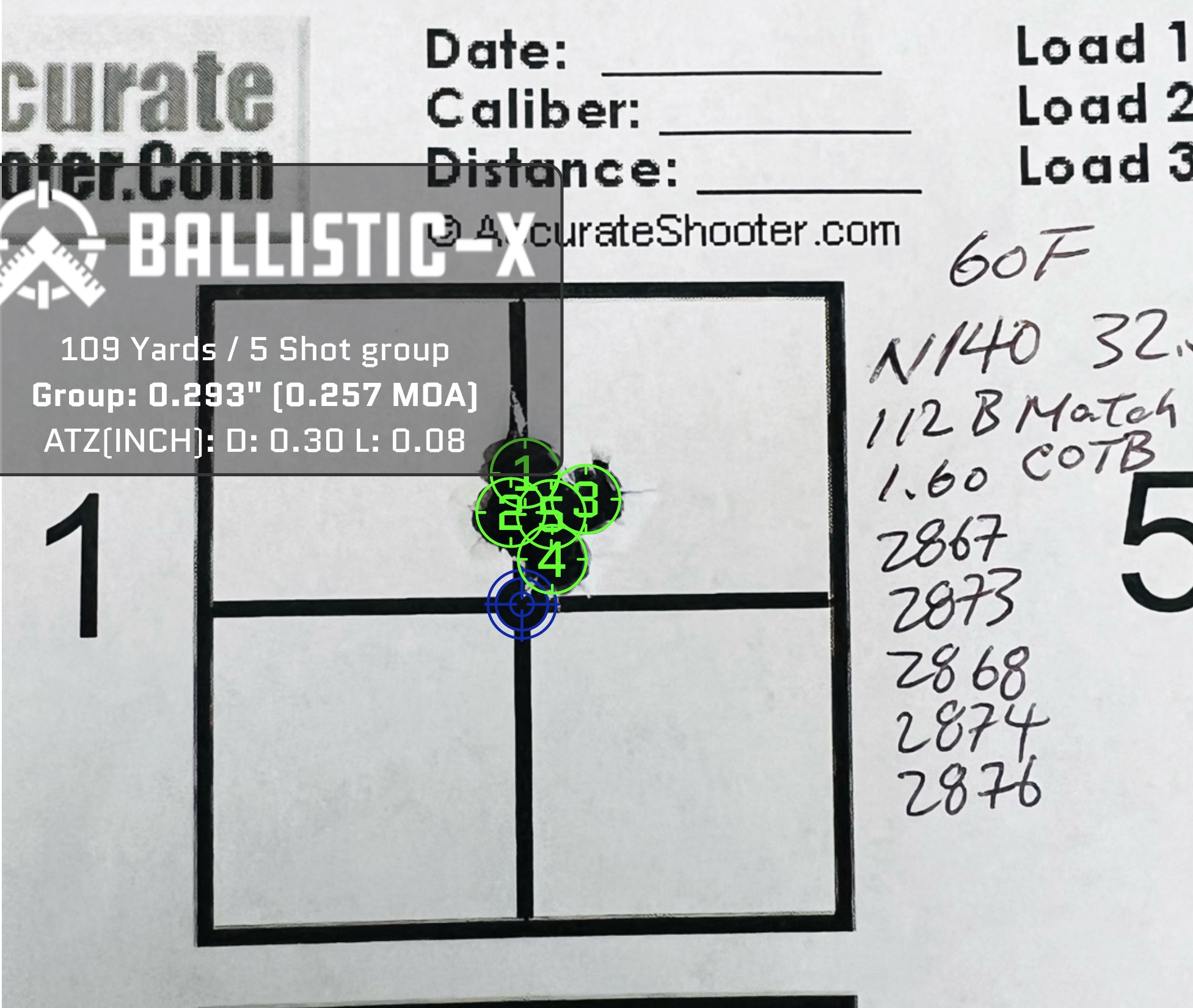

N140 32.5gr
112 MD, sorted by weight
2880fps , ES 9
I’ve shot 4500+ in 6CM and just started shooting them in 6GT with nearly the same stuff as you: Alpha OCD, 450’s, SW Precision Rifle (Varget clone).
They hammer, I’m sure it’ll be the same with a Dasher. They like to jump, I’m .100” off.
Reactions: ototallydude
Now I’m trying to find a safe starting point for load development. I was thinking around 31.0 and walk it up
I jump 0.100 off the land also. Always work your load up and be safe.
I'm at 31.4gr of Varget now, Alpha brass, CCI 450's gets 2880fps. I'm jumping just 0.010" from where my lands originally where. 0.010" up to 0.050" had consistent POI so I went with 0.010" and it's held zero through 1600 or so rounds so far.
Tasty! I have 145 Match Burners in .264 that shoot similarly - although mine need to be sorted for both weight and length for longer range. Enough variability to show vert dispersion beyond say ~500 yds.
I’m running the 112s in my proof prefit dasher and StaBall 6.5 around 2840. Very sweet combo so far. Better accuracy than my 108 eldm load
Update: I'm running them at 31.4 Varget as well. Absolutely hammering. Put 200 rounds through it and velocity came up to 2815 fps. Using AB and everything is lined up, match this weekend.
33.2—33.6gr has been consistent for us. Very jump tolerant in our experience as well
I just runned a seating depth test at 34gr
Nothing good expect from 0.040" jump. Everything else from 0.030 to 0.100" shot around 3/4
Barrel is still new (105 shot fired )
34gr was giving me 2784 fps
I ran these all last year with Alpha brass, 28.4 Varget, CCI 450’s. Velocity was about 2600 which is super slow but it was hammering in the accuracy department and I was at the end of the life on that barrel so I just ran them. With my new barrel I will up the load for more FPS, 2800ish would be nice.
Reactions: MarshallDodge
