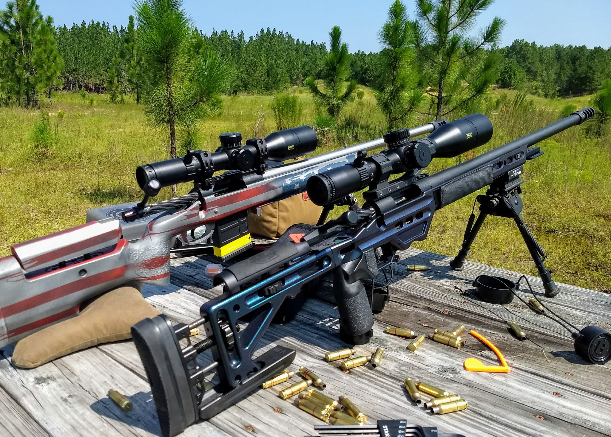

    Been shooting 108 eld's at around 3000 in two 6 creeds, good results. Alpha Munitions 6 CM srp brass, 39.6-40 gr H4350, 205Ms, at 15-20 off.
    Recently got a Dasher, it's going 2985 fps with 105 hybrids. So wanting separation among calibers now, and a more potent 6 creed load.
    115 dtac came to mind. I have 110 smk and 110 jlk on hand already, but have not used. 1:7.5T 26" Rock Creek is new blank I'm looking for new diet. Curious what velocity is typical.
    Basically, trying to compare AB mock ups in app to see if juice is worth the squeeze. Wind performance my only goal here. Tentative plan, Dasher for fair weather, mid range matches. Hot 6 Creed for windy or longer courses of fire.

    There is a guy around here pushing moly'd Dtacs at just under 3200fps. I've been beside him and smart money says it's high on pressure, but it does not show it.
    I would say 3075 would be a decent number to shoot for. I can also say, the 110 will yield more speed at a lower pressure than a dtac, and 3100 should be comfortable. With that though, H4350 while being a rock solid performer, is not what I'd classify as a performance powder, there is other powders that will yield quite a bit higher velocities if you care to dick with it.

    I have shot out 5 barrels using hornady 6 Creedmoor brass, h4350, and 115 dtacs. All ran the same load from 3025-3050. All barrels were 26" Bartlein barrels. I typically found my best accuracy around 2950 and 3025 fps. You should be able to hit your 3020 goal with acceptable pressure in a 26" barrel.

    Yea, somewhere around that should be good. Honestly, i found the dtacs to be very seating depth insensitive. Of the 5 barrels i shot out, 2 were from Jeff Hayes (formerly flounder at GAP), 1 was from Mark at SAC, and 2 from Joel Pendergraft. So, 3 different reamers but id assume they were similar spec. I just loaded them .020 off the lands and let it rip.

    I'm running close to max at 3050-3080fps for my current barrel. 1:7 26" Bartlein. Hornady brass, H4350, plain 115gr DTAC, Fed210M.

    when i shot a 6CM thats all i shot was the 115g DTACs...5 24" hawkhill barrels 7.5 twists all with H4350 running 3025 to 3075 but 3050 seemed to be the sweet spot.
