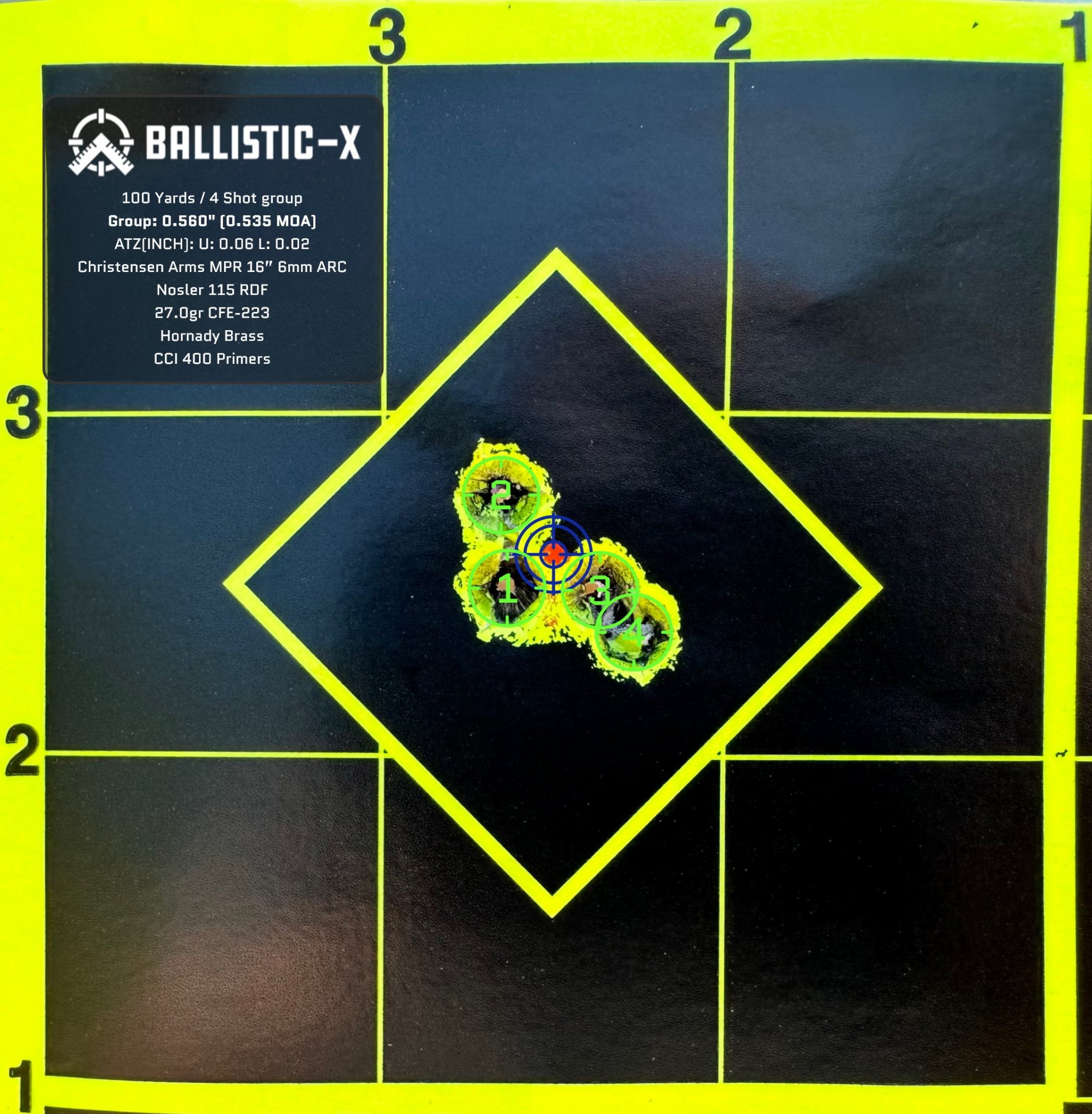

If you're referring to .243/6mm Nosler 115 RDF's, then I have 1000 of them sitting beside my bench for loading for my 6mm ARC bolt-action. Started load development today, and they show promise on the first initial round of rough node finding, and max safe powder charge.
