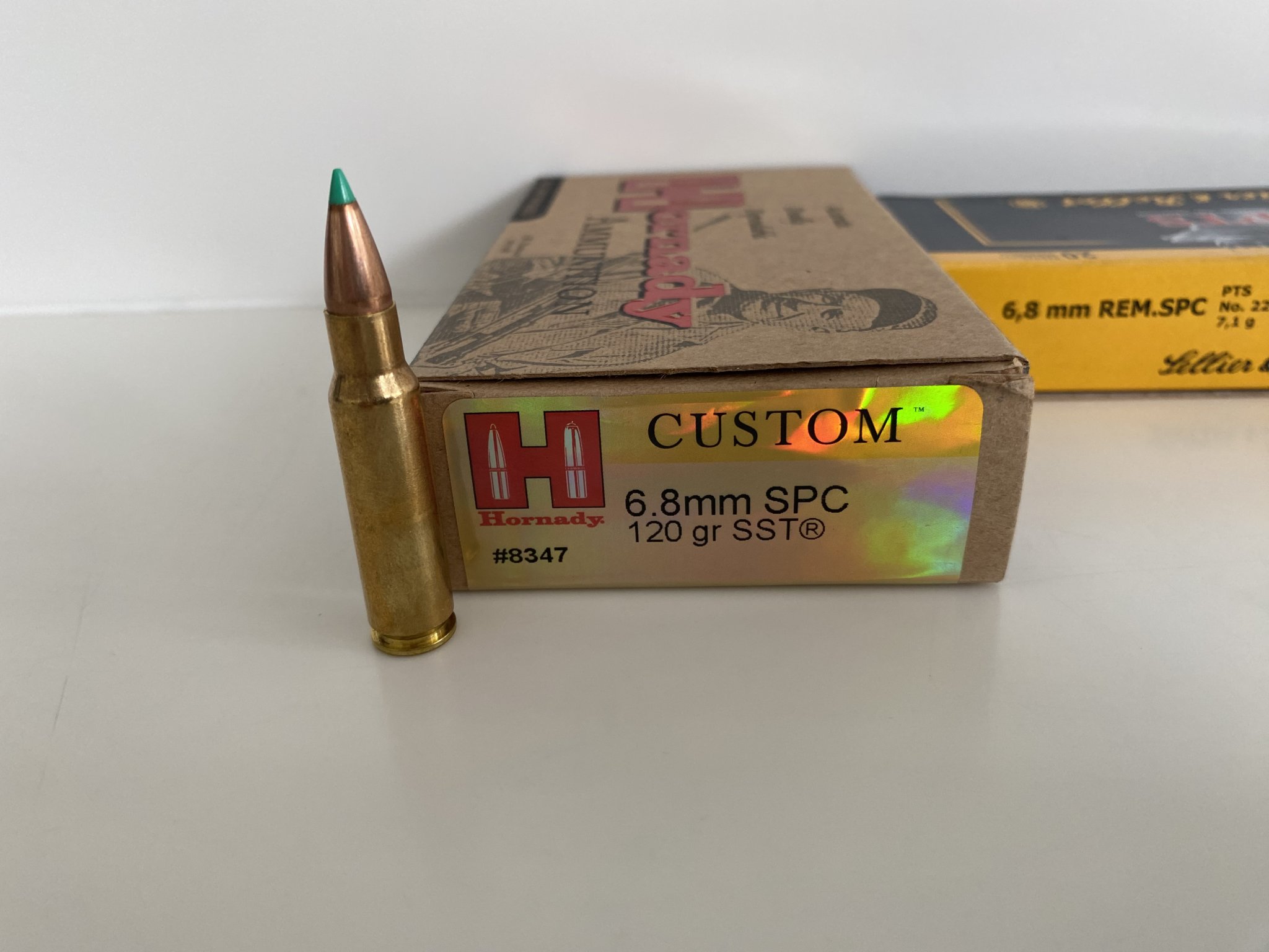

6.8 factory ammo ranges from 90gr Federal Fusion to 120gr Hornady SST. Most 6.8 SPC ammo is 110gr or 115gr, all of which have pretty low BCs but a lot of frontal area for impact on hogs and deer. Hits hard within 200-300yds depending on barrel length and conditions.

Since you reload you can really squeeze some extra performance out of the 6.8. Getting 2.295 COAL is no problem with most 6.8 mags (PRI, ASC, CPD(or duramag) for sure). As constructor said there's a pile of data over at 68forums.

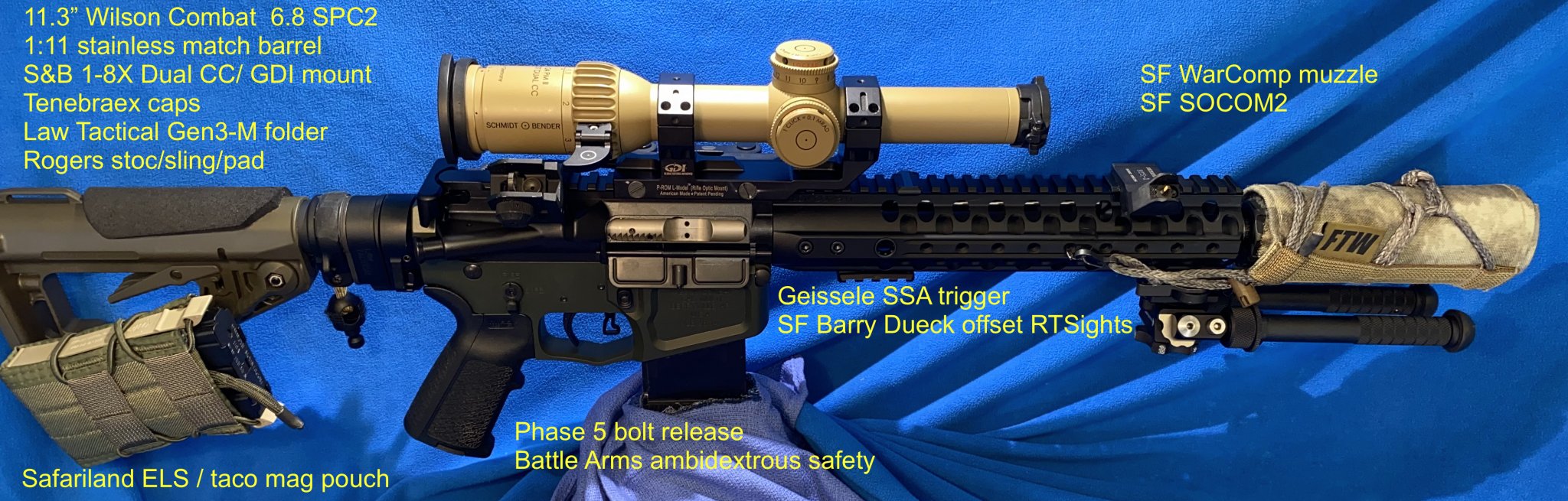

@strikeeagle1 Thats a sweet ride! Several years ago when I had access to a private 500yd KD I took my 12.5arp 6.8 to 500 with S&B 110fmj. PA 1-6x on 6x got me a ~5x7" grouping. Still my first "we gotta leave right now" rifle to grab from the safe (though now it has a prism sight on it).

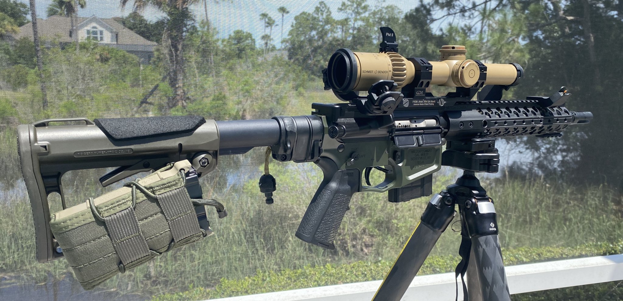

@strikeeagle1 - congrats sir, that’s a sweet rig you’ve “cobbled” up.
Curious how the Remington factory ammo groups at 100, and if you’ve tried any other loadings. Maybe they’ve sorted some things out but seems like it had a not so good reputation 10-12 years ago when I began my 6.8 journey.

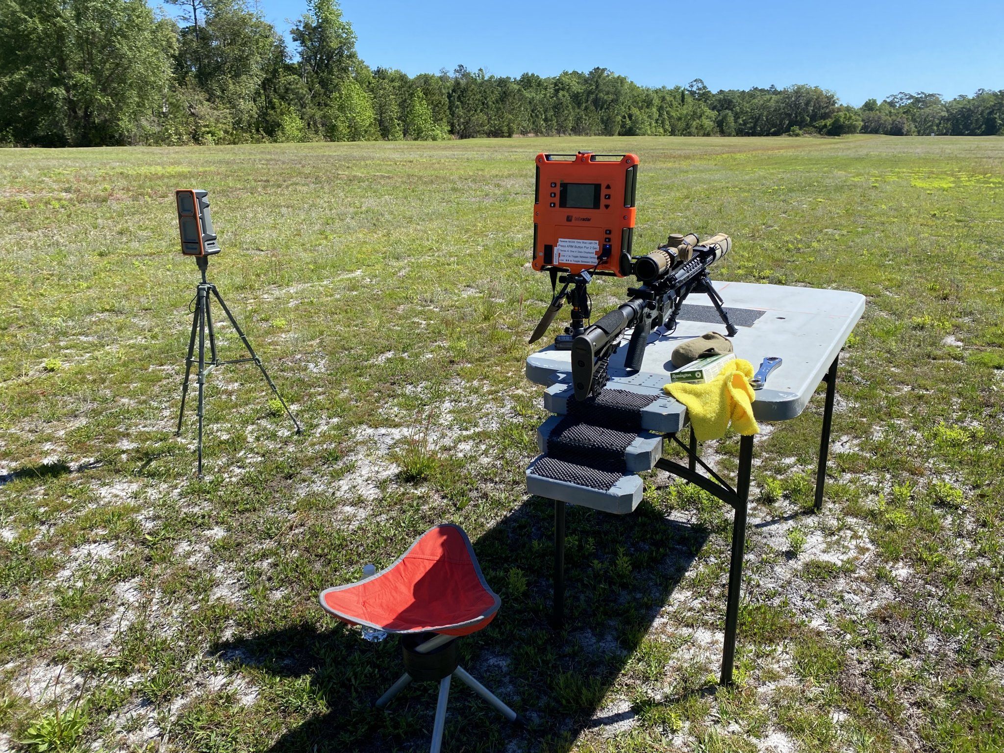

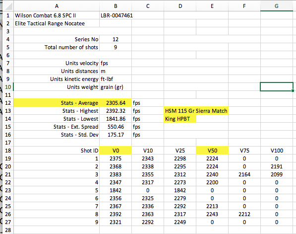

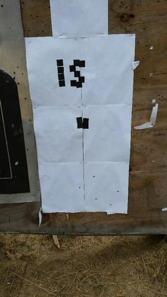

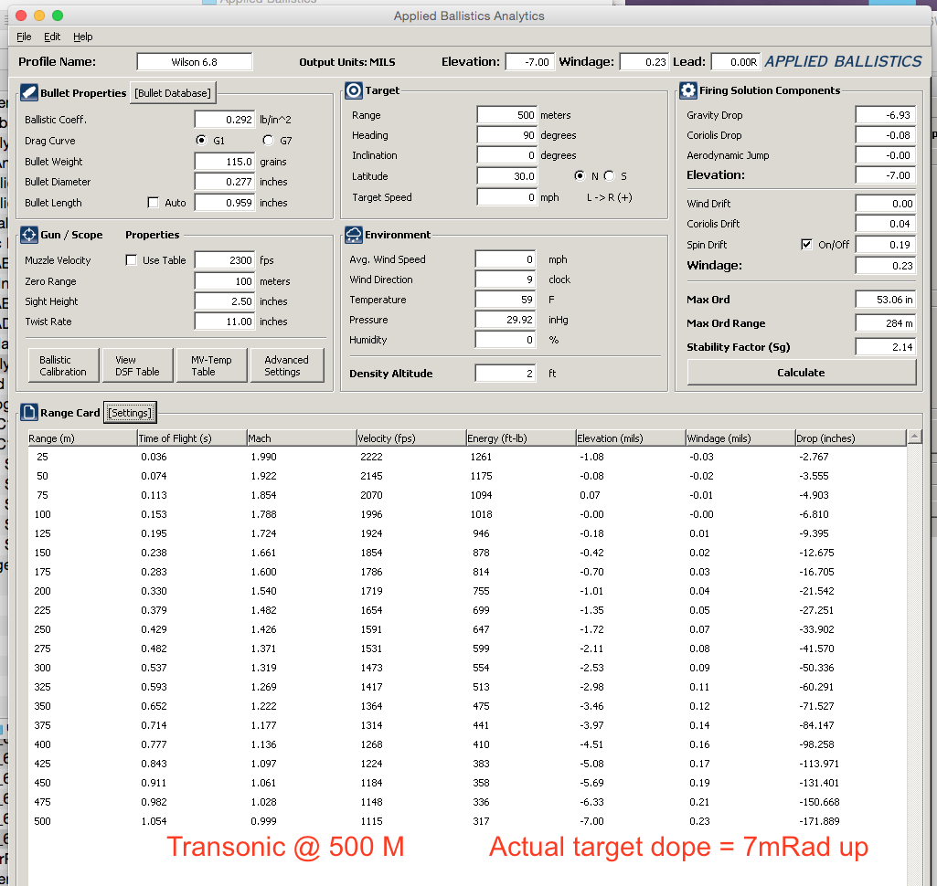

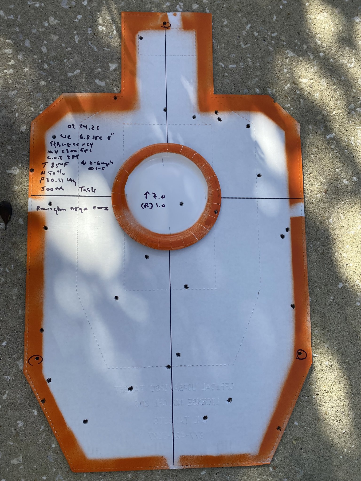

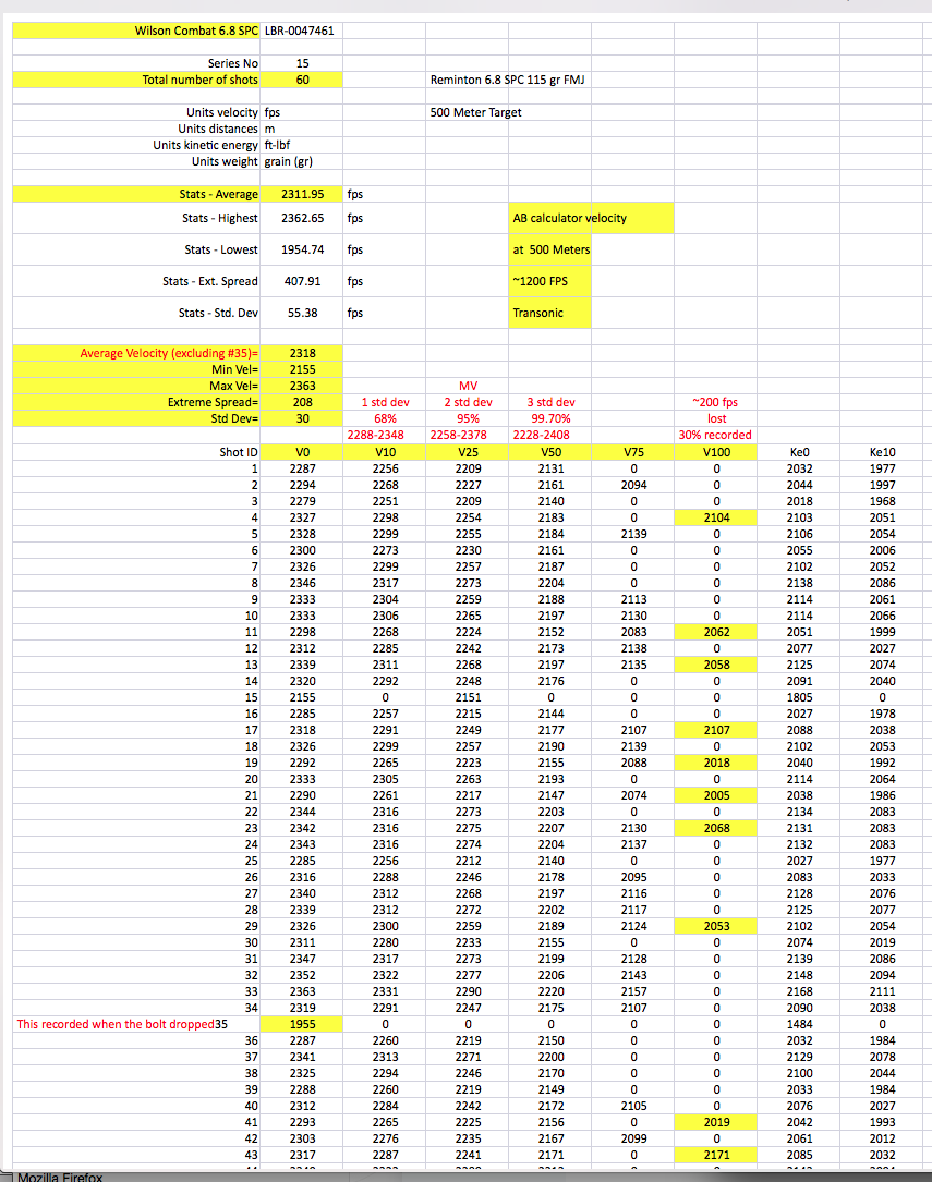

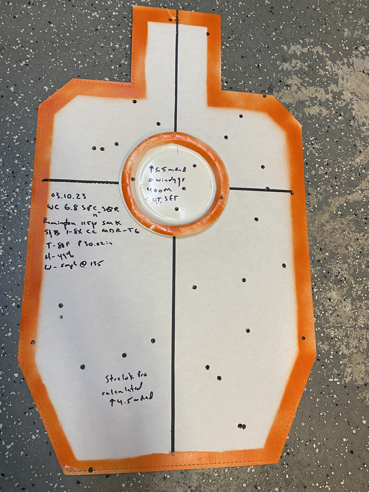

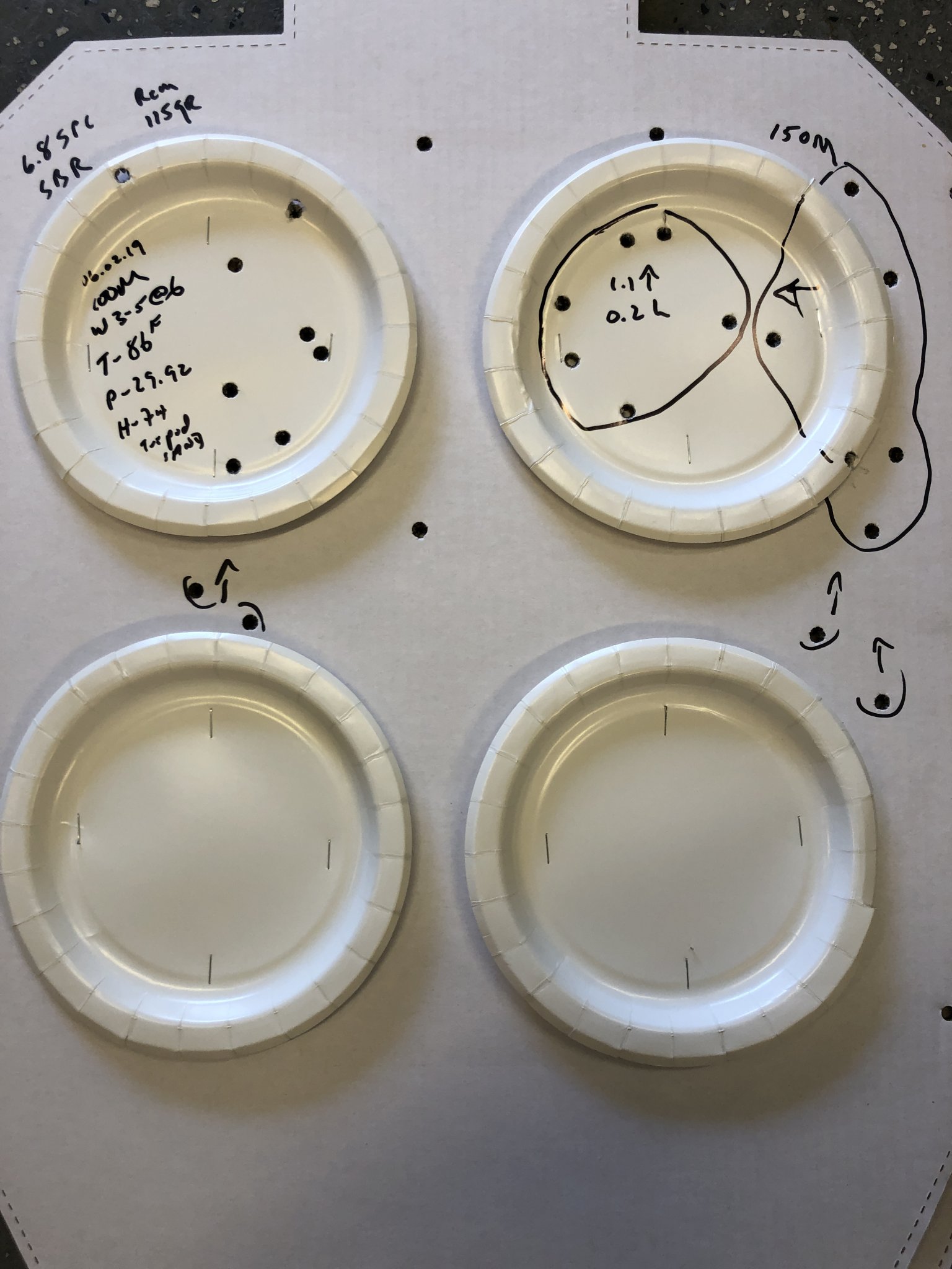

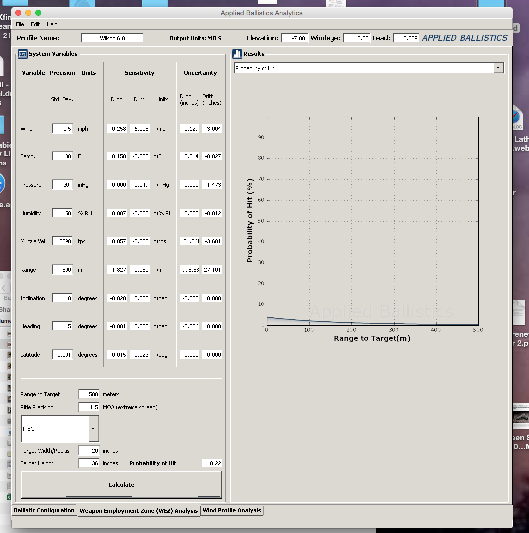

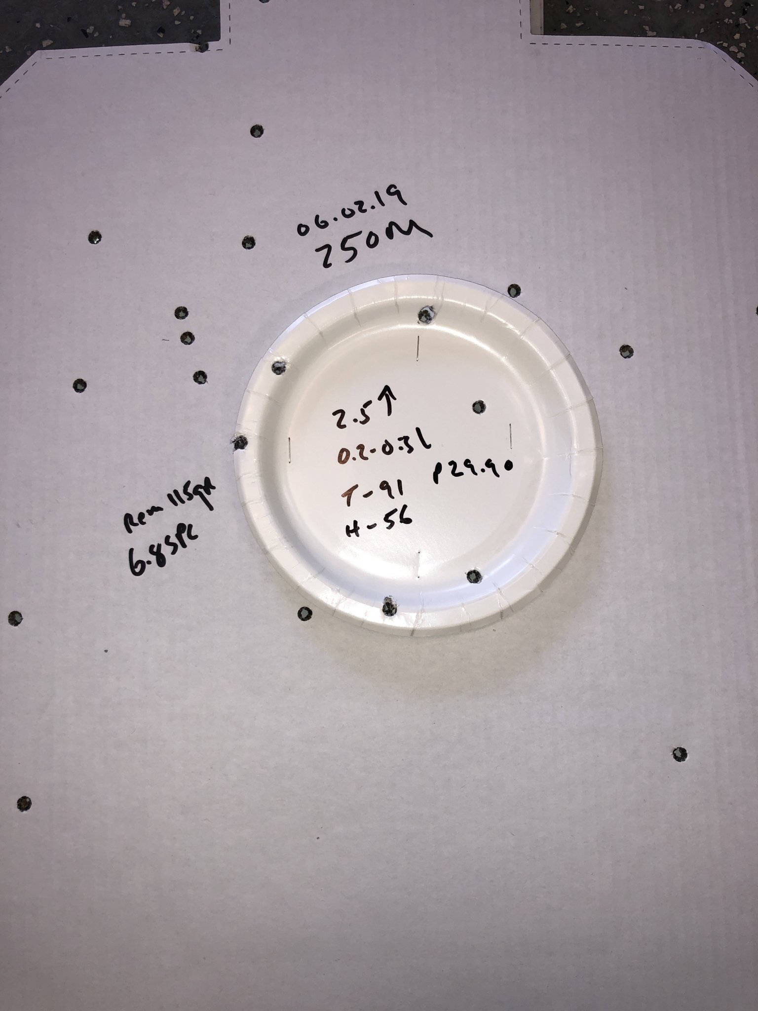

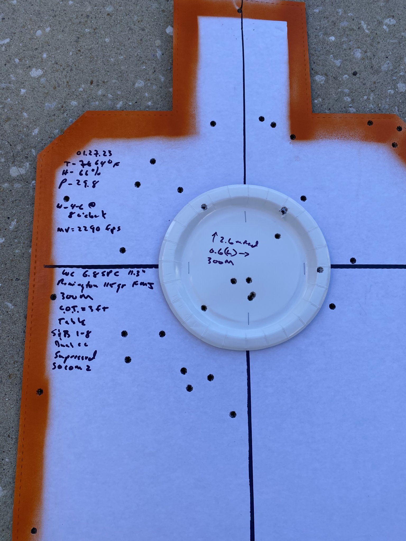

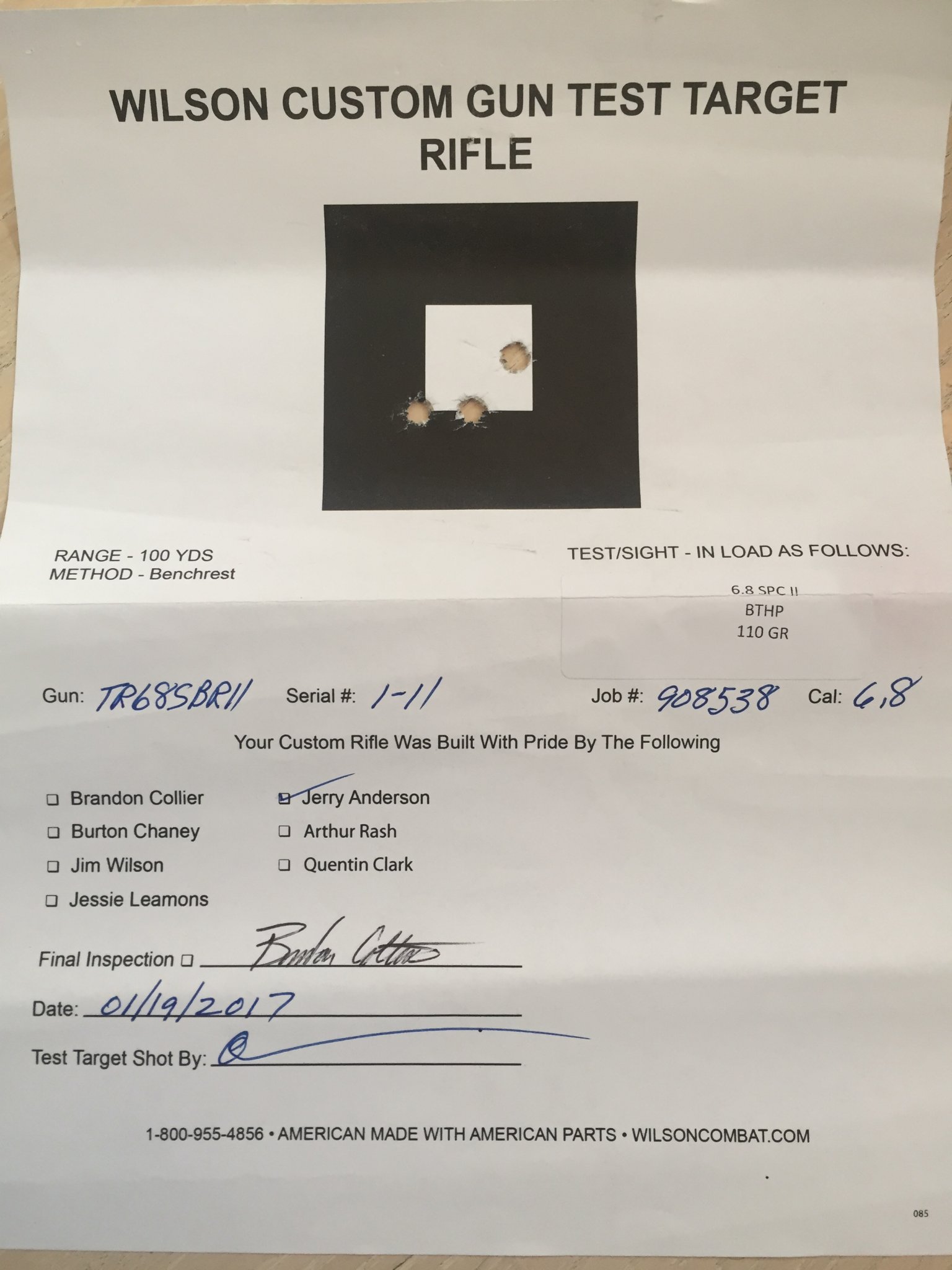

I only these target results archived I could access easily. 100 (tripod)-150-250-300-400 Meters. All 115 gr Remington FMJ for consistency.
I think Hornady 110 HPBT, 115 Federal Fusion, S&B 110 PTS is better ammo. Pretty easy to get 1" at 100yds with those.
The WC should shoot better than that. Definitely try some better ammo, Remington would be my last choice for accuracy testing.
I don't have any targets saved but my 12.5" ARP can easily do 1" groups at 100yds with factory 120gr SST's and a tbac 30PSS hanging off the end. My 18" wasn't any more accurate so sold it as the 12.5" is my main deer rifle. I have found the same with accuracy results with ARP's 12.5" and 18" .223 barrels.
^^ Thanks for your thoughts, that's my next Plan. I used the Rem 115 as I had a lot of it to step it out to 500 meters. I have LR data on Hornady 120 SST and HSM 115 SMK; all three are within a few fps @ 2300. Found my WC test target which is ~ 1 MOA and noticed they used 110 gr HPBT, so I am going to source some and re-zero. Any recommenations as to which brand? I have some S&B 110 but it's not HP.
