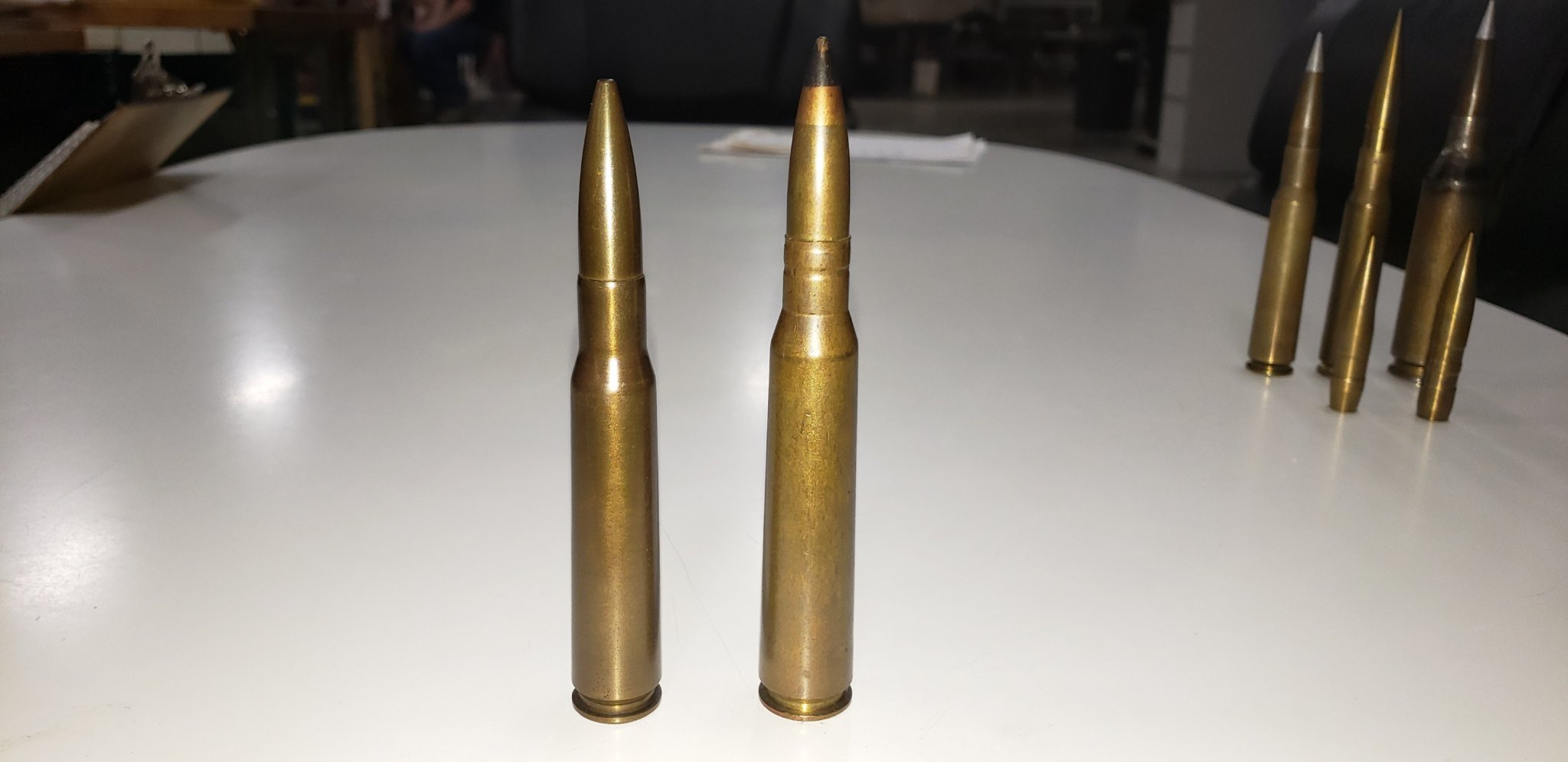

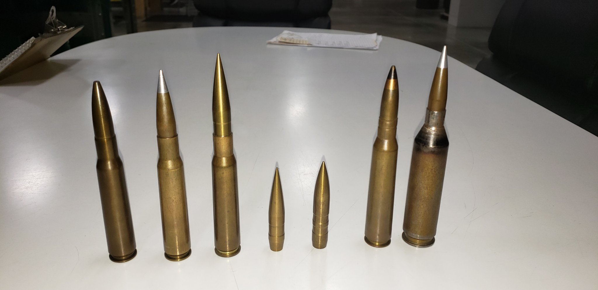

Here a couple of pic's for comparison. The last picture is of a WW2 vintage 50bmg ball round next to a standard 12.7x108 round. I think it is a AP/tracer round if I remember correctly. I'd have to dig out my ammunition identification book to look up if it's a APT or a API round.
In the first picture is a line up .... from left to right....
50bmg ball round, 50bmg w/Hornady Amax bullet, 50BMG w/Barnes 800gr solid bullet, 800gr Barnes and custom 900gr Barnes 50cal bullet (they made me a small batch 20 years ago), then the 12.7x108 Russian (dated 1945. Just below the black painted tip is a faint band of red) and last but not least my prototype round for the 14.5 Russian necked down to 50cal.
