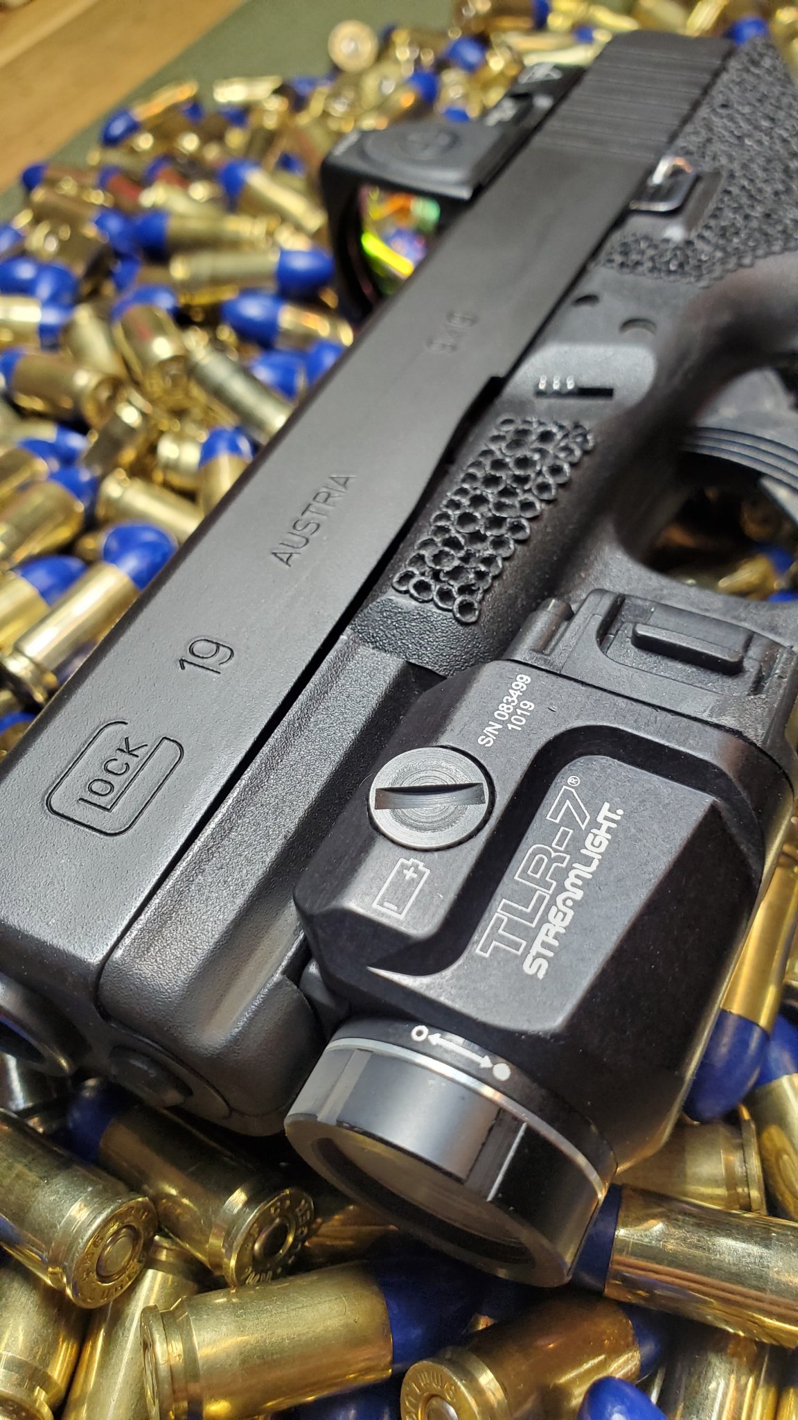

3.7 grains of titegroup. I'll get back to you tomorrow on OAL. This makes minor power factor for USPSA. I have loaded a few of them.
