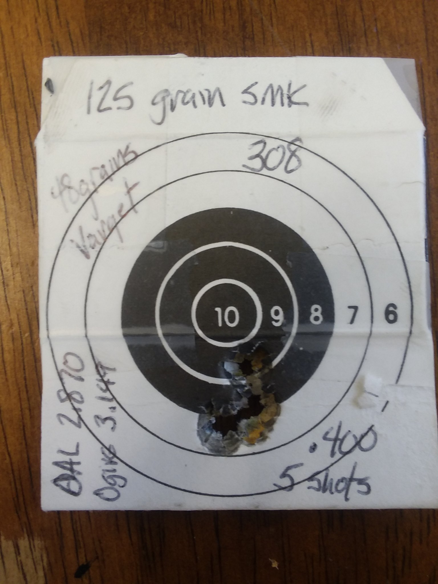

Well I figured I would just go with what I have, varget.
I'm pretty happy with the results!
125 grain TMK (I know I fixed what I wrote on the target, not smk..)
48 grains of varget
CCI primers
Curious on your Vel/FPS with that ? . If it working for you good . but 48 grain of varget to push small 125's, is a lot of burn .

I dont have a crono..
I had thought about stepping back on powder and see how much varying I get. I'll try some loaded to 47 grains and some at 46?? And see what I get this is all new to me I just started loading rounds.
I already had 12 lbs varget powder so I just tried that before I bought something else..
I'm not trying to imply this is the best recipe, just that it shoots great for me so far. I can snap some pics of things to help verify if you'd like?

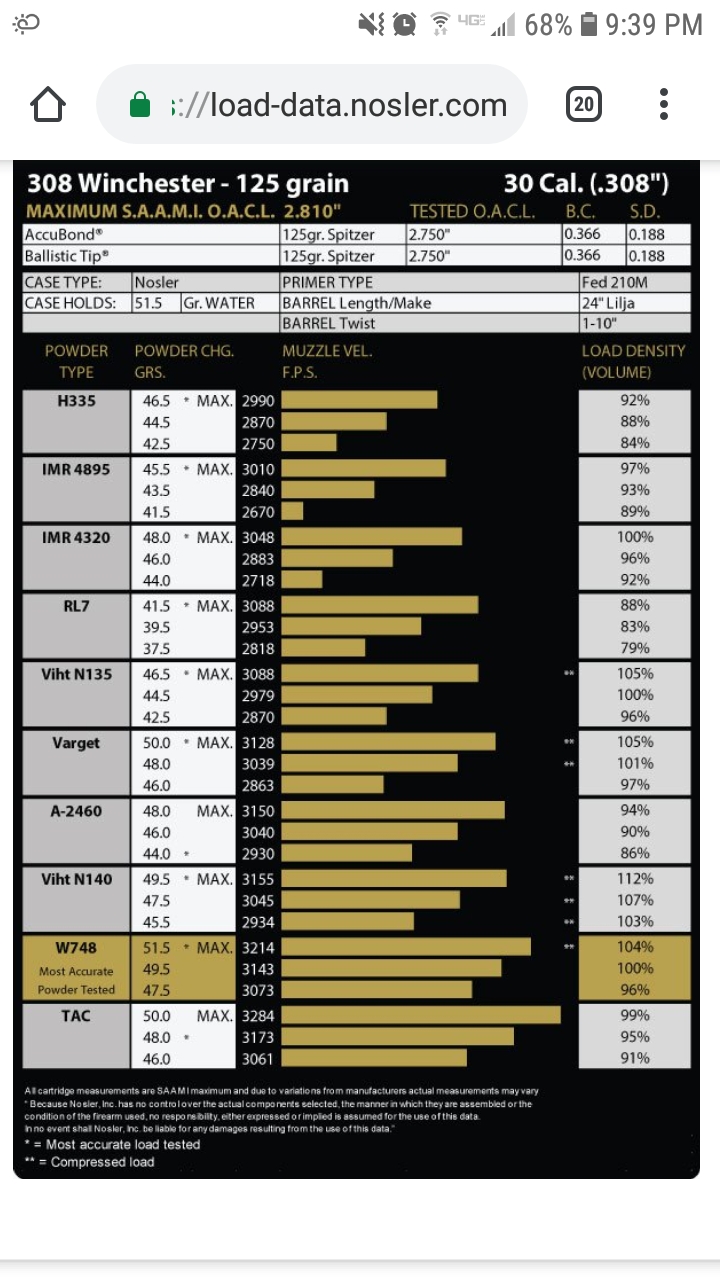

I know it's not the exact bullet I'm using but this is where I got my base line from.
