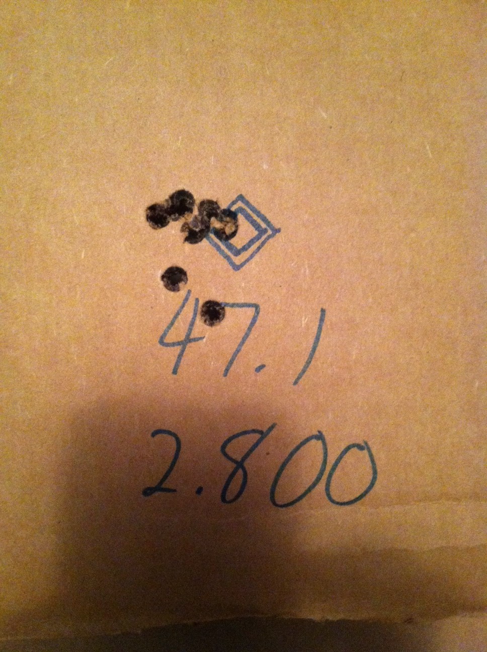

I've been playing with the 125gr SMK and IMR 8208 combo over the last few weeks and finally settled on a load after more OCW testing. I've been using Lake City brass with 47.1gr 8208 with an OAL of 2.800, which just fits in my pmags plus a little wiggle room for any slightly longer meplats.
This combo gave me 2950fps out of my 16" JP. I did a 10 shot group (Vortex 6-24, Atlas bipod, rear bag while prone) that came in at 1.3". Not sure if I pulled the bottom two or if it was the load. Although the brass was all Lake City, it was varying years. I did sort by neck concentricity (kept it at .003" or less). The remaining 8 shots were .75".
