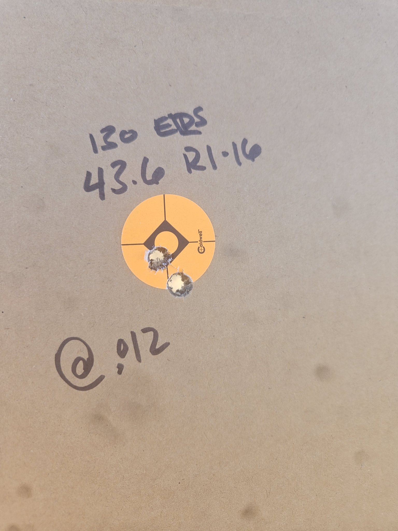

    Sooo... Maybe this is the exception because this is the 130@ . 012 off.

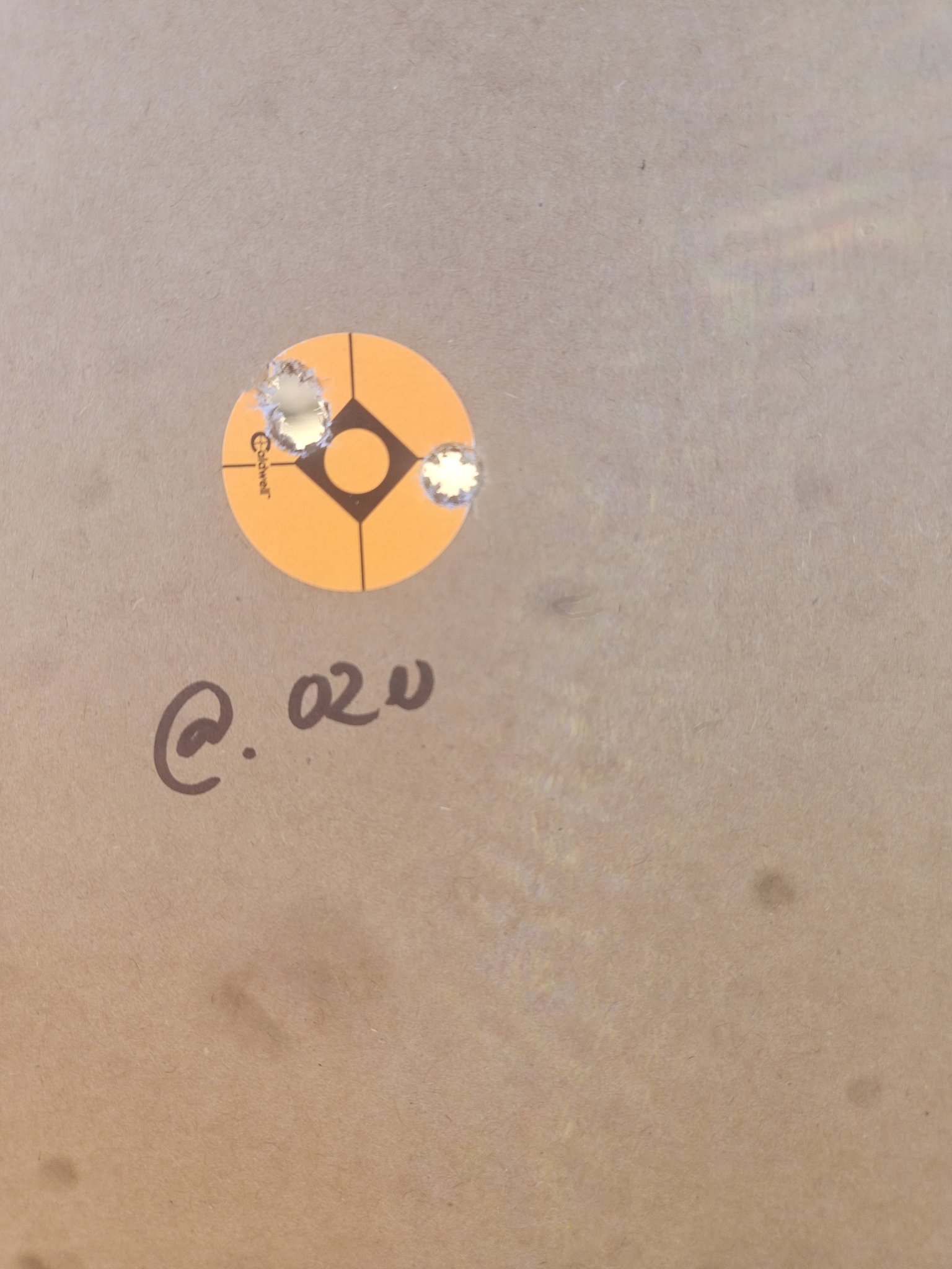

    Yep... That's 3, with two through the lower hole. And then again at. 20

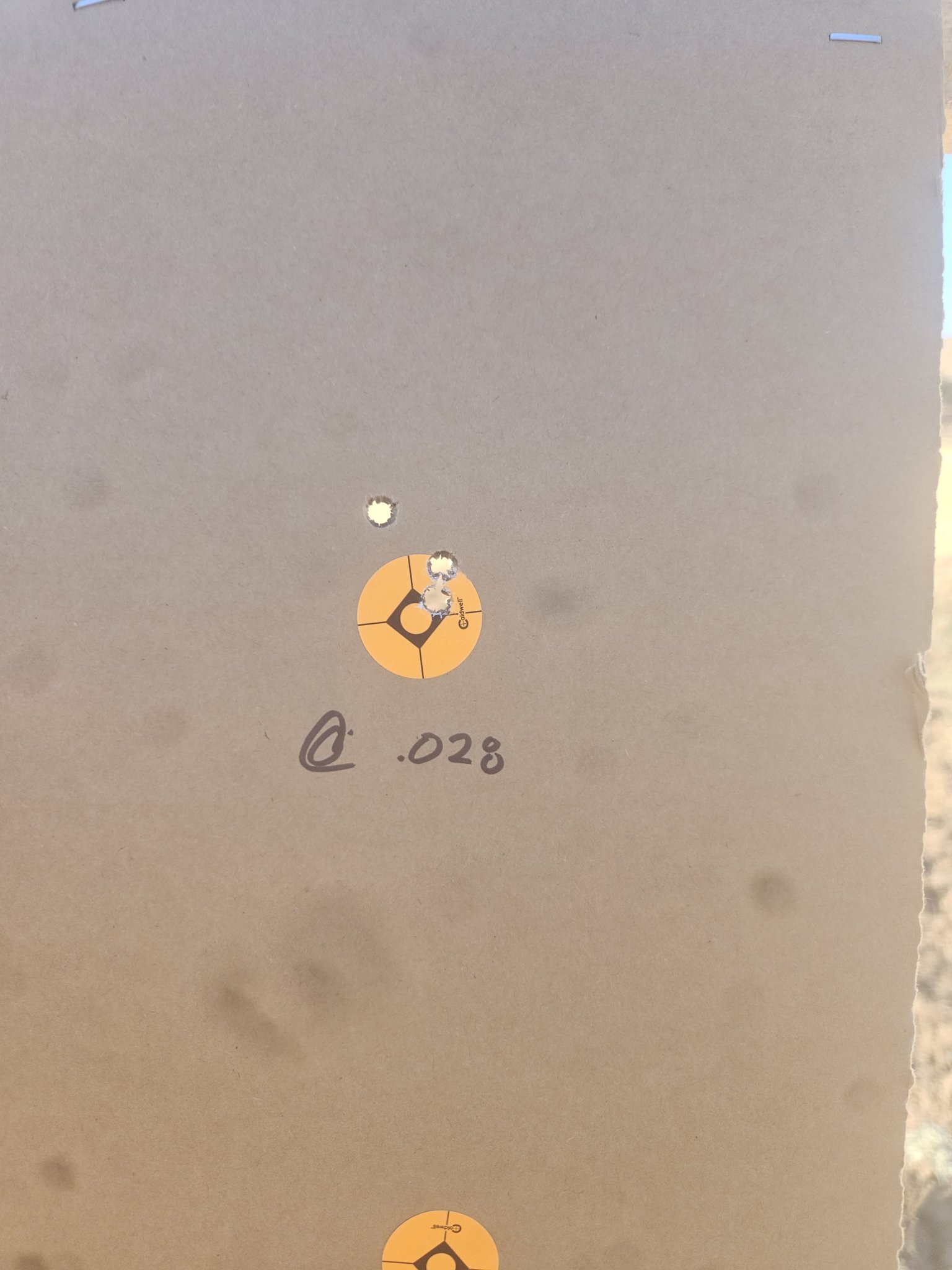

    Pattern continues to [email protected]
