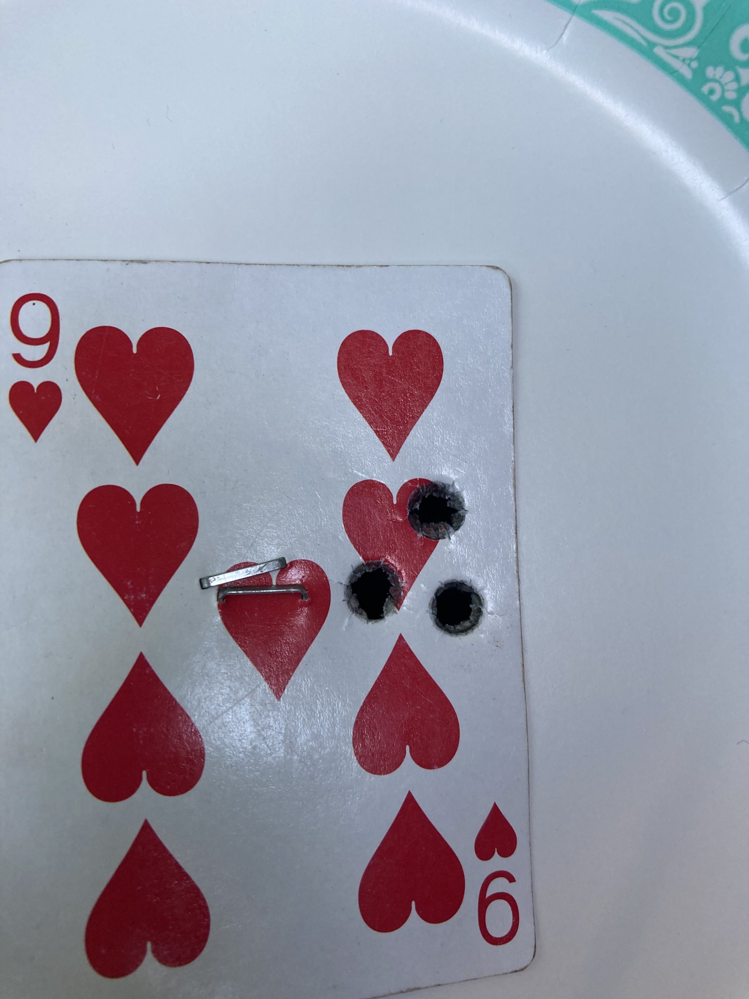

Here is a why I’m thinking of using this rather light Barnes bullet- not only does the rifle carry very nice especially with the mountain sling but it shoots these little pills very well. Standard playing card center heart was POA- this is the second sub half inch group at 100- and the scope isn’t dialed in for them yet and the scopes top magnification is 6. I’m very pleased and never expected this kind of accuracy from someone else’s problem rifle that I got in trade and definitely feel I got the better end of this trade- actually this is the rifle that led me to snipershide! The reading and advice here on mix o match LR308s got the bugs worked out and the rifle working 99.7% of the time. And shortly there after caused me to buy a Begara HMR and start shooting my old 300 and 7mm weatherbys at longer ranges . 81C17F4E-5833-4229-A767-FA7757A1EE93.jpeg
so again the high points- Very good trigger, accuracy exceeds my expectations for the platform/optic, carries well, not to heavy and I’ve a high level of comfort hunting with the AR platform- 5.56,300blk 450 bushmaster and now 308. All set up very similar.

Here is a why I’m thinking of using this rather light Barnes bullet- not only does the rifle carry very nice especially with the mountain sling but it shoots these little pills very well. Standard playing card center heart was POA- this is the second sub half inch group at 100- and the scope isn’t dialed in for them yet and the scopes top magnification is 6. I’m very pleased and never expected this kind of accuracy from someone else’s problem rifle that I got in trade and definitely feel I got the better end of this trade- actually this is the rifle that led me to snipershide! The reading and advice here on mix o match LR308s got the bugs worked out and the rifle working 99.7% of the time. And shortly there after caused me to buy a Begara HMR and start shooting my old 300 and 7mm weatherbys at longer ranges . View attachment 7706056
Seems like you got yourself a shooter.
