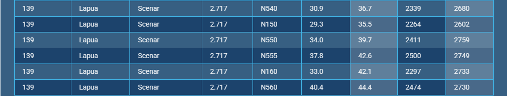

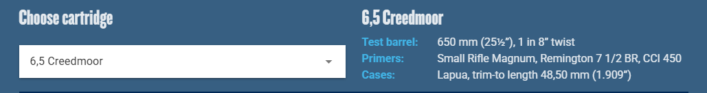

Anyone out there have a good recipe using 139gr Lapua Scenars over H4350 for the 6.5 Creedmoor? The reloading data I was able to find on these bullets did not include the 6.5CM.
I've been running 140gr Hornady A-Max's over 41.5gr of H4350 set back .005" from the lands with pretty good results. Just wanna try something different.

I switched from the 140 Amax to the 139 Scenar in my 6.5-284. Didn't have to change the powder charge, just adjusted seating depth.
