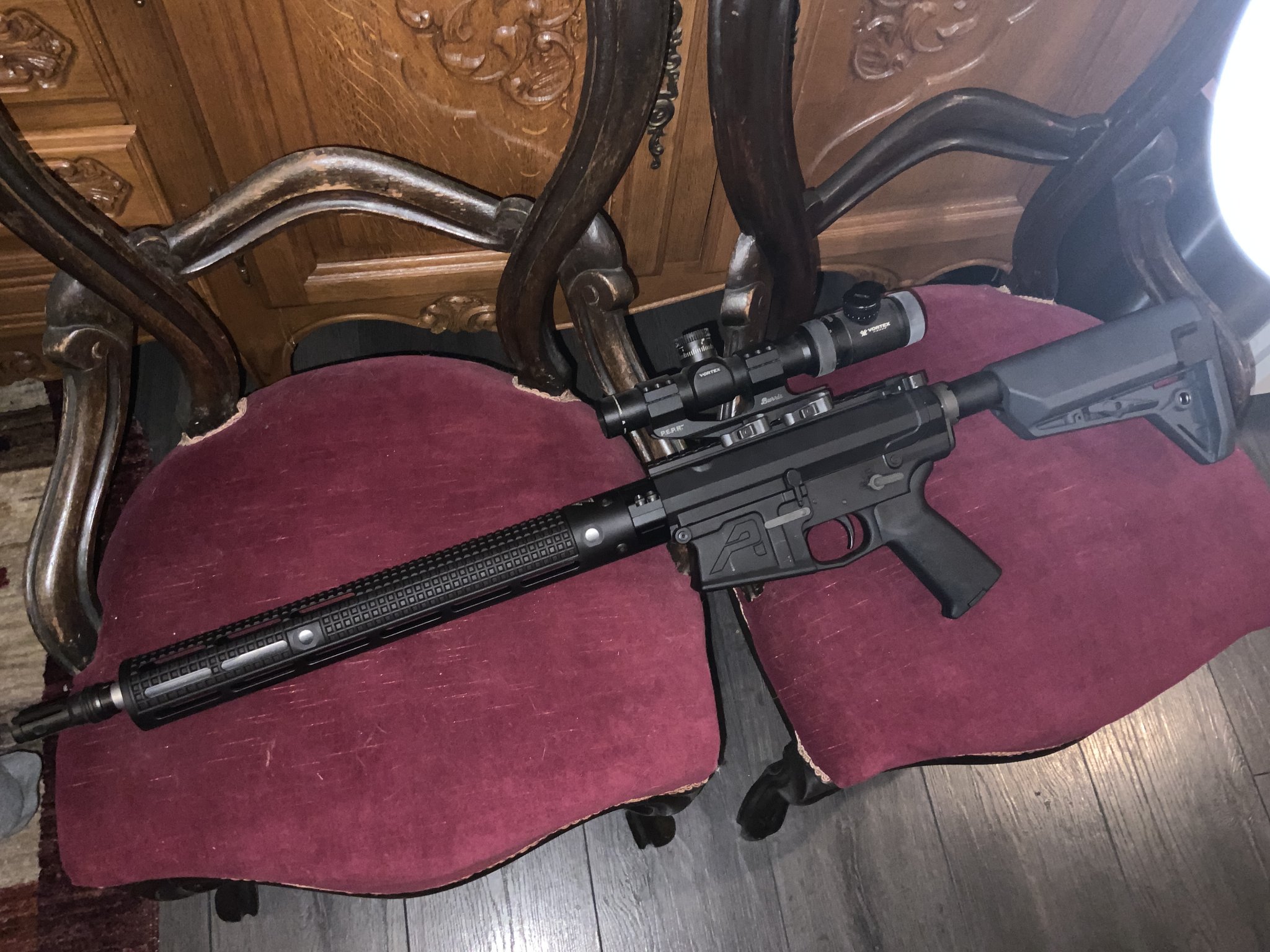

Going with a 16” Wilson Combat Paul Howe fluted recon barrel. Slowly assembling the parts to complete this upper.

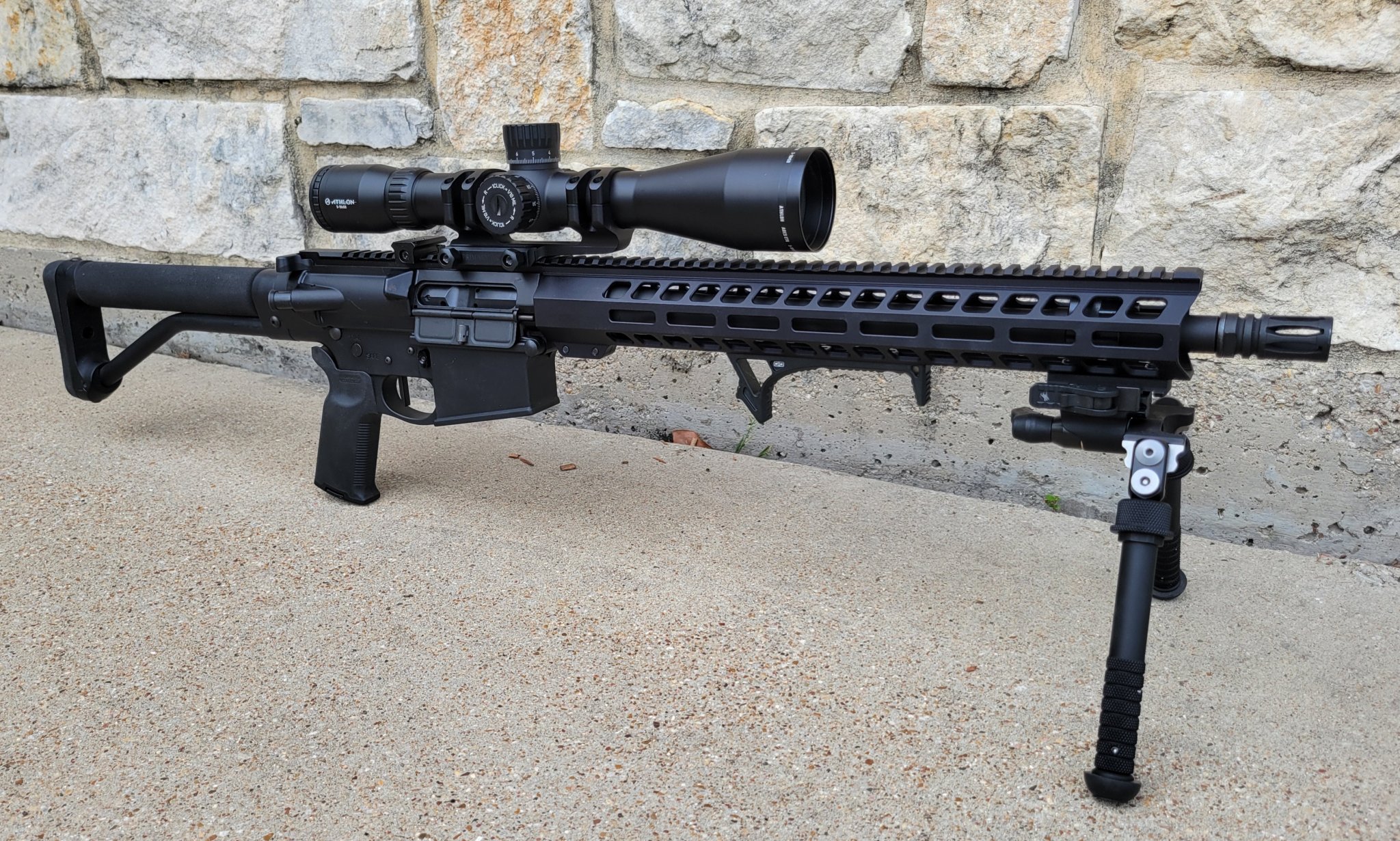

I built one on an Aero M5E1 reciever set and handgaurd. JP BCG with high pressure bolt and faxon 16" big gunner barrel. I haven't found a lighter 16" barrel yet but it is not what I'd call a tack driver either. Sub 2moa but not a moa gun at all. I used an adjustable gas block. If I started over from scratch, I'd go Wilson combat barrel, standard Areo M5 upper, S one 12" handgaurd, and a lightweight JP carrier.

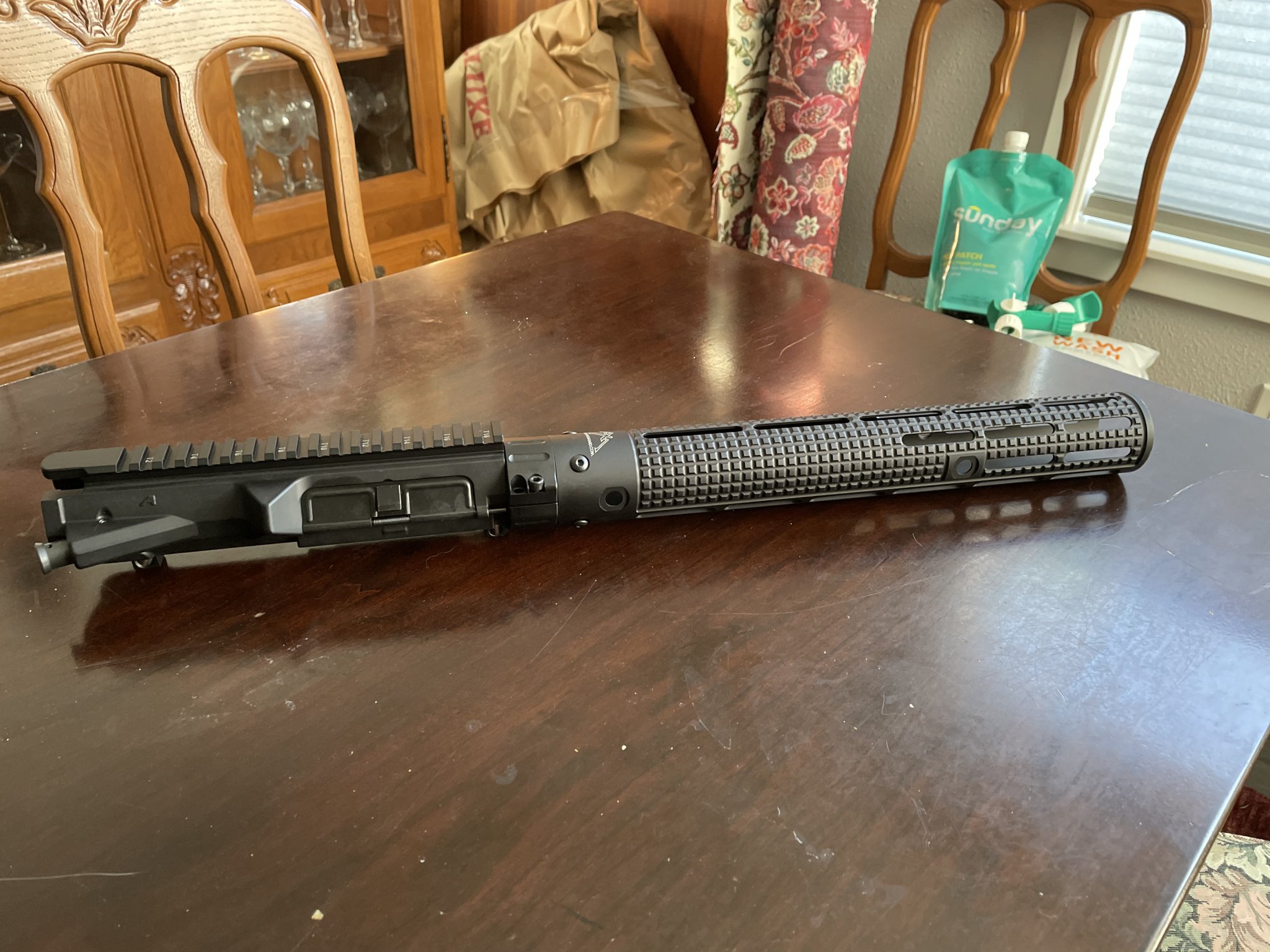

Just mocked up the receiver with the hand guard and I’m getting excited about it!

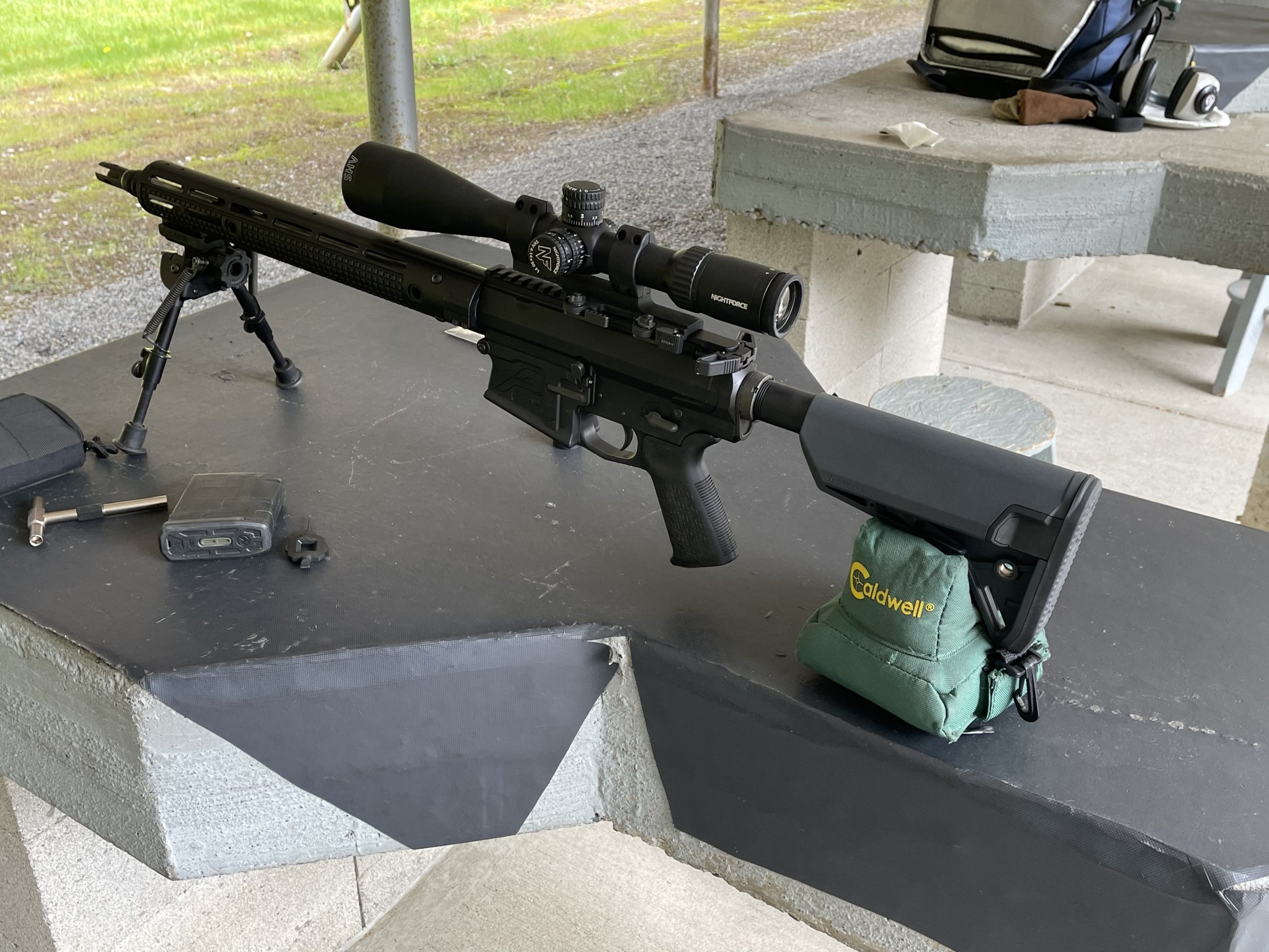

Shot for accuracy today with 130 TGKs. A load of 42.6 grains of IMR 4451 in Hornady brass with a BR2 primer was gettin near MOA at 100 yards. Velocity was 2588 FPS with a SD of 9. I think things will tighten up once I have more than 200 rounds down the barrel. This is a fun rifle to shoot! Will try the same process with IMR 4350 next weekend to see what that combo will do.
