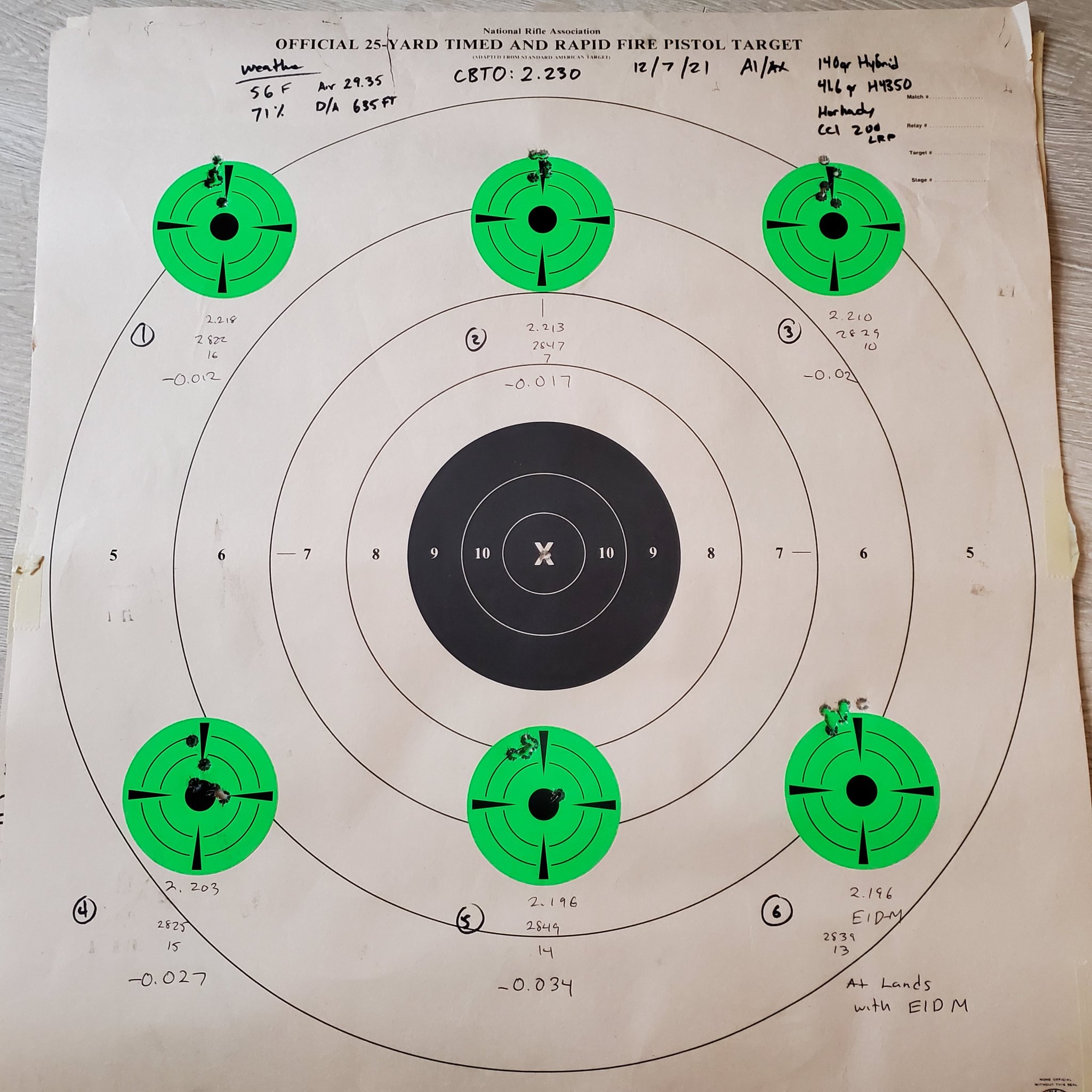

    Assuming this Hornady OAL gauge was correct, my CBTO is 2.230. Tested 12 to 34 thous off. Many articles saying "ah, just start at 20 thou and you're good". Is there any empirical data (your loads) that suggest I should be going 40, 50 60, 70 80 (???) thous off?
    What is impact on seating depth on velocity/SD/accuracy? My SD are not consistent session to session even with the same charge and same depth. Groups are also inconsistent. I can put 3 in a hole one session then 20 minutes later have a scatter graph. Could this inconsistency be a result of me not jumping the Hybrids far enough?

    Here are my results form yesterday's 100 yard session:
    Observations:
    1) Nothing clearly stands out as consistently accurate
    2) I have #5 and #6 where a group with one that is completely off and random >>> SD is aweful on both
    3) Vertical stringing in #1 12 thous and #3 20 thous

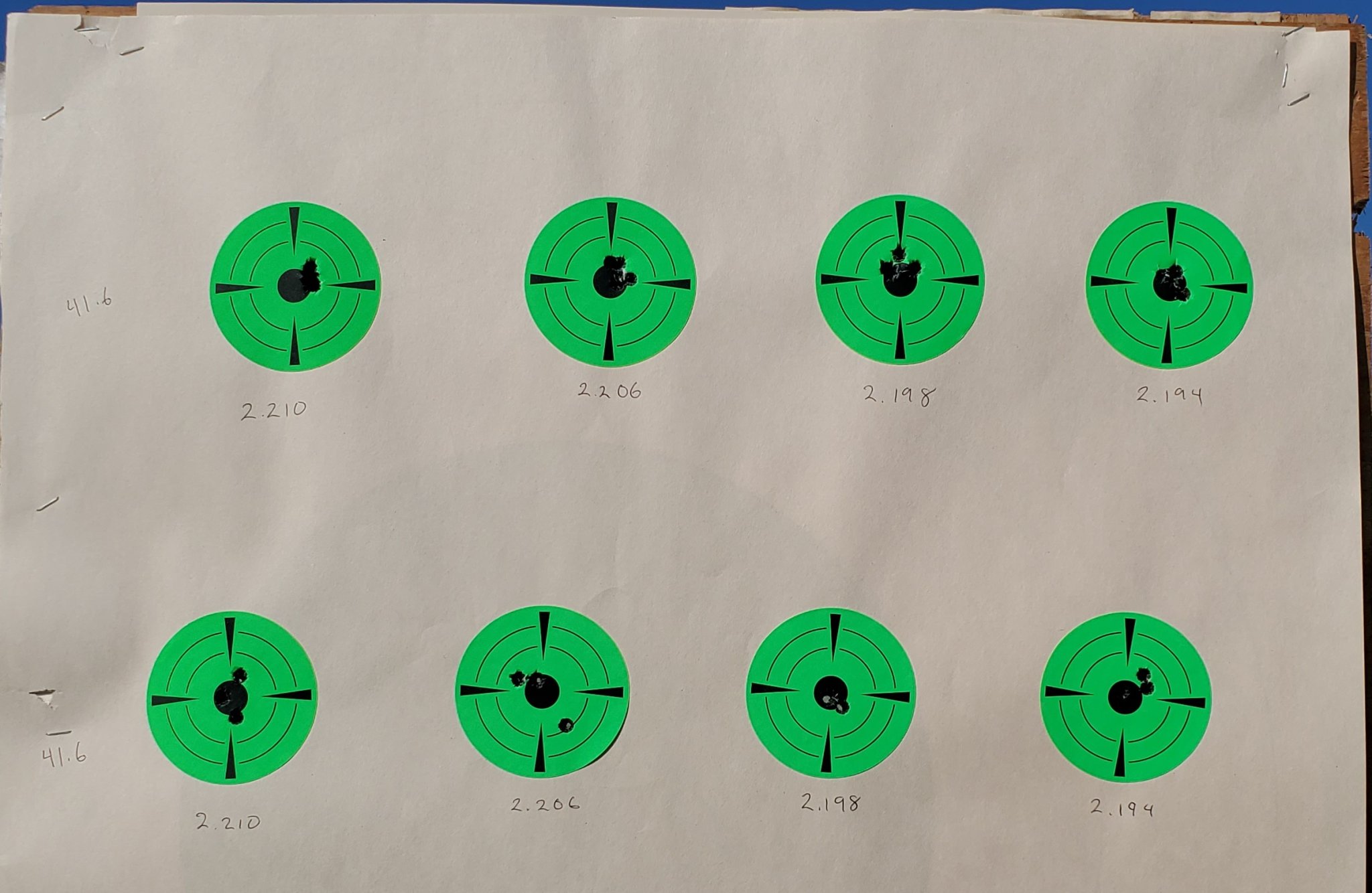

    Besides maybe one or two groups that could just be you, are those groups on the photo above so terrible? Your 2.198 looks like something to work with imo. Try tweaking around with that one.
    You are right.
    At a high level, the 2.196-2.198 seating depth look like something that would be a promising place to start, but it's really hard to know how much is total "fluke" vs. something consistent -- especially when I look at the second pic above vs. the first one.
    I have 2-3 that group then consistently one whacky one that is totally random. My 200 yard group was the same....2 shots .5 MOA than one that opens up 1.5 moa.
    You are right.
    Observations:

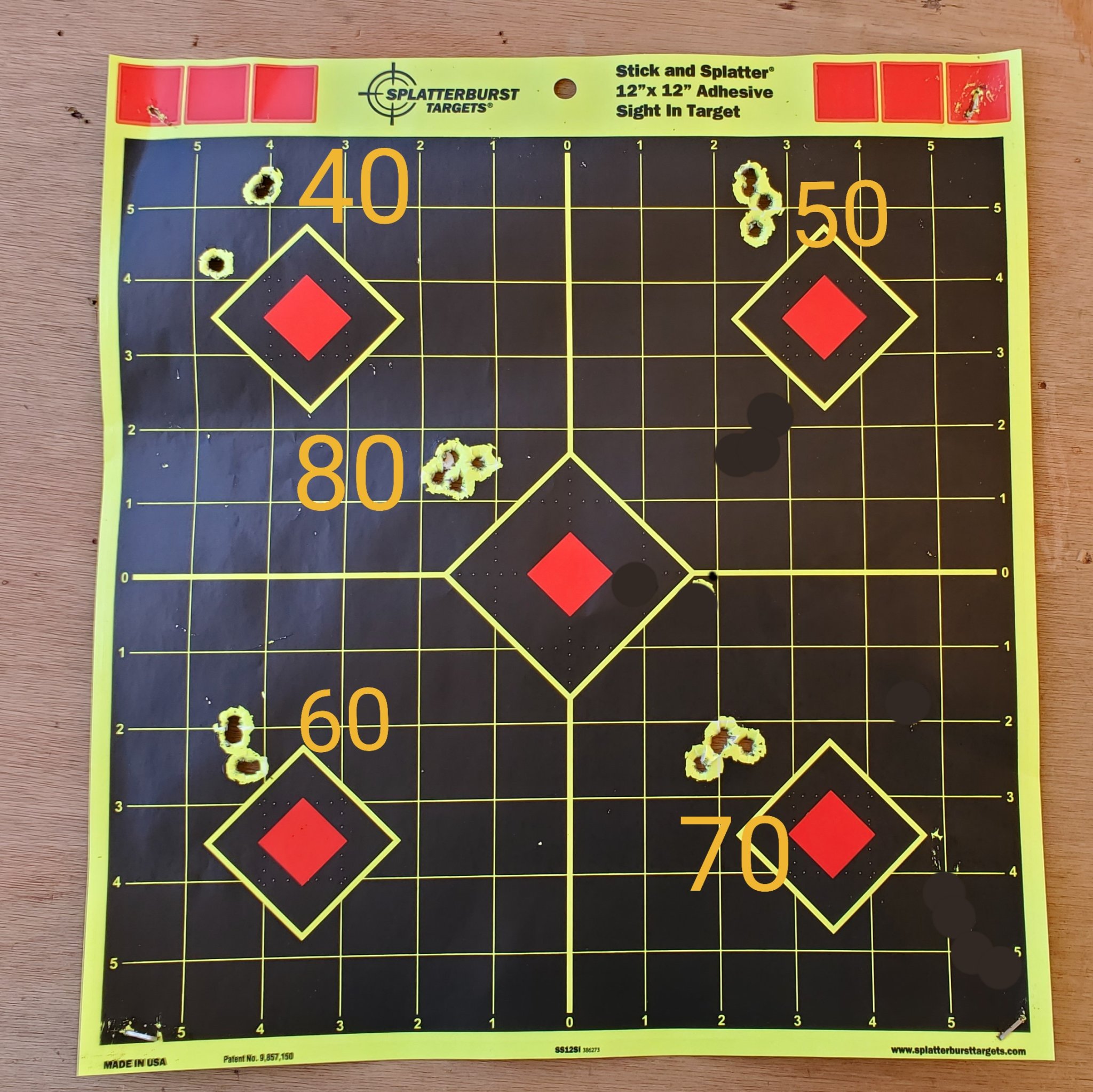

    Appreciate all the input here.
    Went back to the range today with 4-Rounds of H4350 loaded at 41.6gr.
    Seating at 40, 50 60, 70, and 80 off
    Far superior results at longer jumps (with my setup). While 4-Rounds does not make for statistically significant results...I did return single-digit SDs and <0.5 MOA on 70 and 80 off which now gives me a direction to go from here. The "shoot and see" targets also make for "optically" superior looking results vs shooting straight paper targets...so not sure how much had improved.
    I may also load up another group at 40 off because I got 3 in 1 hole and a random flyer. Maybe that was me...maybe not. But its interesting to see that at 40 off in this session and 30 off in past sessions both seem to have a one-hole group and one flyer.
    The vertical stringing at 50 and 60 off is a toss...
