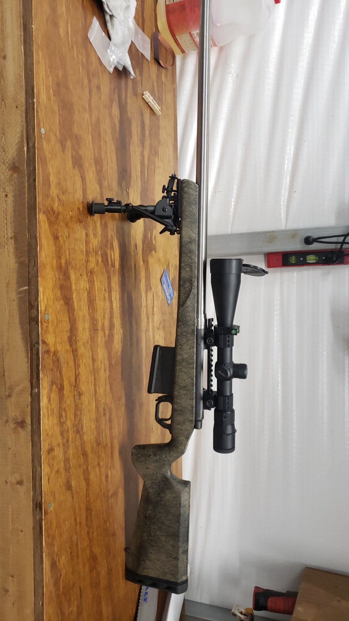

A little update on the build.
The factory barrel was a complete PITA to remove but the new criterion is locked down and ready. I had to do a little grinding to fit the barrel nut into the Stockys Stock so that it is free floated from the recoil lug forward.
Next will be shooting a few rounds followed by load development!

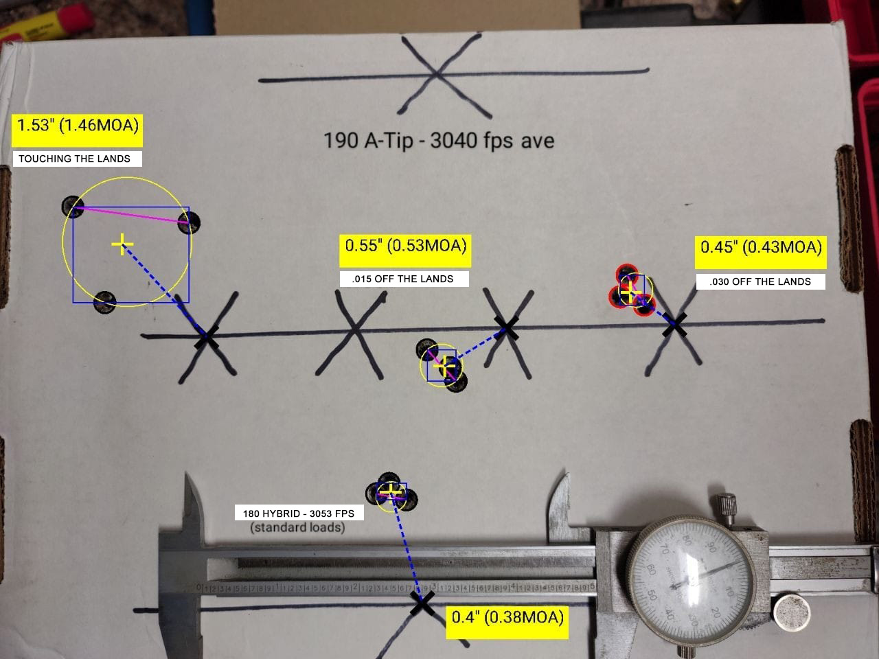

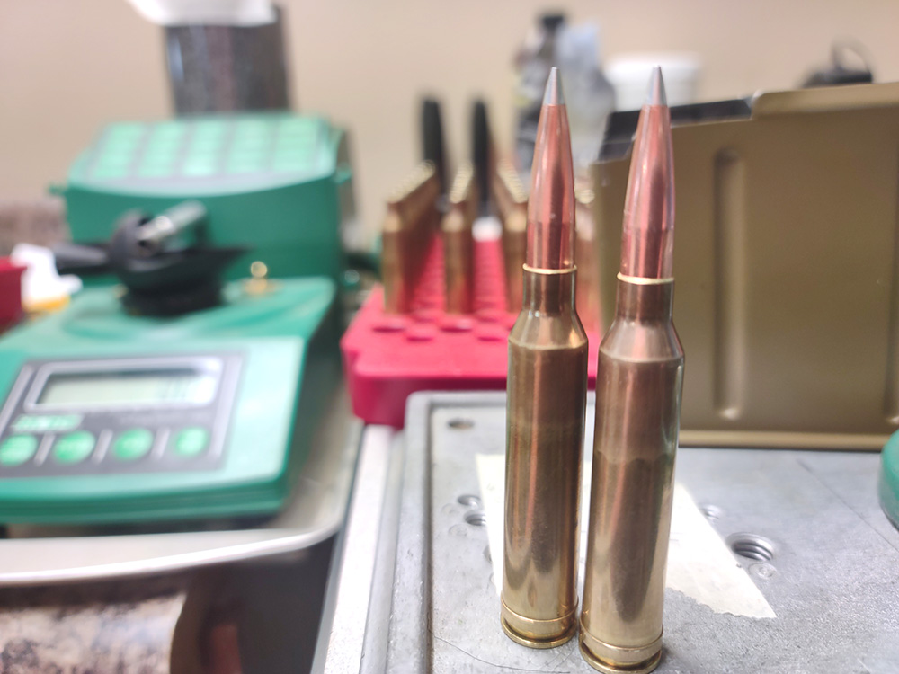

Preliminary testing looks really really nice. Ran 10 shots increasing to find the limit in my rifle. The three groups on top of the photo below was all the same charge, a full 1.4 grain below where I feel my rifles limit is at.

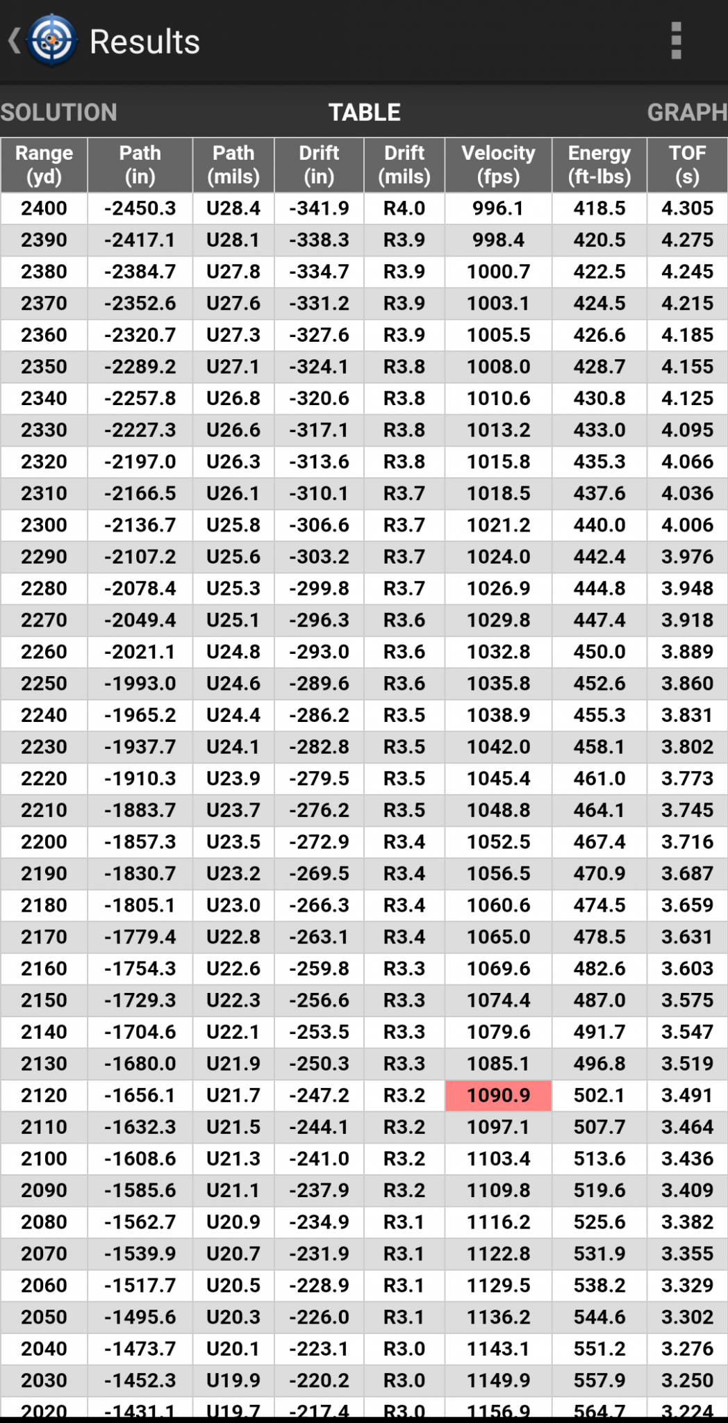

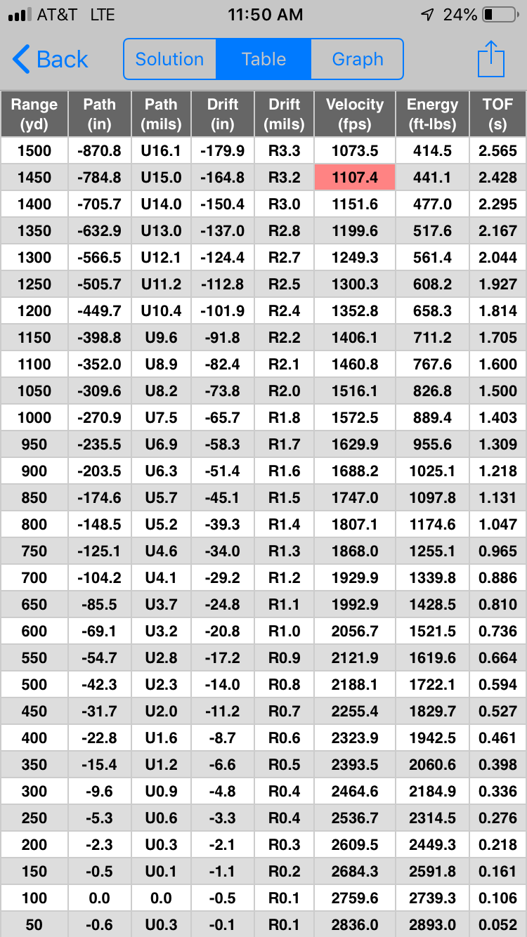

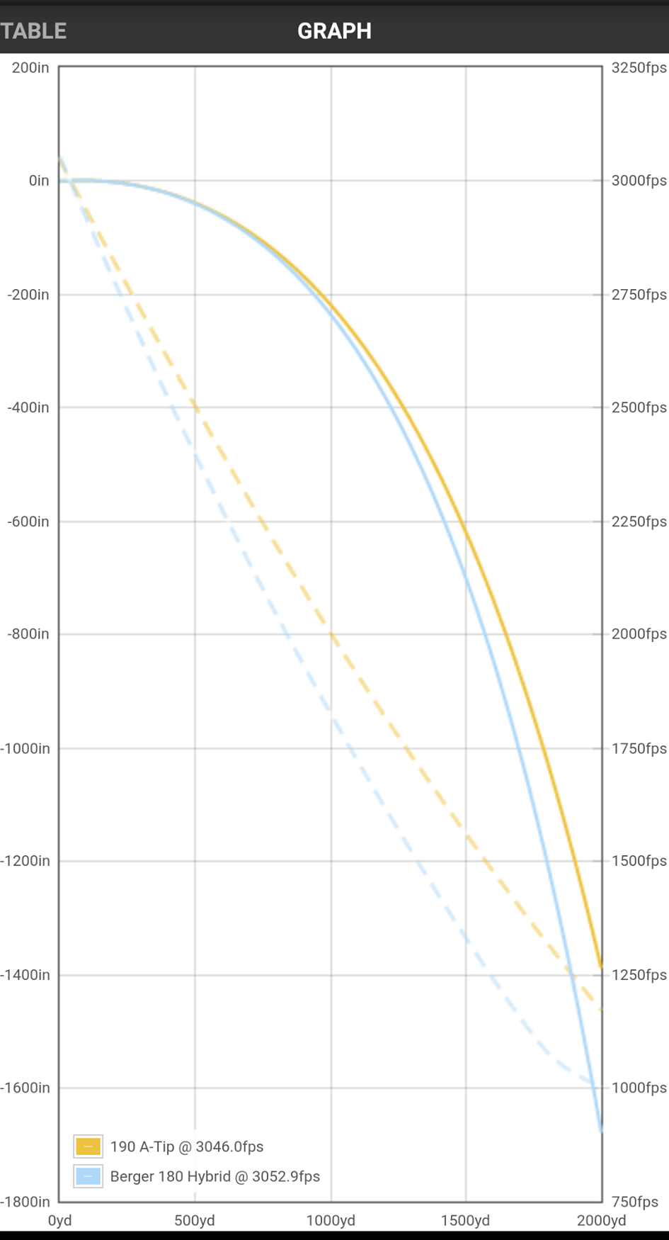

190s look like they will be supersonic till roughly 2100 for me.
180s are supersonic right up to 1 mile

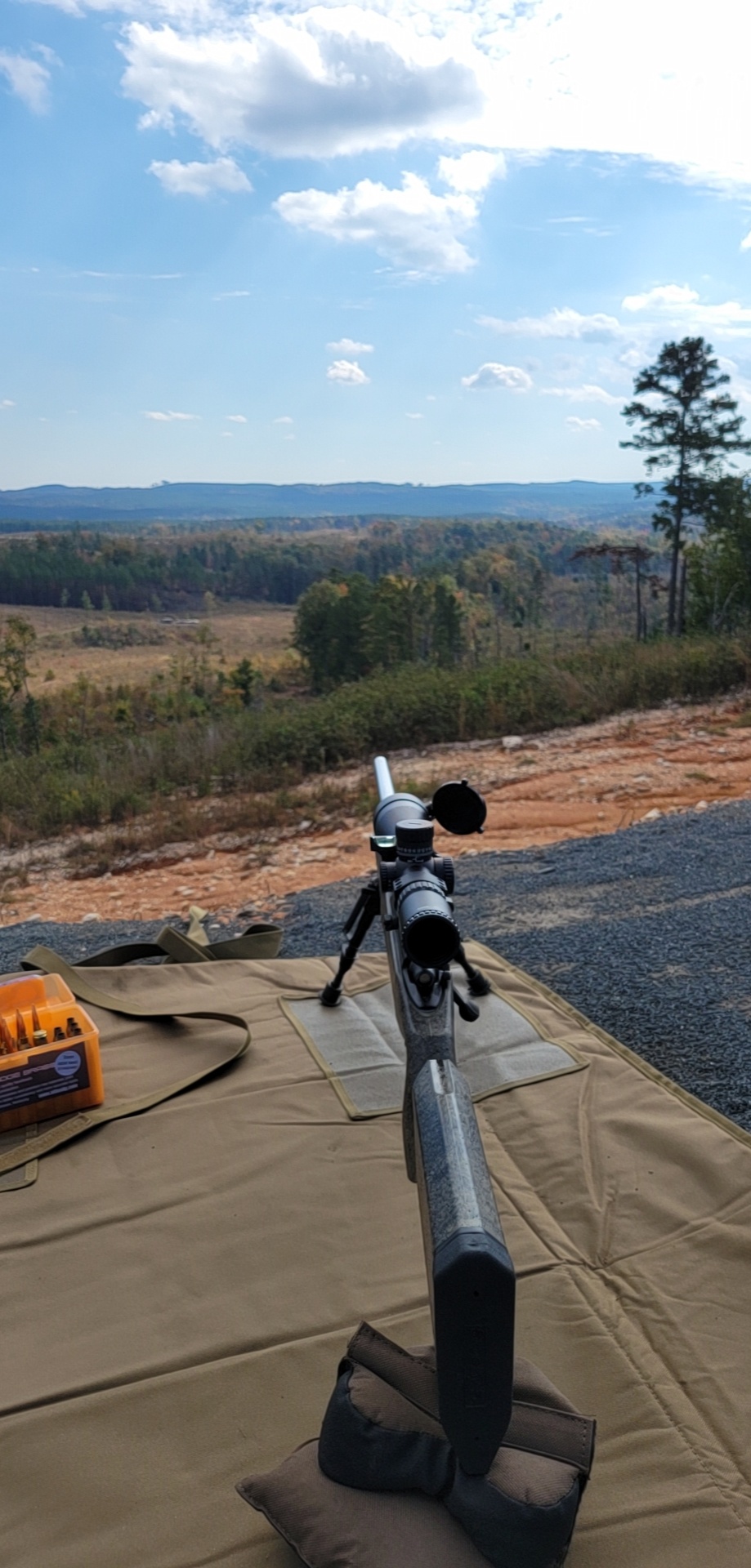

Got out again with the 7 Rem and 195 EOLs today. I was inspired by this thread to go for 1400 but without my spotter there I decided not to waste the ammo (when shooting off my bench I can't see the bottom 2/3 of the target at 1400 because of a hill in the way. Standing with the spotting scope is fine). So I went for my 1147 yard plate. Dialed 8.1 mil up and 0.6 left. First shot on a cold bore was bottom right, sent the next 2 quickly before the wind changed.

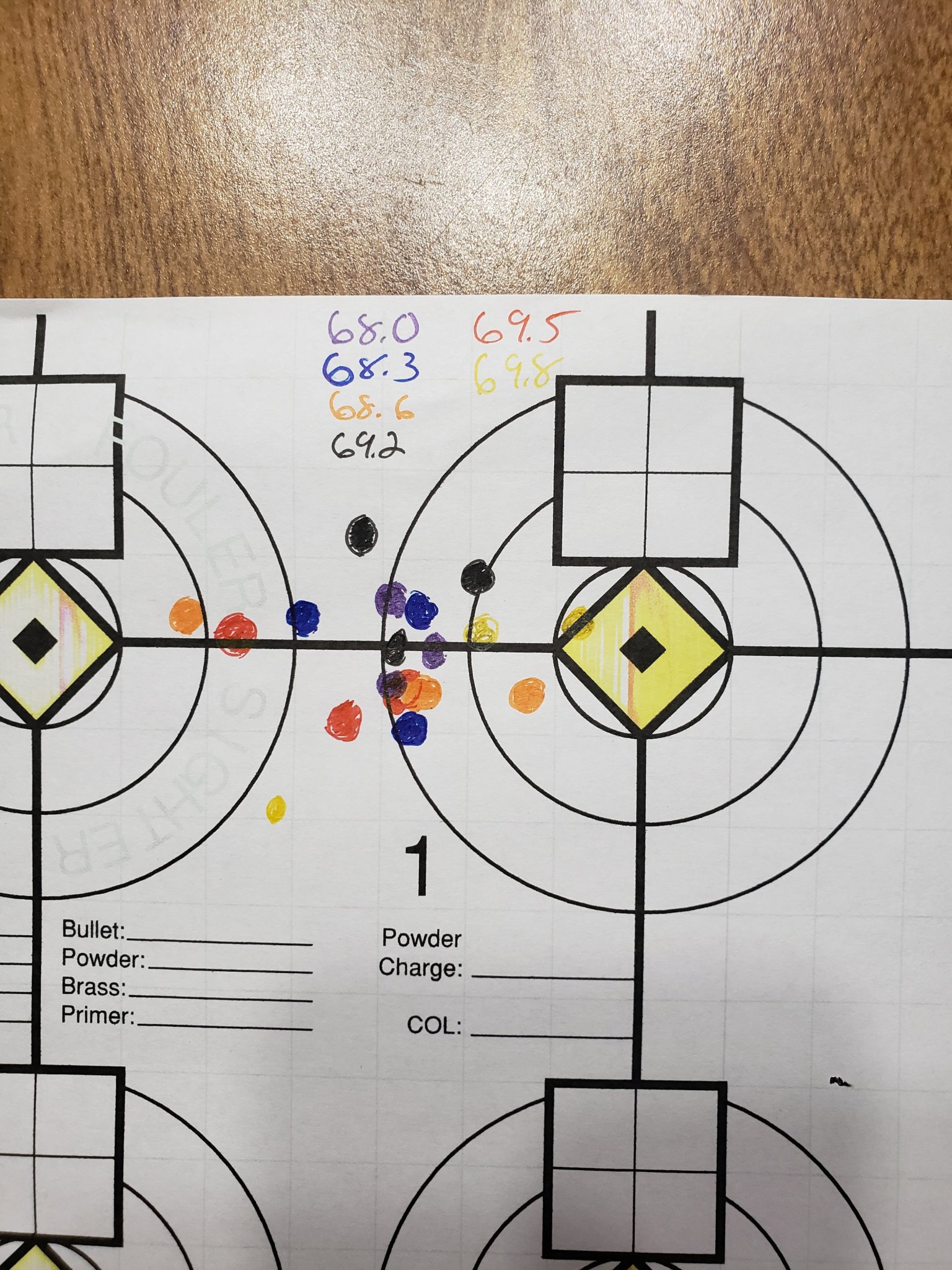

So I have an update. I finally got a very short window to shoot my OCW with 162 ELDX and 7977. I loaded everything at 0.020 off the lands as this is what my previous barrel liked and I needed a standard for depth. This has been done with brand new brass that as been run though my FL die to get the necks consistent.This is the first time I have shot this gun prior to a few rounds for break in and everything was done at 100yards on the targets shown.
My understanding would be I need to stick with the 69.5 charge as 69.2-69.8 seems to have the same POI and group size. I can mess with setting depth next, according to the books 69.5 of 7977 is max charge but I didn't see any pressure signs or hard bolt lift. What are your thoughts?
That is a beautiful look stock and overall rifle. Let us know how those projectiles work for you.

@warnera1102 - my personal thoughts are:
1. choose accuracy over speed
2. decide up front if you're gonna "hot rod" - you might not see the pressure, but you can't make velocity without it
If you've got a flat spot/plateau/node in our ladder around 69.5, definitely play with your seating depth and see what you get! Sounds like you're on the right track. What did you see for velocity? Did I miss that?
Here are my average velocities, I don't know how the explain the average up and down at 68.6 @ 69.8
68.0- 2905
68.3- 2931
68.6- 2909
68.9- 2939
69.2- 2984
69.5- 2981
69.8- 2970
Yeah...don't know if that's us or the nature for things...I see that as well. 66.1 w/ RL23 and 64.6 w/ H4831sc to point out two in my own data.

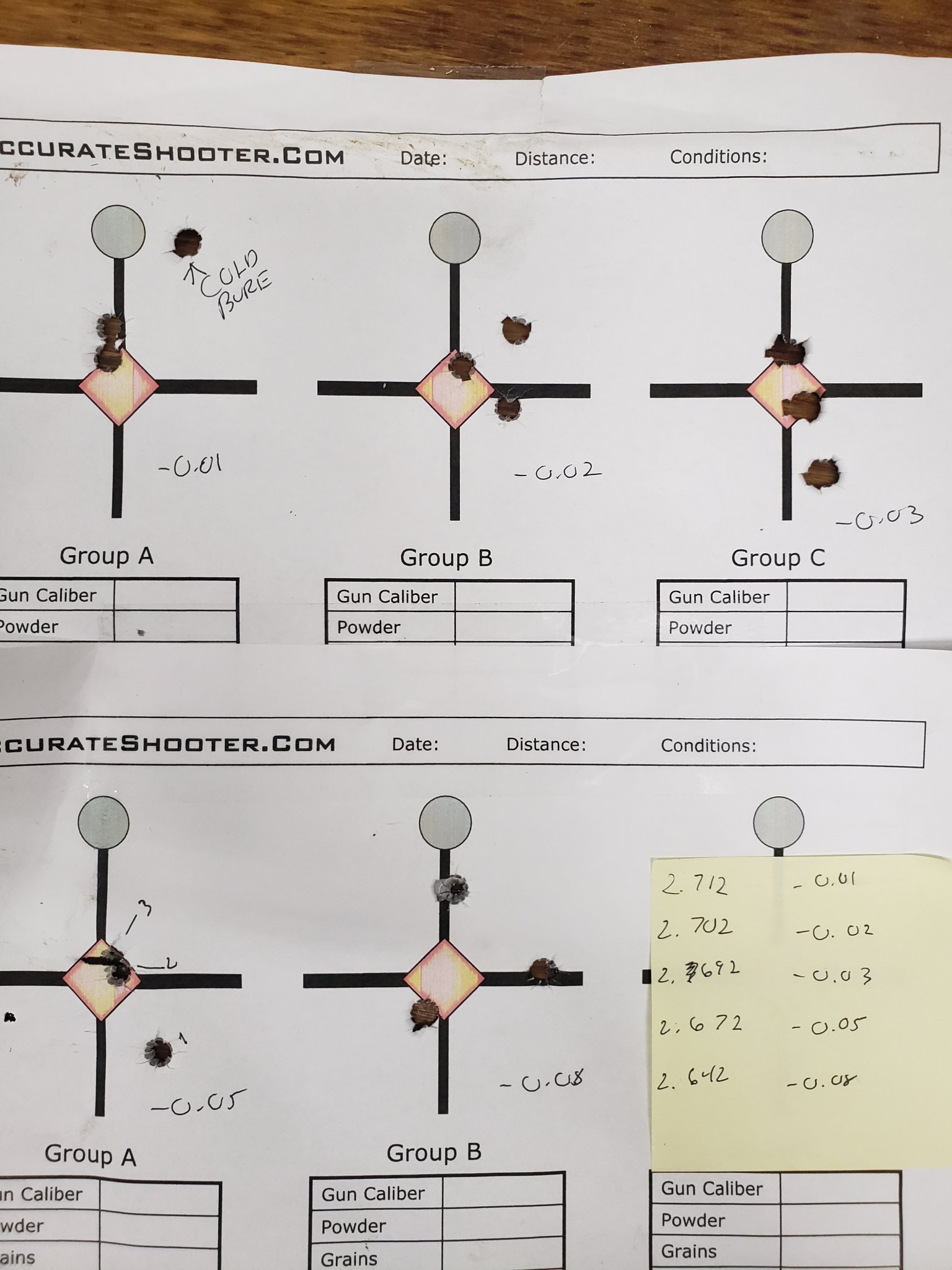

A little update. I was able to sneak out of the house for do my seating depth test. Here are the results, I did screw up and forget my cheap loads I use for cold bore so that kinda messed up my -0.010 test. I'm thinking of trying the -0.010 and -0.050 depths again.
Now my shooting platform is the bed of my truck so I feel that has a little play in this.

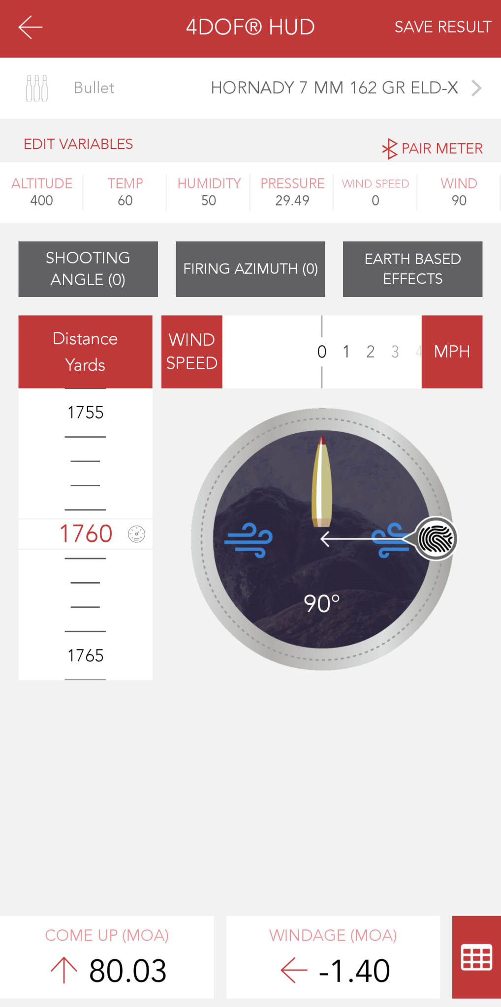

That makes me feel a little better, I need to figure out how to "true" the app. Out of curiosity, I typically shoot at sea level (eastern NC ) but yesteday was done at Coleman Creek in NC which I assume the elevation is like 400ft. How much do you think my data will change just due to elevation change from there to sea level?
162 eldx at 2850 gives this for the altitude change (1.4 moa or 0.4 mils). You also have some other earth based effects that can make a difference at those ranges, as can wind.
