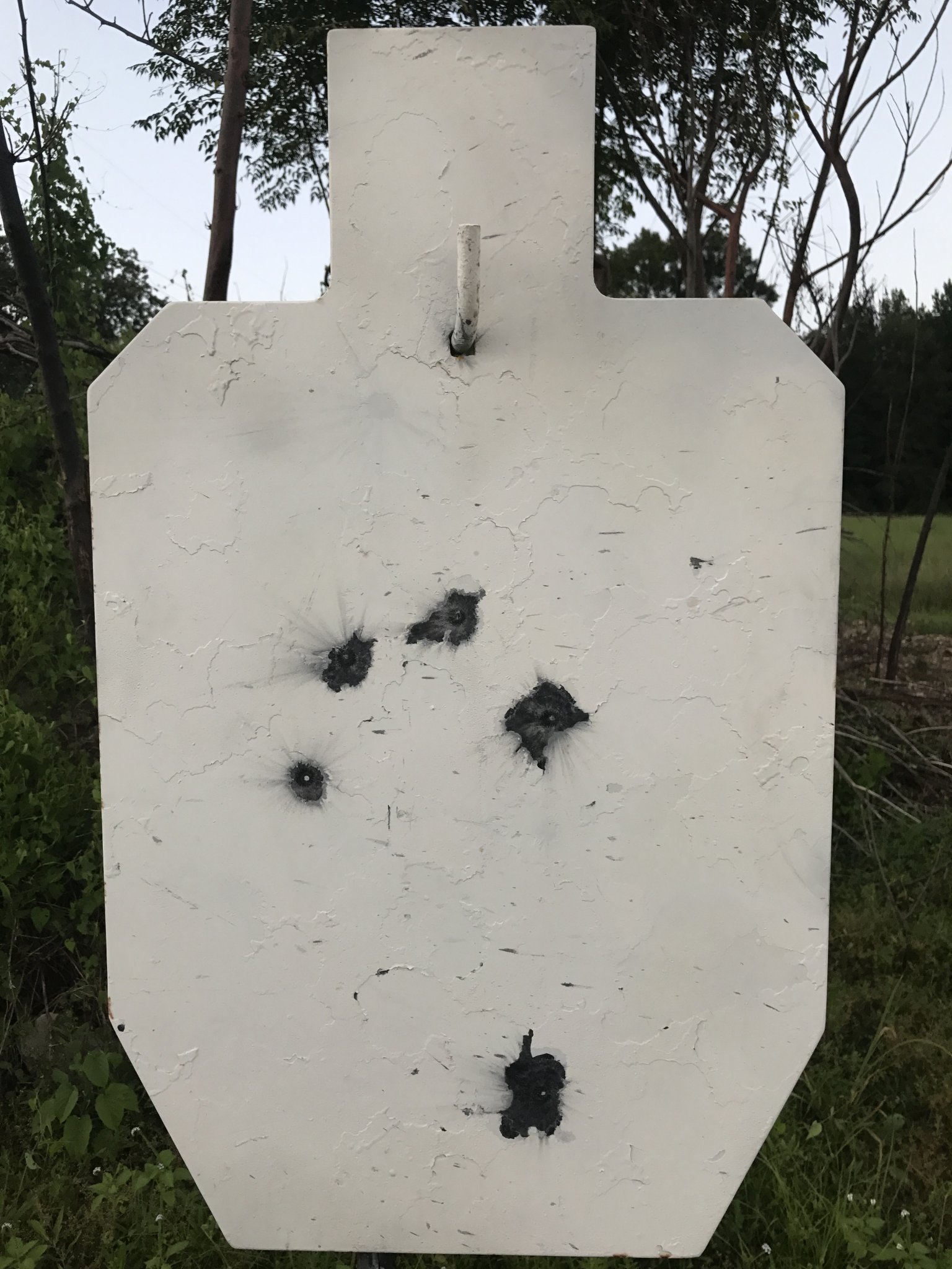

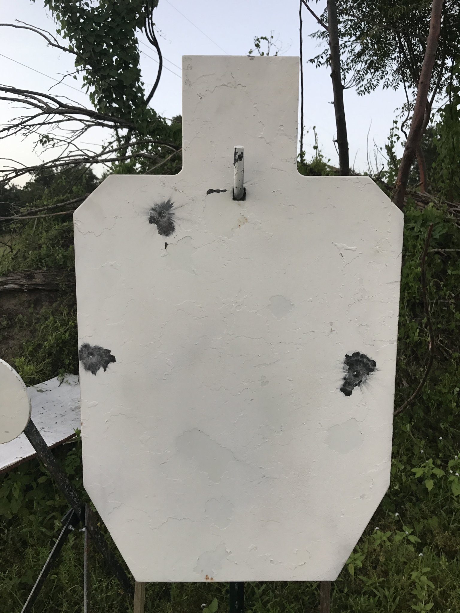

@A5scott: I found pics of one of several side x side tests I did at 1330. 3/5 with 147s, 5/5 with 140s. The group size is even more telling than the hit ratio. These are separate pics, but the two targets are hanging side x side about 18” apart. I should have taken one with both targets in frame.
