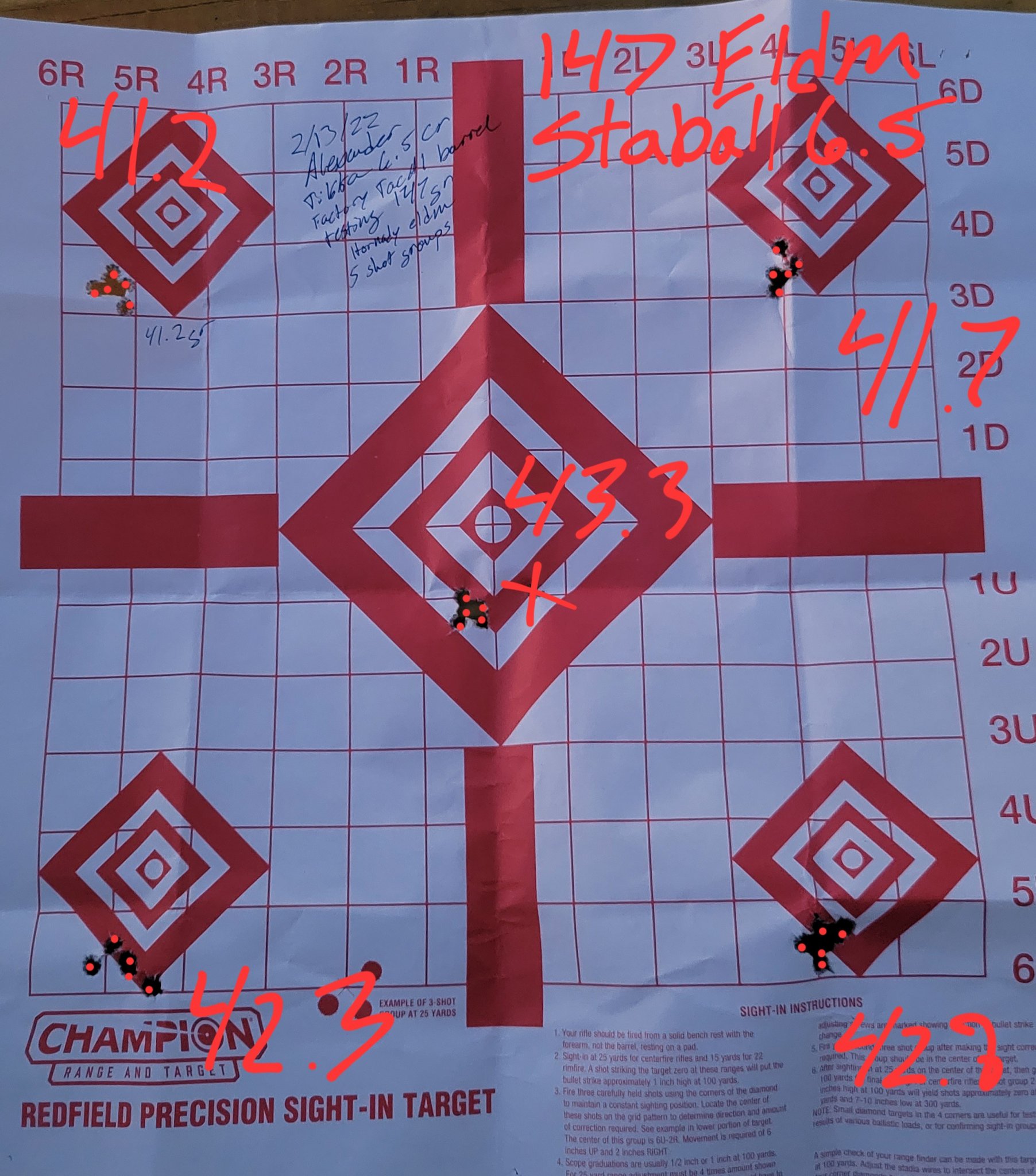

I posted about this awhile back due to my confusion in another thread. These bullets would group great with 43.3 gr of Staball at 100m. But they would blow up in flight or destabilize after 300m when I tested them on paper. This was with a 1:8 twist barrel, which should be entirely adequate to stabilize this bullet.
I moved back to shooting 140gr Sierras, it wasn't worth the trouble to deal with the 147s. The consensus seems to be that there are inconsistencies between lots and you don't know what you'll get. Called hornady and was told they hadn't heard this was a problem. I don't have enough free time or money to waste on bullets I have questionable confidence in.
100m 5 shot load test target

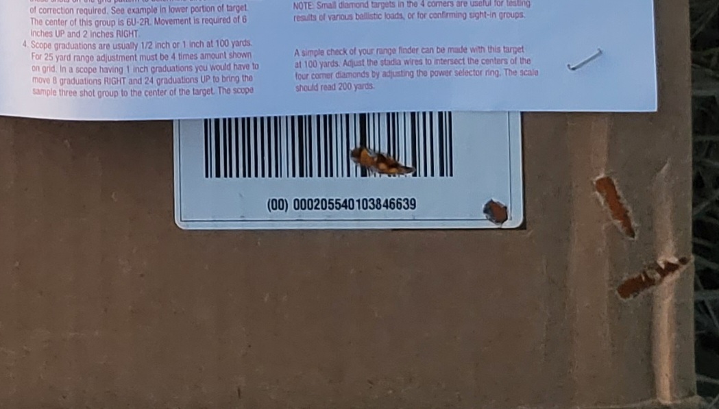

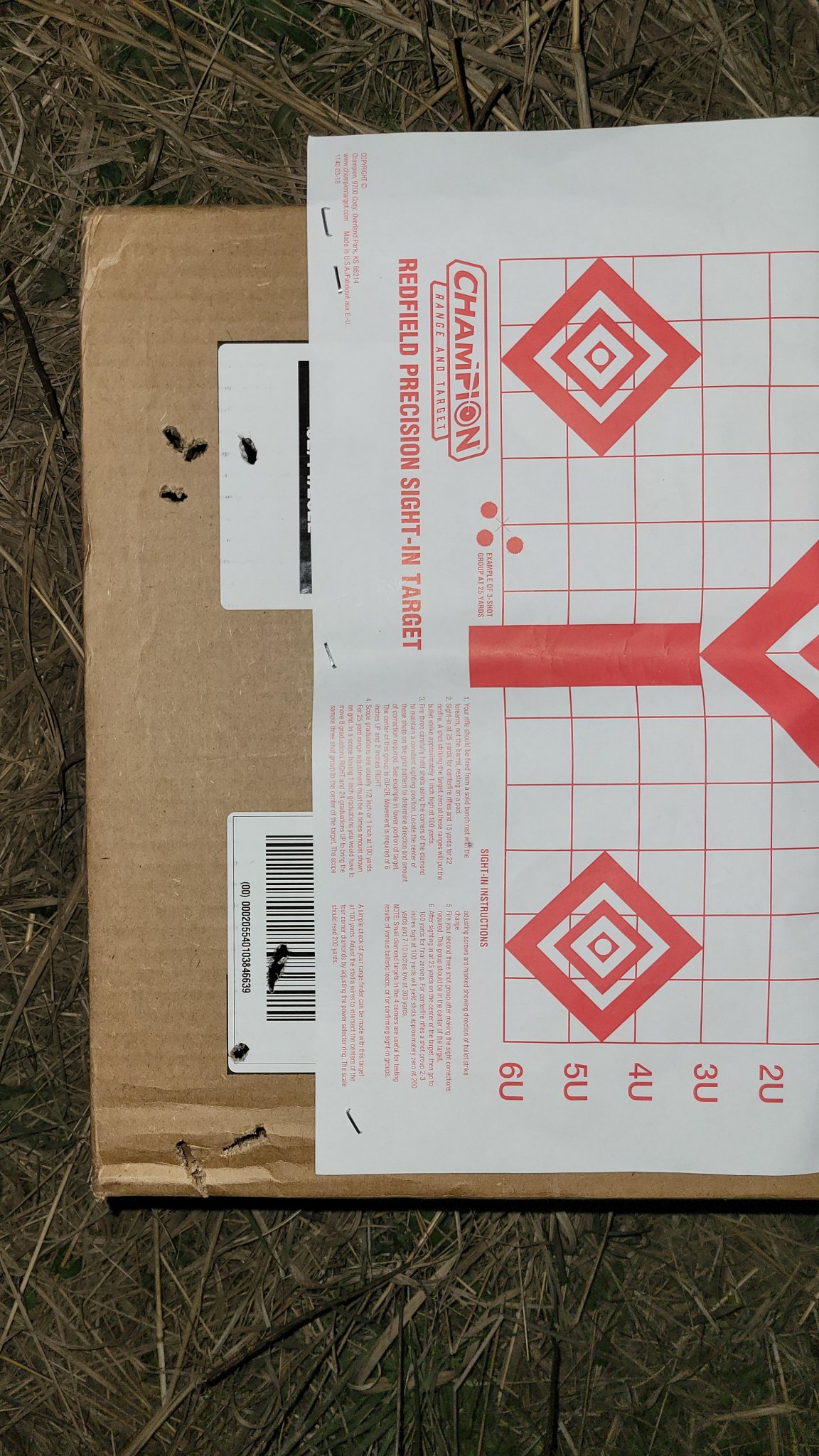

These were shot at 300m to verify drop the next day using the 43.3gr load. Each group was 5 shots, 1 blew up in each 5.
