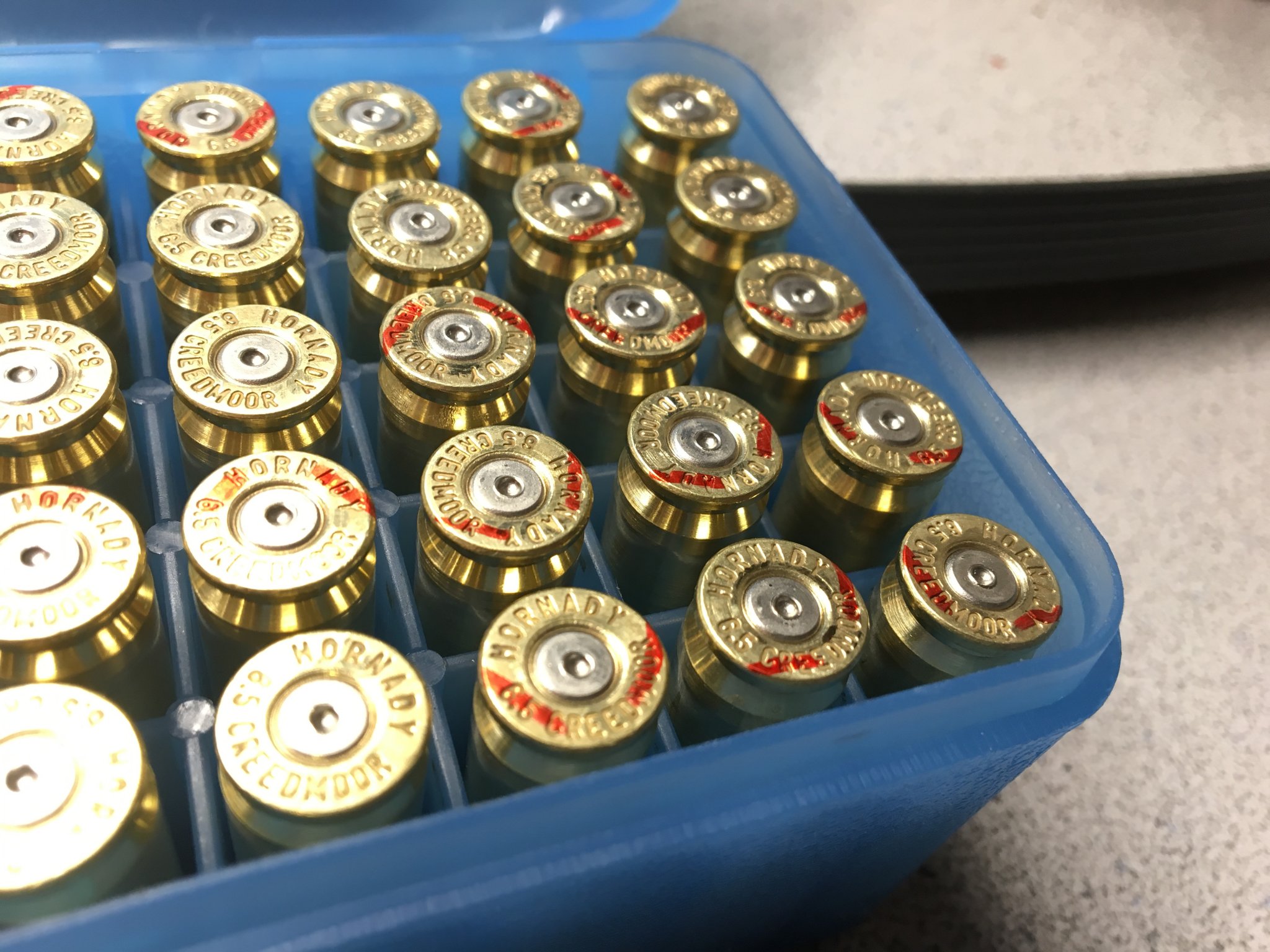

I just noticed something possibly positive when resizing the brass. I had to resize 41 pieces that were fired with my normal load of 42.2gr of H4350 with 140gr ELDs as well as the 9 that were tested with the Reloader 26 and 147gr ELD. The 41 pieces had more resistance and took more effort to resize compared to the 9. I thought it would be the opposite.

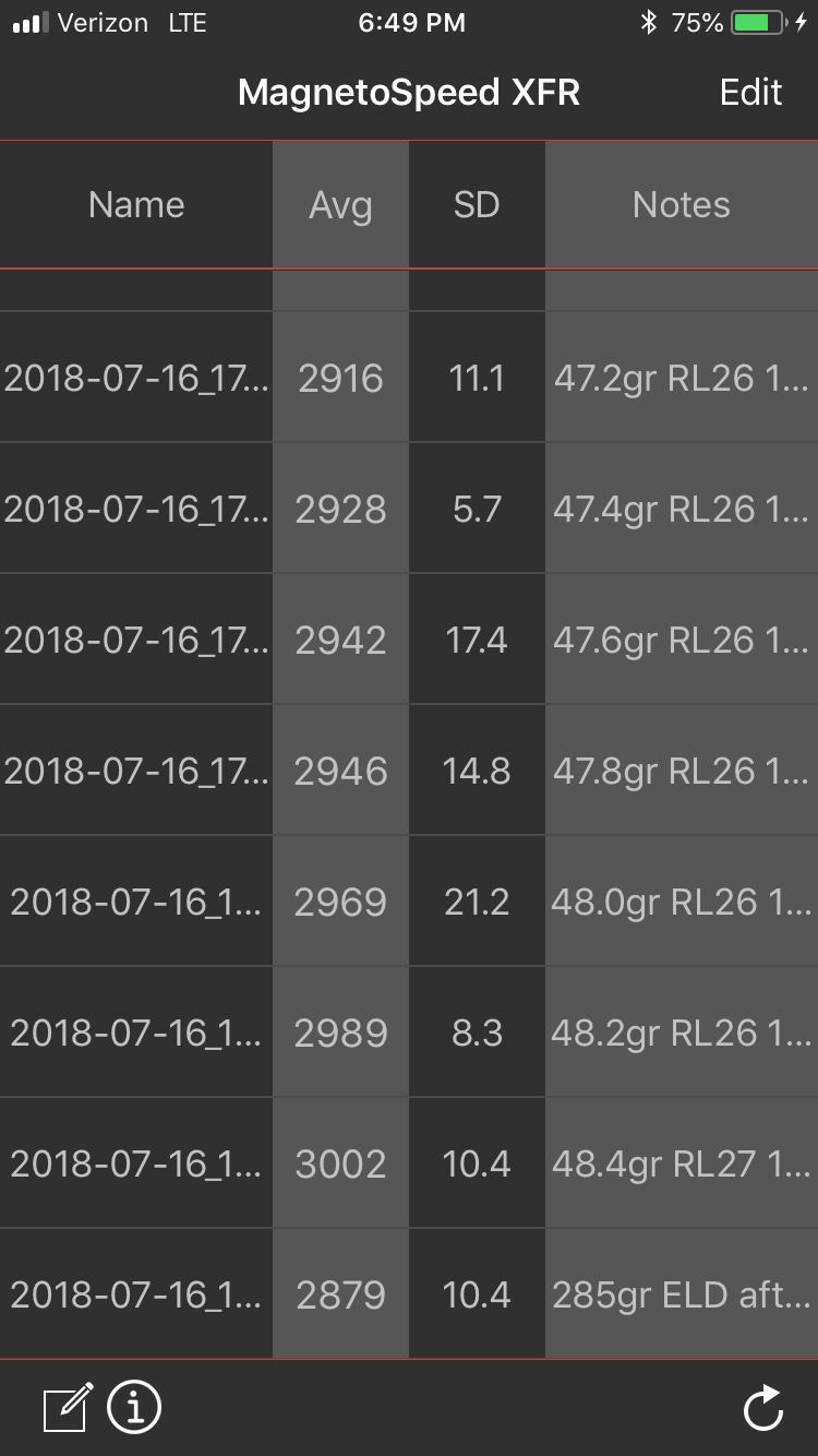

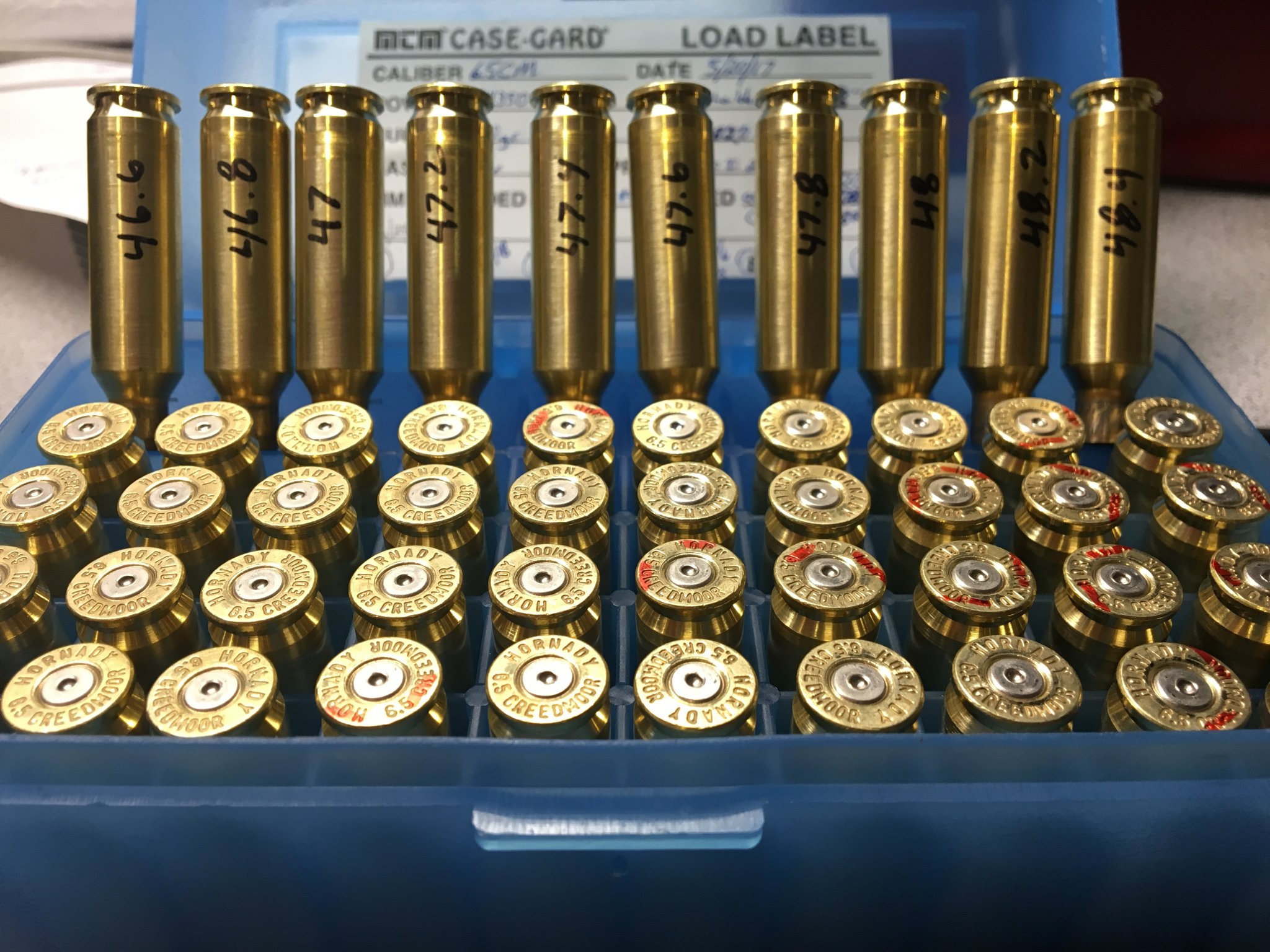

Here are the results of today’s test starting at 46.6gr and pushing up to 48.4gr of Reloader 26. All 5 shot groups at 100 meters. I needed to vibrate settle the powder on the higher charges so to make it consistent I vibrated all the charges. Started to see ever so faint ejector rings half way through the charge range that are indicated between the red marks. Primers all look decent and no different than my normal load with 42.2gr of H4350 and 140gr ELDs. Never had a stick bolt. I think I’m going to pick 47.4gr and try a few vibrate settled and a few with a normal pour.

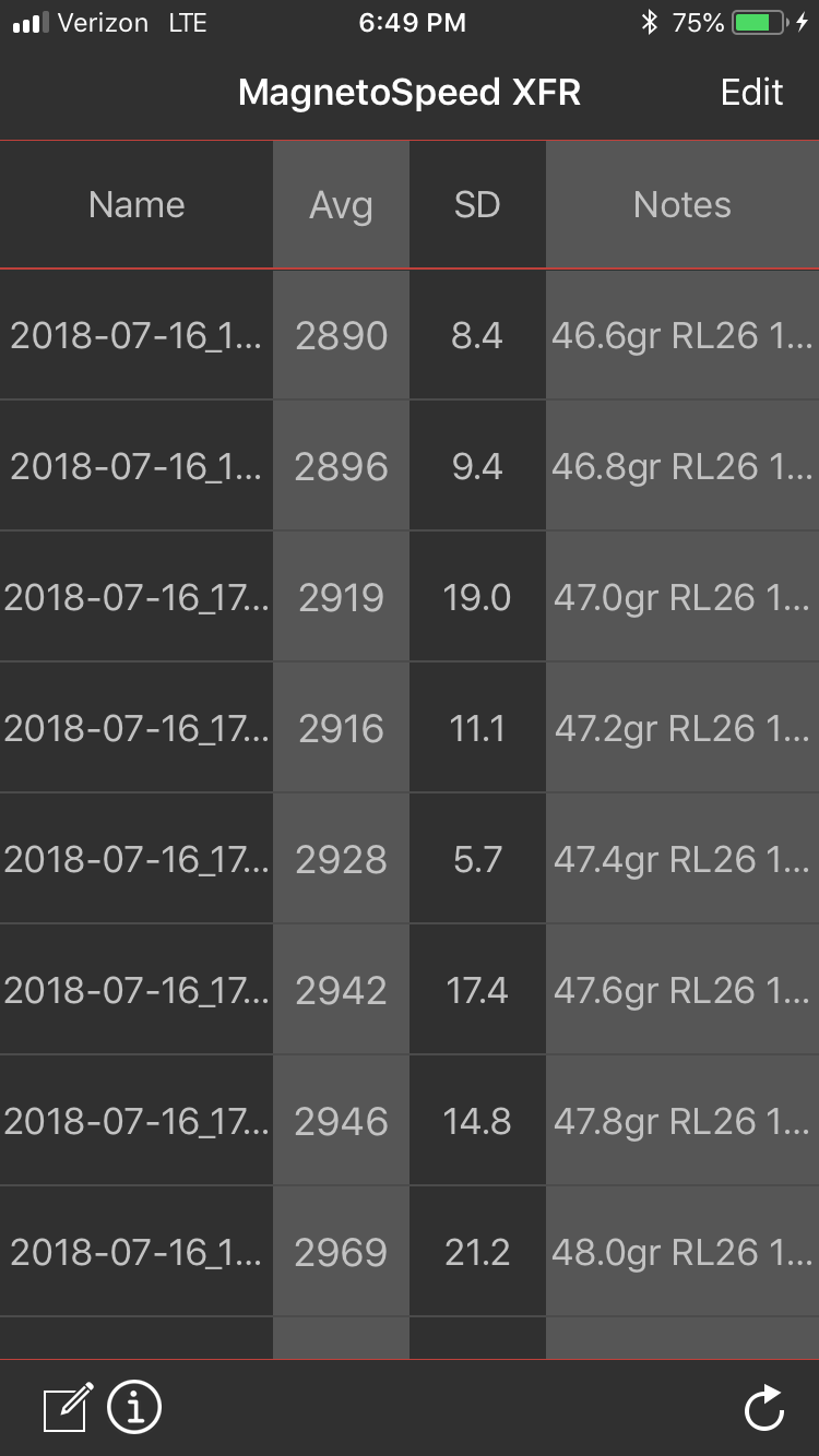

Here screen shots of the Magnetospeed Incase the speeds and SDs are hard to read.
That 47.0-47.2 area is nice and flat, and also coincides with a velocity flat spot. I don’t think I’d wanna operate so close to ejector marks at 47.4, especially with Hornady brass. Wouldn’t surprise me if some of those upper charges hurt the pockets.

I decided to try these loads with Hornady brass that has been loaded 10 times when I get done loading them this week. This should help give me an idea fair soon if the primer pockets shit the bed or not. If they do, I’m not out on wasted brass.

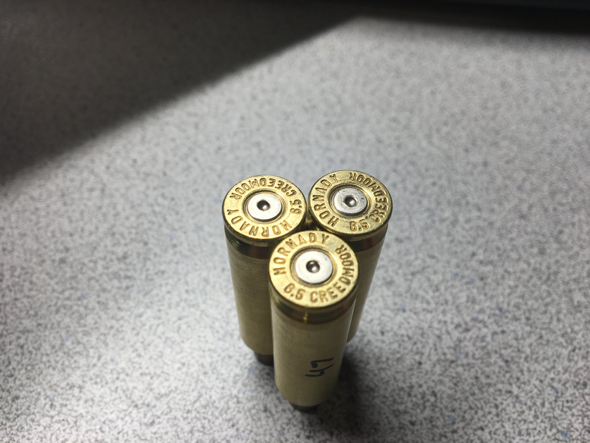

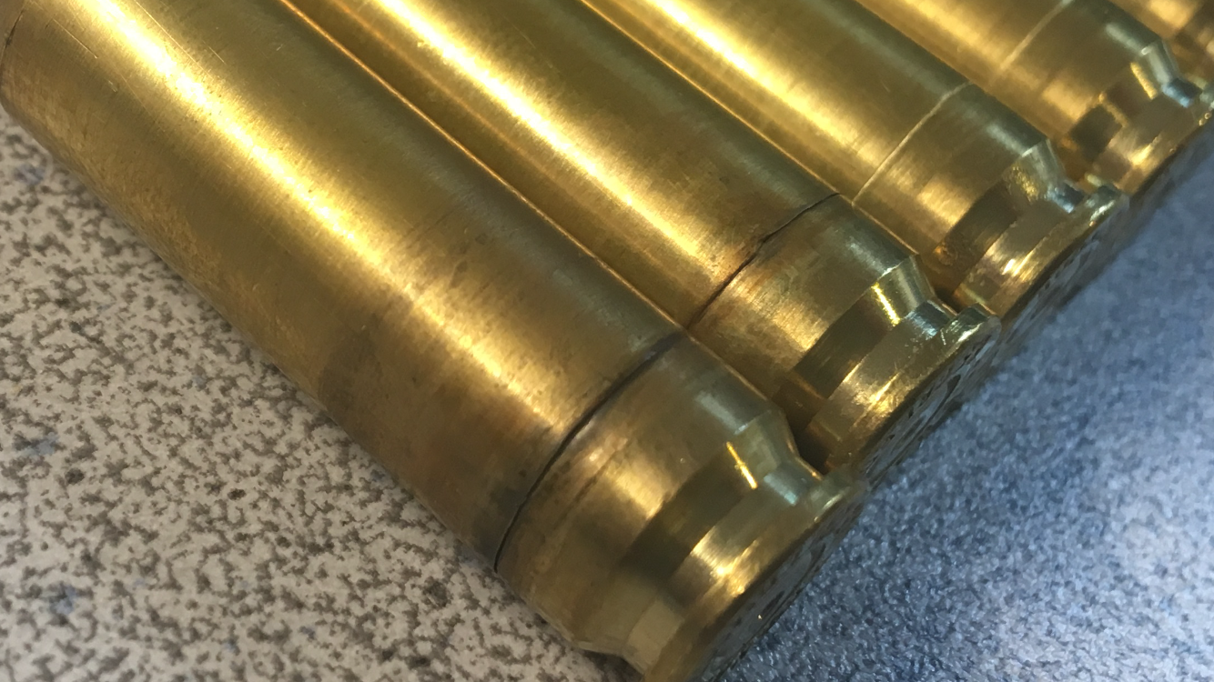

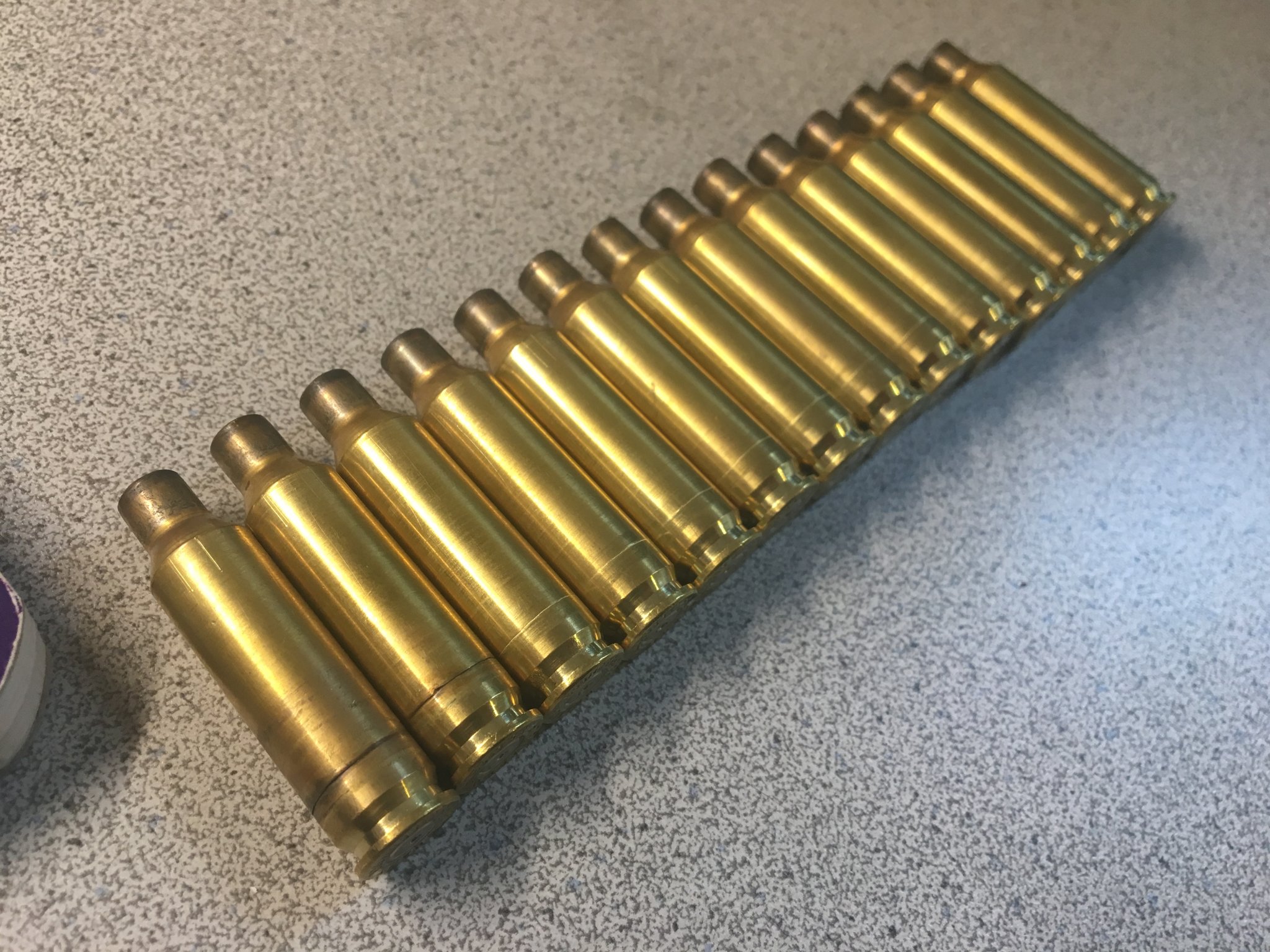

The bad news is the case head separtations on 2 and the the obvious start on another 12. It doesn’t surprise me but I’m not 100% certain it’s the load or the fact it’s Hornady brass that has been shot 11 times or a combination of the two.
I have another 50 that is on its 9th reloading so I’m going to continue to shoot that until failure of some sort.
If it was the load, the primer pockets would have told you many firings ago. Pressure doesn’t cause separations anyway. You’re doing pretty good with hornady brass I’d say. Just go easier on the shoulder bump when you switch to new stuff.
Edit: 11 firings with hornady, at that performance level is good! Keep on trucking with new hornady, or switch to Lapua.

That's usually from bumping the shoulder too much when sizing. Do you measure the bump and set your dies to only bump .001-002"?
Most people seem to struggle for double digit firings on them. Certainly it can be done, but not at the performance levels most are seeking around here. The real question is would they have failed if you’d stayed with your h4350 load? I think yes.
Religiously bump the shoulder 0.002” every reload. Anneal every other firing. 0.001” neck tension as well.

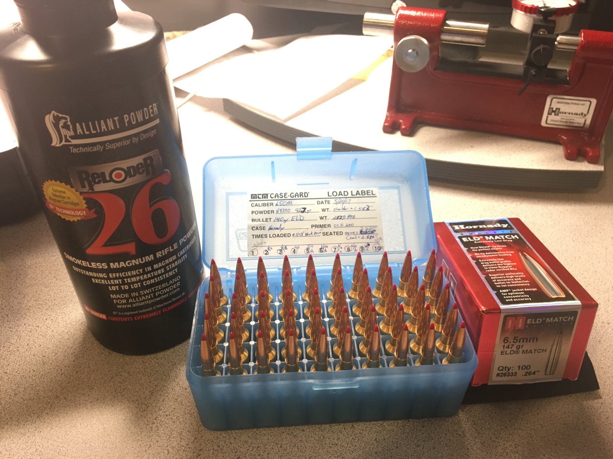

Anyway, I loaded 50 rounds of 6.5CM with 147s over 45.5g of RL26. Fits easily, and I knew it would be safe pressure wise. Ran at 2810fps consistently, but didn’t note the SD because I was in a hurry. Won’t do that again.
Anyway, I’m happy and while I’m sure I can stuff another grain or so of powder on top, I may leave it and just enjoy having a solid round with above average ballistics.
