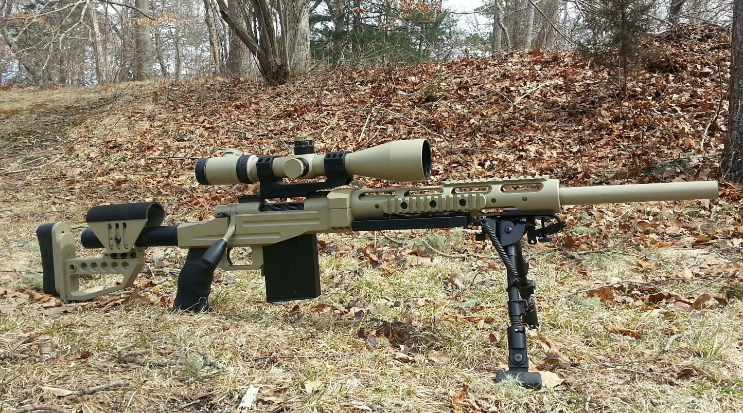

Howa 1500 action, $600, XLR chassis $750, Harris Bipod $100, 10 round AICS mag, $70. Put this together for my wife and it keeps up with my customized rifles.

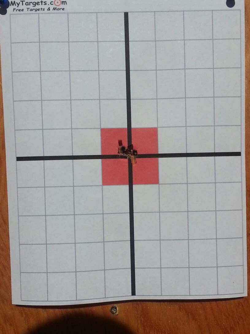

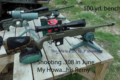

My howa .308
This is my .308 and it is truly a 1/4 to 1/3 minute shooter
The following is what I've done to it.

and the most important part of the equation 2,782 logged rounds
Lets see some more from the hill country
