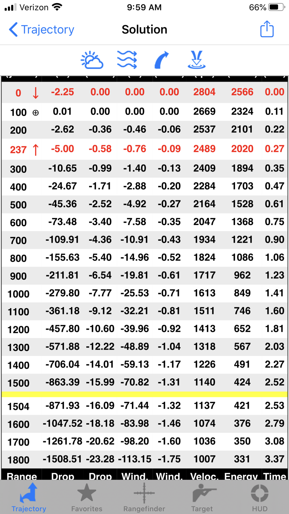

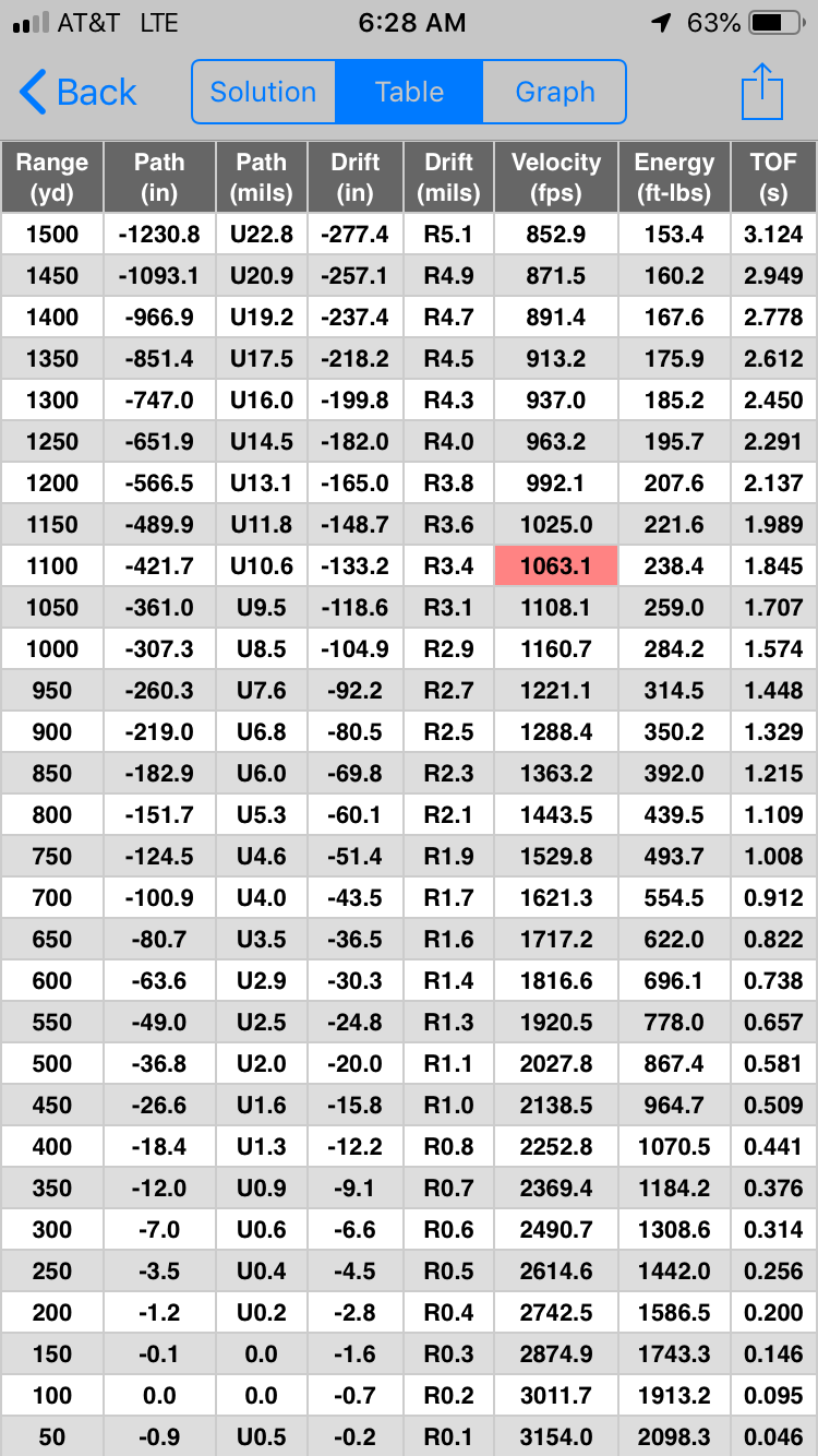

    Here’s my 260 load.
    This thing does surprisingly good at a mile
    I’ve also done fairly well with a 6.5cm 20”barreled gasser at a mile a few times.
    Hello, perhaps fill the OP in on what your conditions are for that chart. 1500 yds @ sea level with an ambient temp of 32 degrees F is different than 90 degrees F @ 6000' with a DA of 11000'. Not tryin to overstate the obvious here...
    G.
    I shoot at elevations of 900-2400 and DA of 500 to 4500 so not high mountain conditions.
    I have one spot at 6500 but haven’t been there in a while.

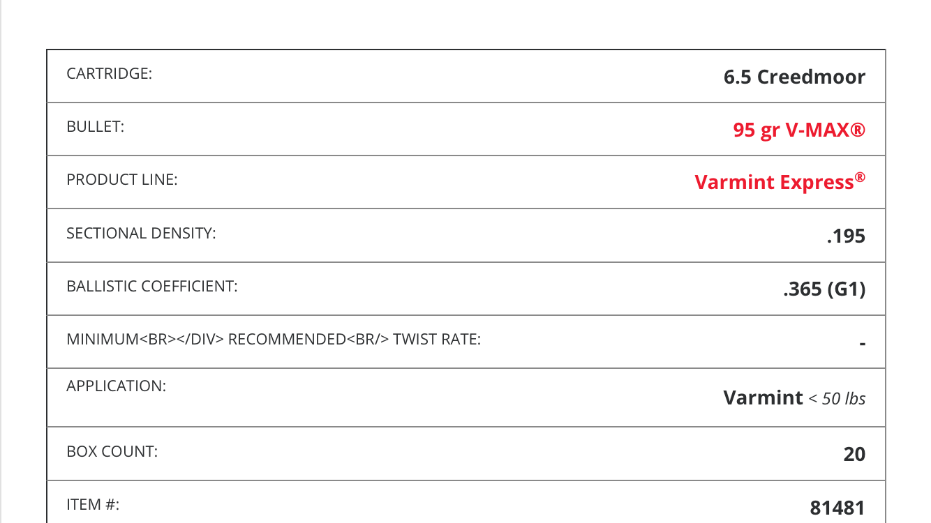

    What about the 95 grain Hornandy 6.5 creedmoor ?
    It zips out of the barrel at over 3000 feet/sec but it's a featherweight so I'm guessing it's speed will help it reach a target 1 mile away and it's BC seems to suggest it can do fairly well under a 10 mph wind
    Reactions: Woodbubba

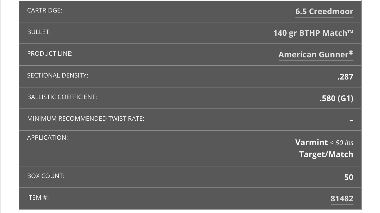

    That Bc is horrible. The lower bc also means high drag so the bullet will slow down more.

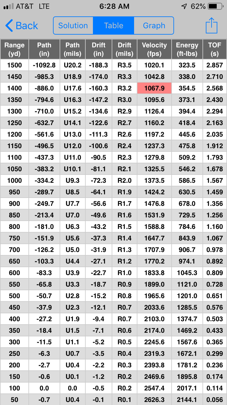

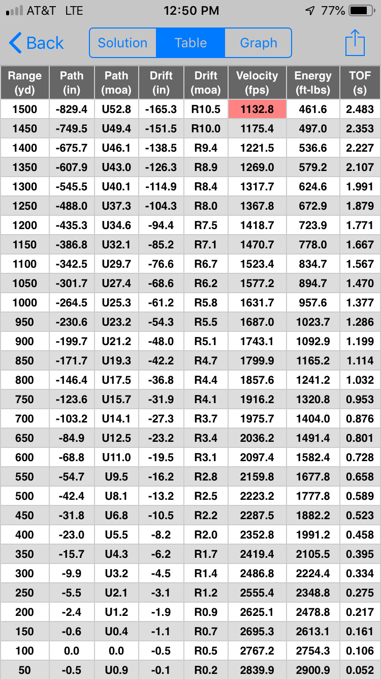

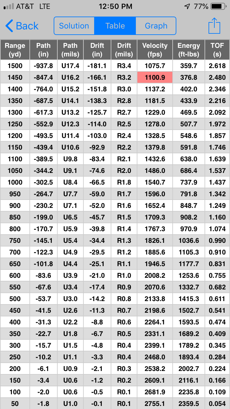

    On Saturday, DA 4800, 6.5 CM, 147 ELDM, 2747 fps. 1530 yards was routine. Next target out was 1 mile. Deep snow and looking south it was impossible to hear or see hits. But 1530 ?
    I shoot 147’s at a similar speed, in good conditions hits past a mile are totally doable but spotting is often difficult.
    I’ve hit steel numerous times and not even been able to tell at times even with top level spotting scopes.
    It’s totally fun though and sometimes you can hammer on the mile plate with it Like a boss.
    Thanks for the data Deersniper !
    Big changes in drop and windage to 500 y and horrible numbers at 1000 y and 1500 yards......
    I guess the takeaway is to use the highest BC in the chosen bullet caliber and not accept anything under .5 BC (G1).....especially for these very long shots
