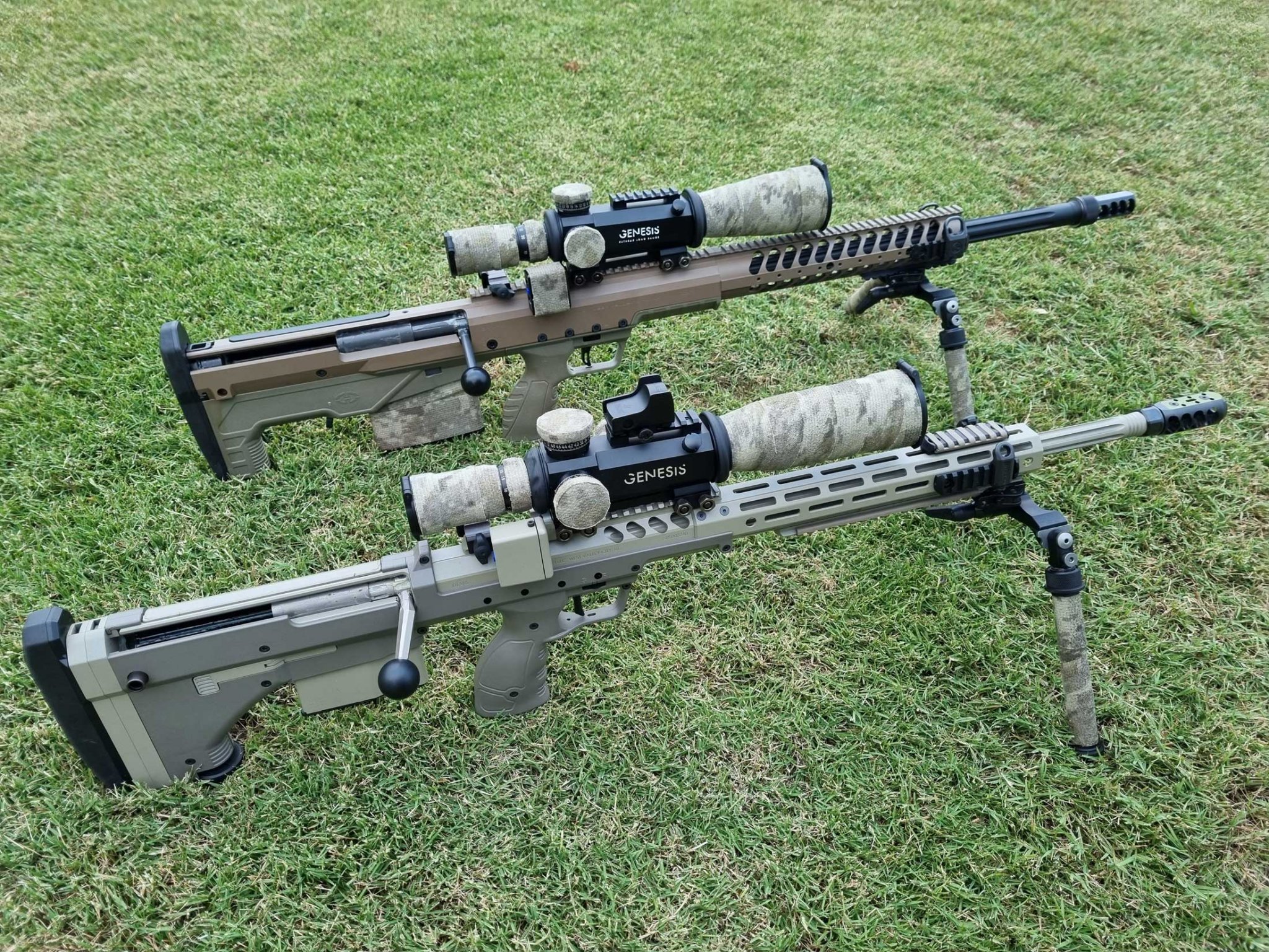

Currently have a a Desert Tech with 338L barrel conv ...500rds and very little sign of wear when looking at it with a bore scope.

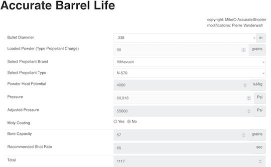

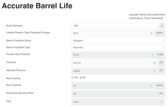

I rant this through a purporeted barrel life calculator. Compare N570 vs Retumbo. N570 is pretty brutal :oops:

That calculator is wonky. Shows my 308 as done at 2600 rounds. I'm at 6000 and still hammering, but on the down side I would imagine.
