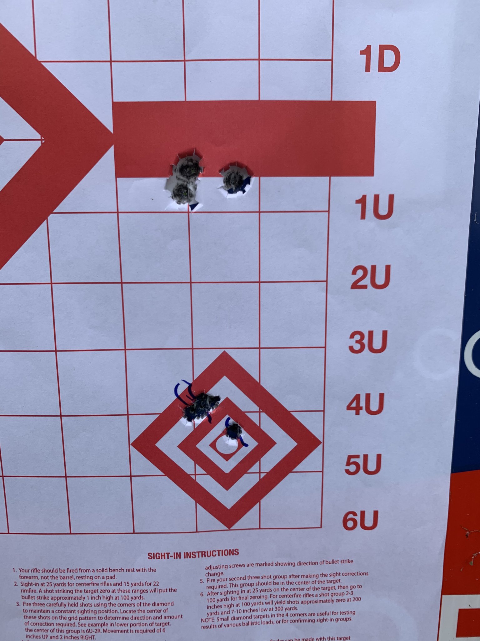

Update
GAP 6.5 Creed 20” bartlein 8 twist 3 contour (hunting rifle)
Ultra 7 6.5
berger factory ammo 156 EOL
avg 2,565 fps at muzzle
Bottom group, 5 shots @ 100 yards today, I got excited about 4 shots in 1 hole and jerked the trigger on the 5th shot.
central Indiana, elevation 880’
I think they fly fine.
Reactions: bolt handle
