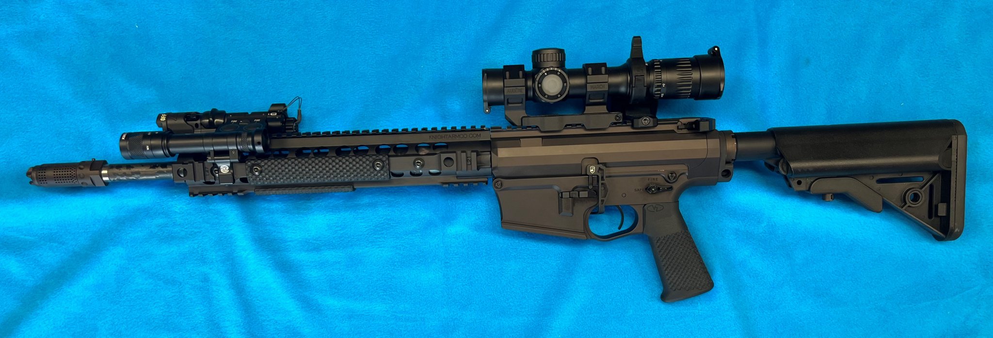

I am using one on a new build, unfortunately I have not had the time to check it for accuracy at 300 yards. When I zeroed the scope at 100 yards, it was 3/4" MOA with 5 rounds using 175 grain GMSMK. Mean velocity was 2,467 fps. I was just trying to get things setup. I need to get more time on it.

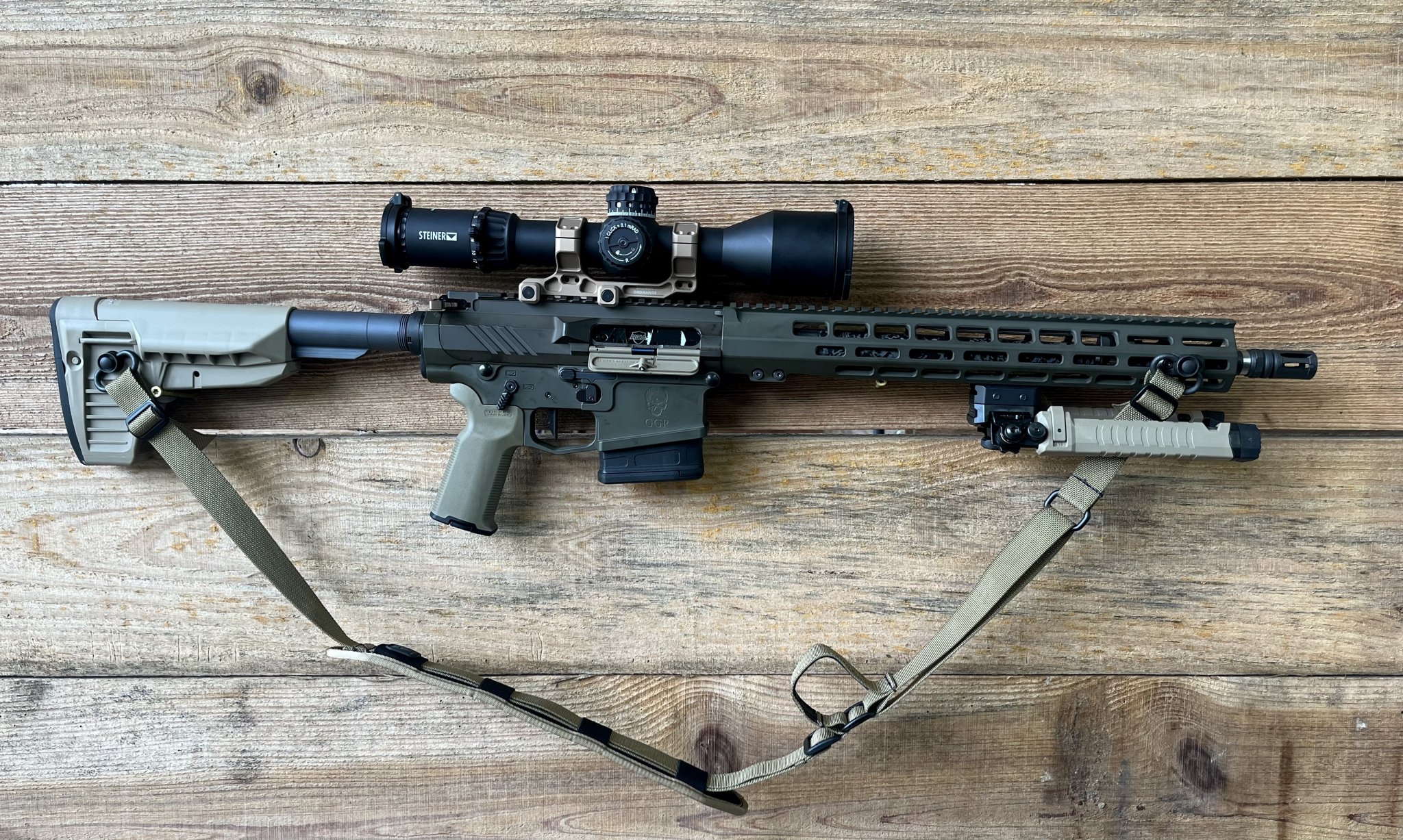

I have one, running 155 eldm's - mine is ~6lbs pre-optic and is 1/2 moa so far with N540 at 100 and 200. Still trying a couple more powders...
My parts list:
2A Xanthos set
V7 Hyper light 13.5" handguard and Titanium barrel nut
Proof 16" 308
Toolcraft Titanium BCG
Triggertech Diamond
SLR Synergy Ti mini-comp
SLR Ti Adjustable gas block
Taccom 3-stage buffer and Tubb Spring
Magpul SL-K
Ergo grip
Magpul flip ups
S&B 3-20 ultra short in a NF Ultralight mount
