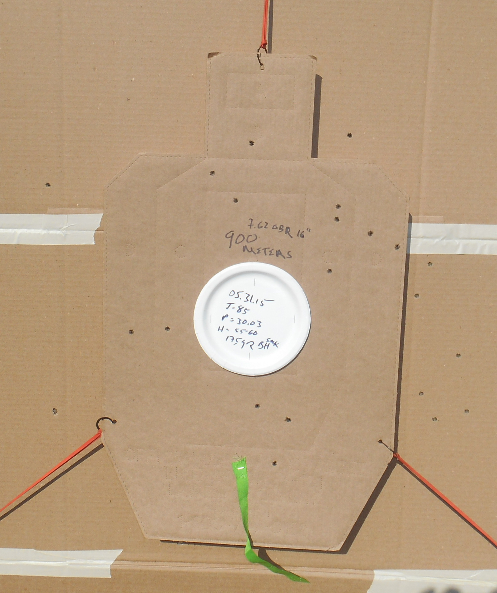

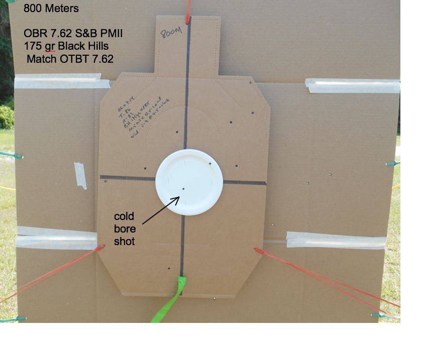

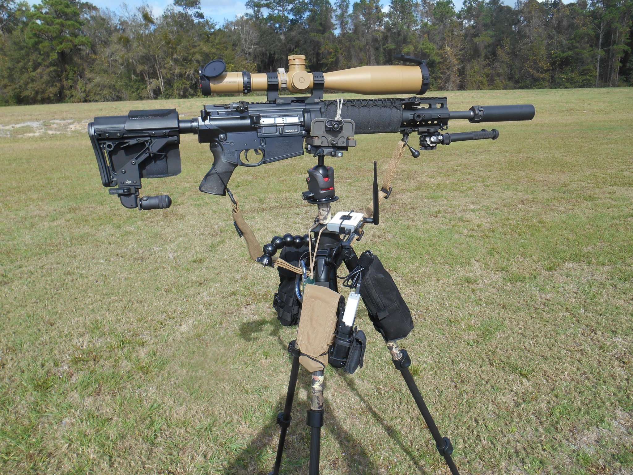

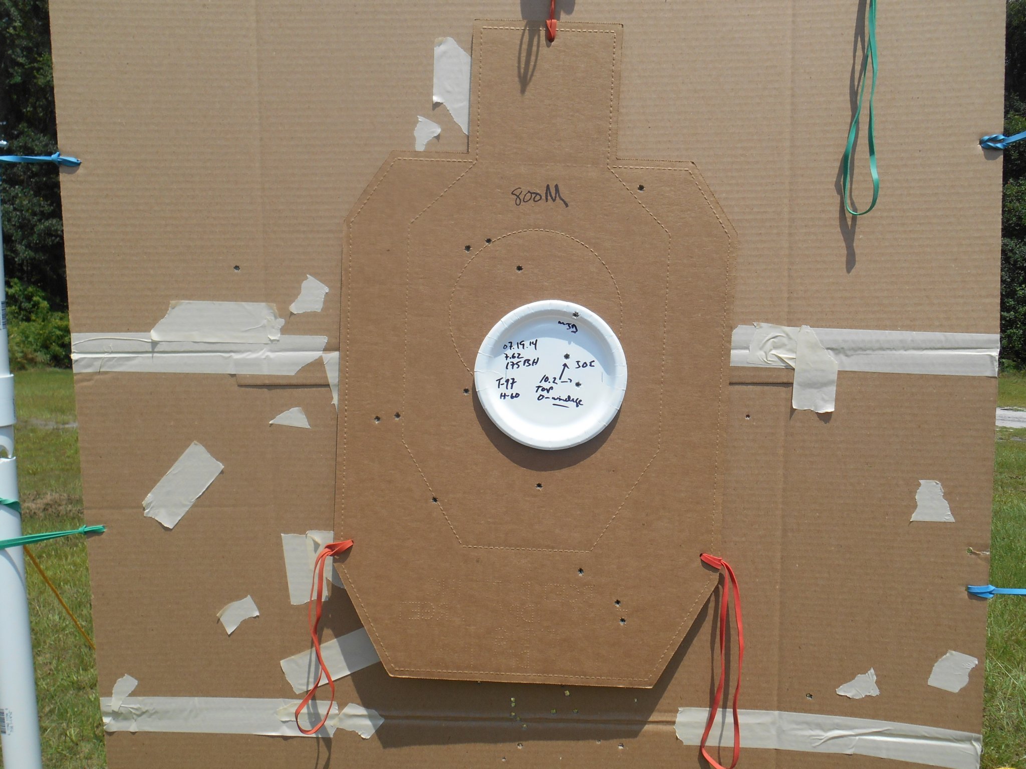

I have a 16" & 20" OBR and use a SOCOM2 can. The 16" can reach out to 800-900 meters with common factory ammo. There is a reason Bryan Litz chose the OBR for inclusion in his Extended Long Range Shooting textbook. Don't appreciate any difference in recoil pulse between a few inches of barrel length in 7.62.
