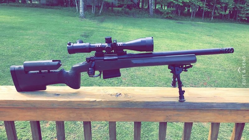

I run 140's around 2700 fps from a 6.5x47L in an 18" R700. About 12 lbs as pictured.

Have you ever chronoed any lighter bullets out of that rifle? 120-130s?

Only shot 130 vlds so far. Getting around 2700-2750 with H4350 and 2800-2825 with RL-17.
Will probably settle on a load around 2700, no need to push it for my purposes of a mid range deer killer. Easier on the brass and the can.

What are the spec on your ride if you don't mind me asking, I "need" to build something very similar
Thanks
Thanks
Built by Accurate Ordnance:
700 SA trued
Kampfeld fluted bolt and knob
Manners EH4 with mini chassis skim bedded
Timney 510
Brux #5, 1-8", at 18", threaded 5/8
I had the firing pin bushed as well, think they farmed that portion out.

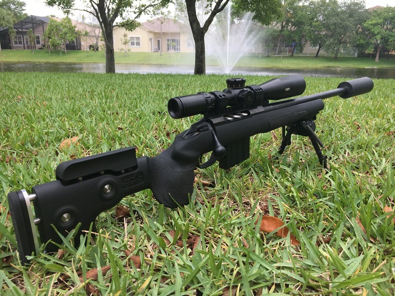

I love short barreled rifles, I put one together last year for my son, it's a 16" .260Rem built on a 700 with an AAC barrel. Its a sweet little rifle, Jr. used to take his first deer and elk this past season:
That's a great looking stick. I'm finishing my Tikka 260 CTR version of this. How do you like the Minox and what bullets and loads are you using?
I love this little Minox, its a bit light being 1-6, but I wanted that for a reason. With newer inexperienced shooters, its a lot easier to get them on target with a lower magnifying scope. And 6X is plenty for shooting deer and elk inside 600yds, if you have good eyes anyway. The eye relief is pretty forgiving, and it just fit the gun perfectly, the small objective allowed me to mount it low enough for him to shoot it properly.
The bullet I loaded for the gun was a 120gr BTHP match from PVRI, I got 500 of them for a great deal, and they shot very well at just shy of 2800fps. Good enough for me to make cold bore hits at 700 yds anyways. Junior used his little rifle to take the deer pictured below (490yds) and the elk pictured above (530yds) . Its a great little hunting rifle.
