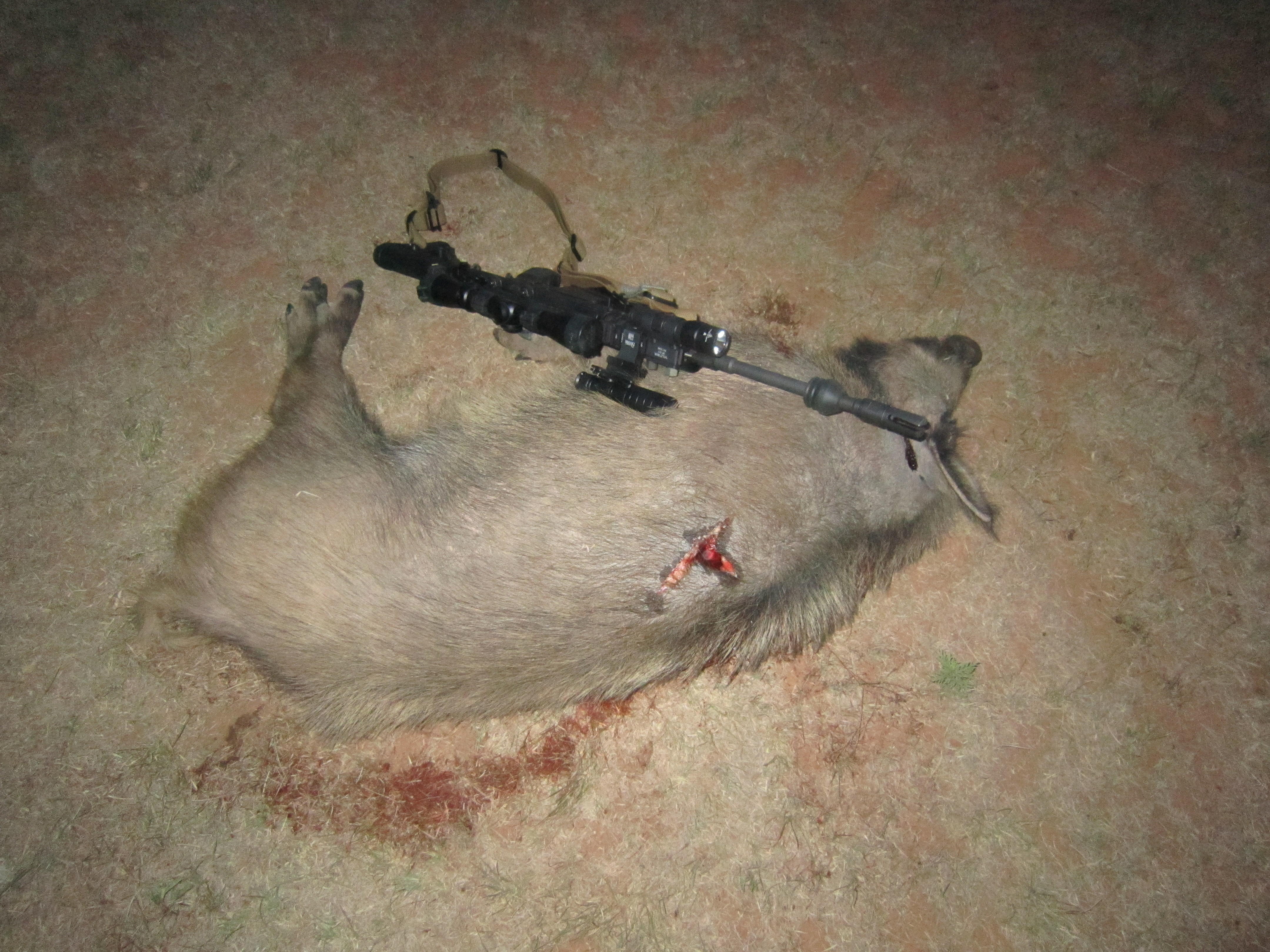

Kills the snot out of hogs past 200 yards so far - so I suspect it will kill Ivan, Pedro, Muhammad, Wiley Coyote, Peter Cottontail or Bambi with ease.

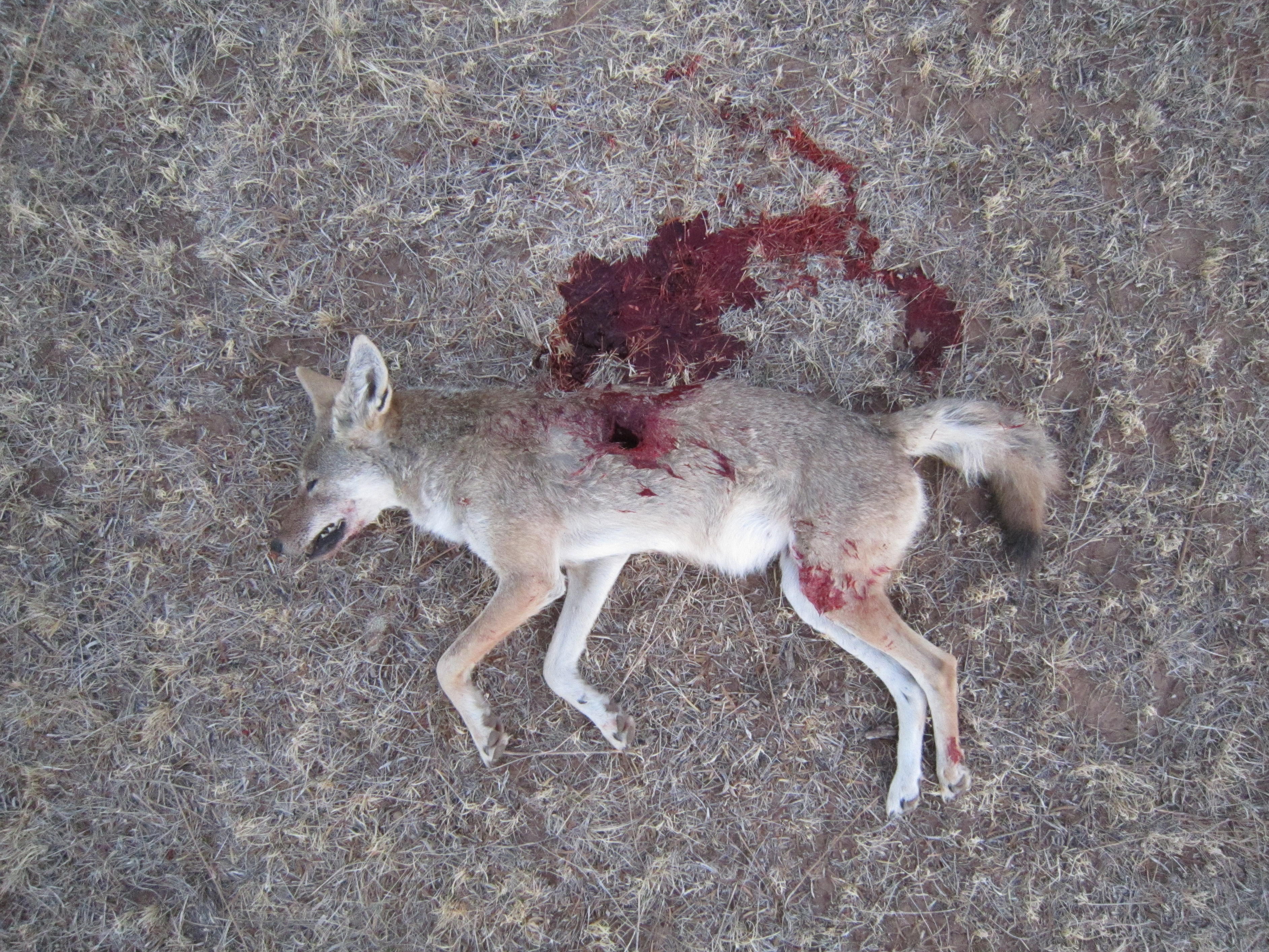

Since you asked about terminal performance...both with a 16" DPMS 308.
168gr Prvi HP @ 75yds (MV unconfirmed)
150gr Accubond Handload @ 80yds (MV unconfirmed)
