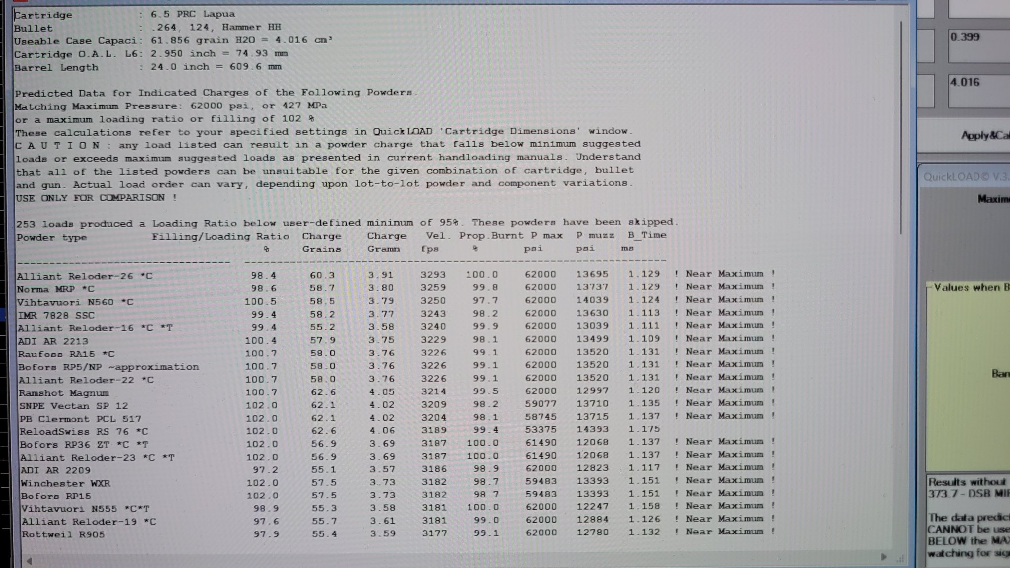

quickload says of the three powders, 4831 (both) works better than h1000 in this combo. Top speed is RL26. Rl16 is also great, as is vv n560, rl22, rl23.
I can find 16 and 23, I’ve have never used that software, does it it give a starting point on those?
Yes, quickload gives you estimates based on what you input. It has the ability to give you a table of estimates from a starting point, minus some percent below to some percent above. The data I input uses data trued to my powder lot in my experience, but should be close enough.

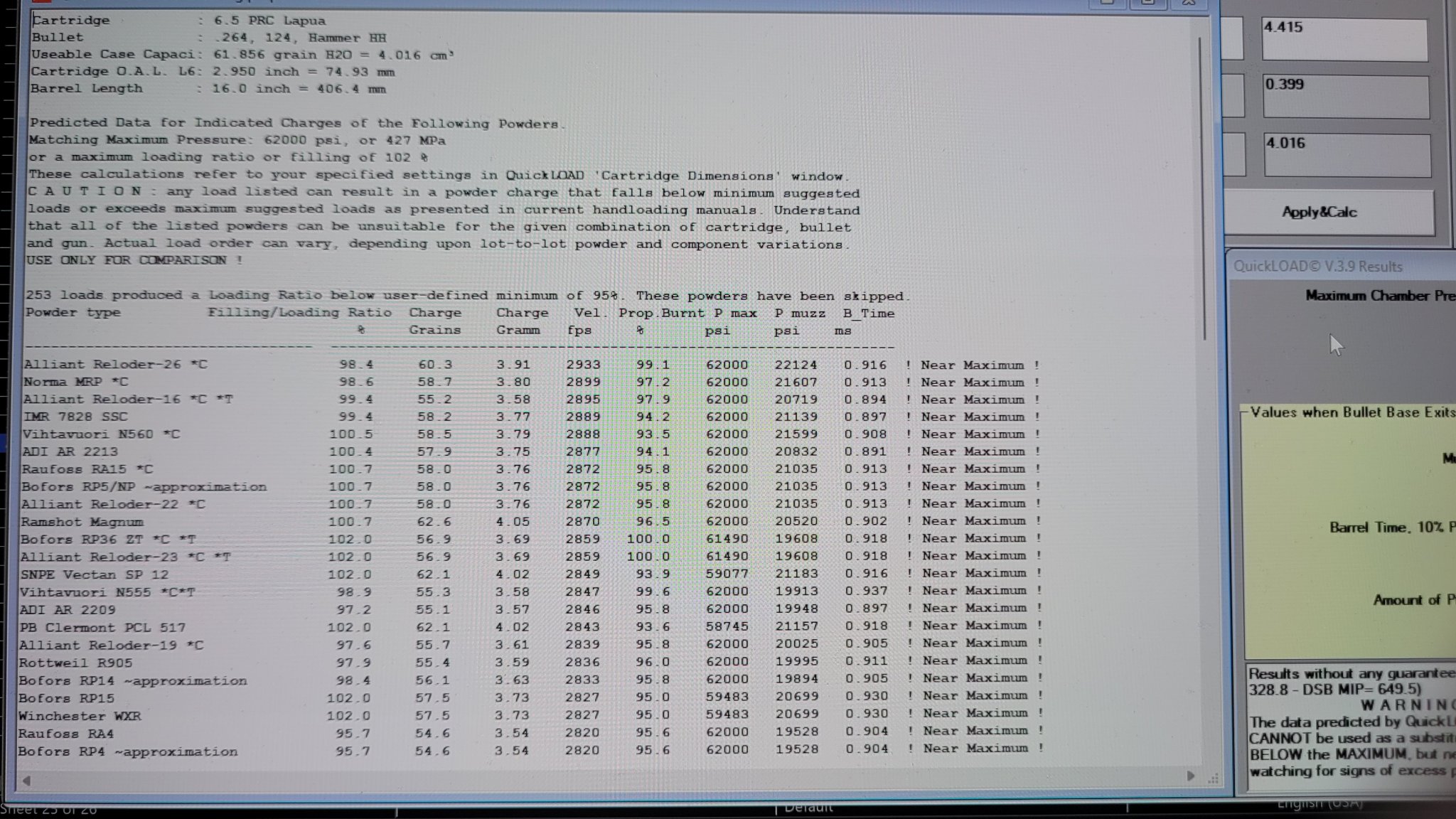

I input 62000psi as the max to get a table of all possible powders. Rl26 came out top, followed closely by the ones mentioned. I would caution you start at lower charges than what's shown here to validate your powder lot.
Edited this to give photo of propellant table using 16 inch barrel. Original used 24 inch.
