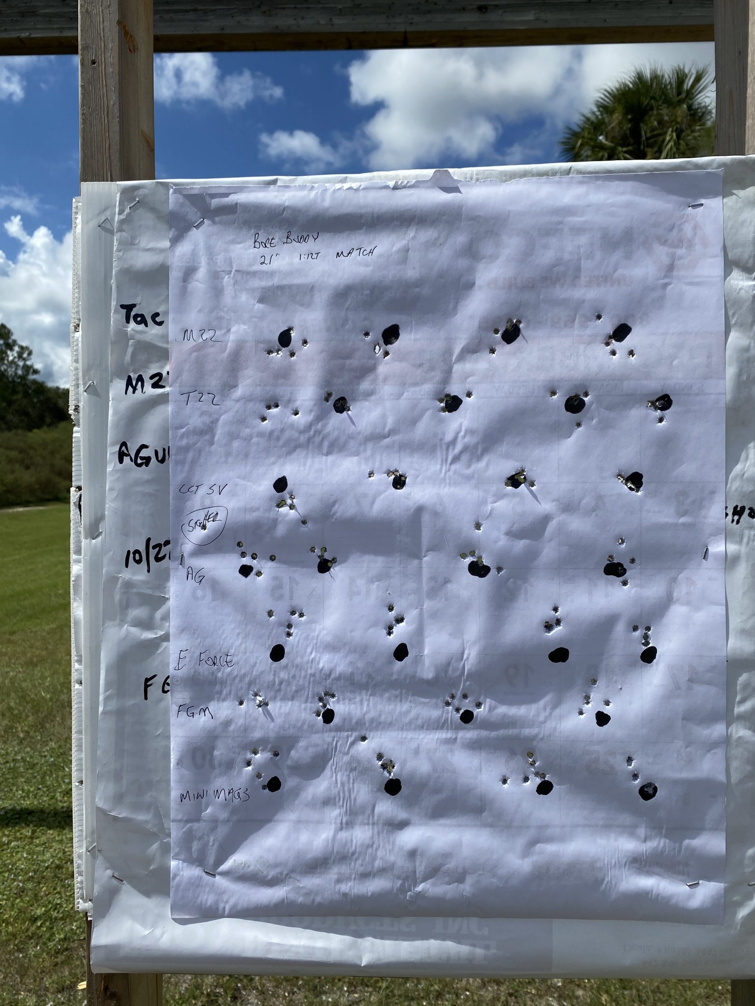

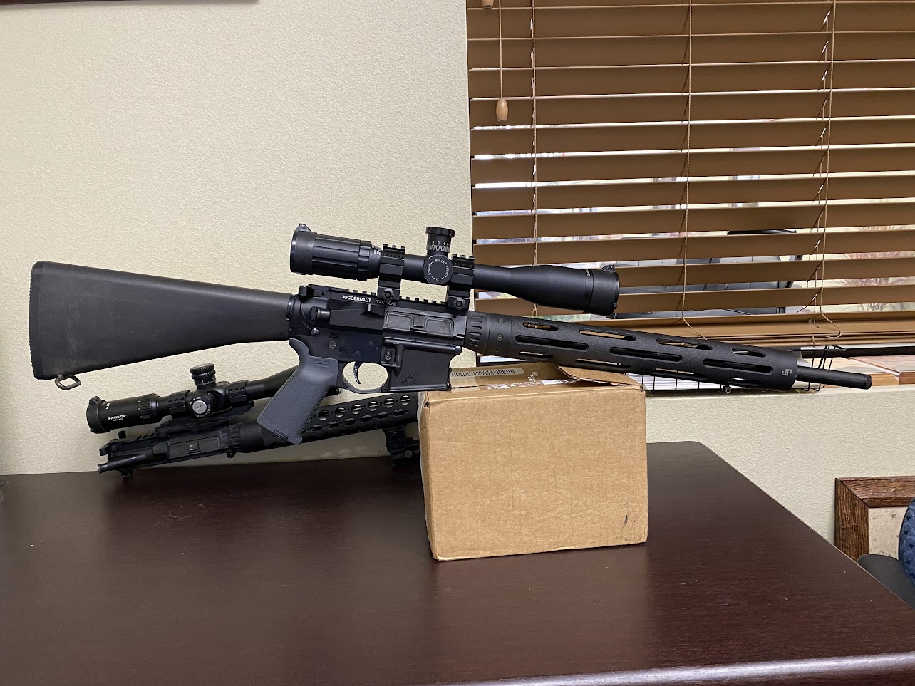

As a follow-up to this, I purchased the 21" Borebuddy Match Barrel and mounted in a Juggernaut Tactical upper receiver and a 15" JP handguard. I did a visual inspection and ran a few cleaning patches down the bore before assembling. Bore was smooth and the patch passed through nice. I put this on a lower with the Catch22 device, A2 stock, and RRA 2-stage trigger. Shot off a bi-pod and rear bag with 10x SWFA scope
I shot 145 rounds through it; Norma Match 22, Tac22, CCI SV, Aguila Std Velocity (blue), Federal Gold Medal Target, Eley Force, and CCI Mini-mags. For the most part I shot (4) 5-shot groups from left to right so the group furthest left will contain the fouler/seasoning shots. And you can see that many of the groups tighten up nicely as you move to the right. It was central Florida hot and sticky with a slight breeze at my back. But I had a solid bench setup and feel pretty good about this session...meaning no excuses.
The Borebuddy barrel I thought shot pretty well. It fed everything I put in it. Not one issue with feeding. I think it did the best with the CCI SV and even shot the Eley Force (1,200fps) very well.
