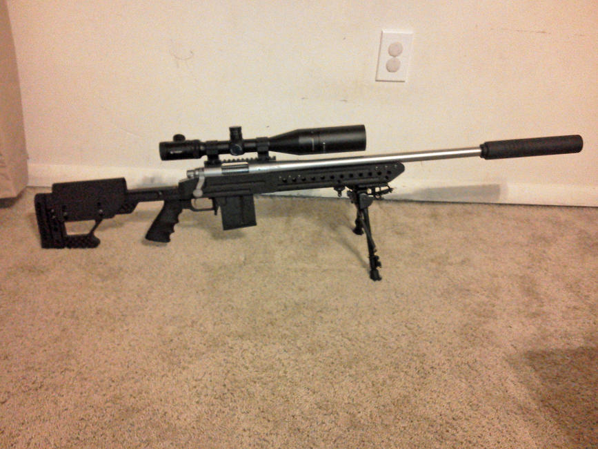

this will be a hunting rifle. i am not taking my 5R 308 in the woods. one, it is heavy, 2, i'm just not.
