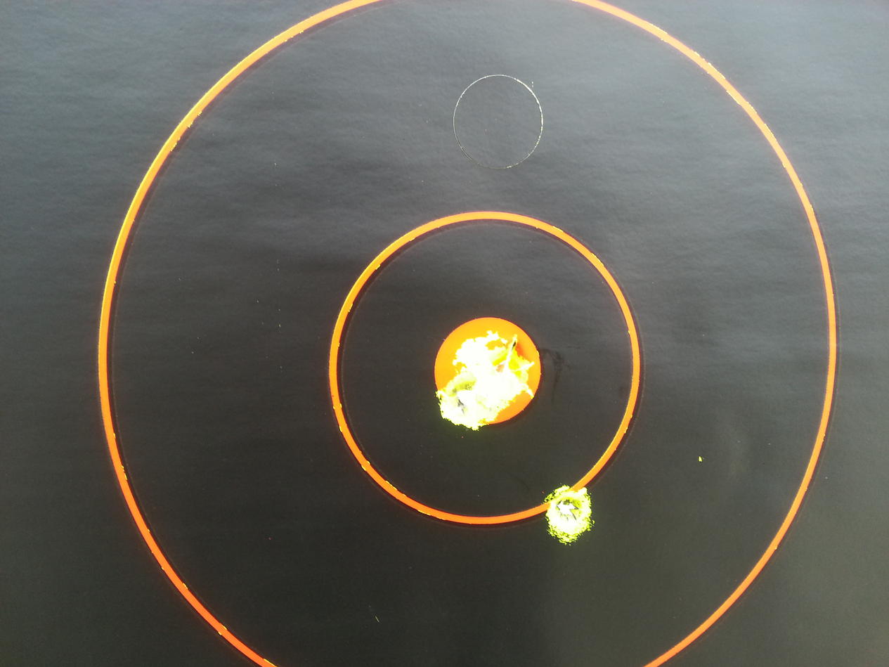

Yea I have a group 6 shots 300 yards, flyer was first shot before correction, next five were money.
