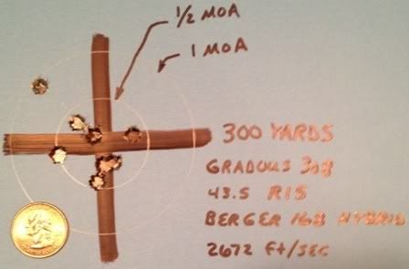

Here's a group that I shot using a guesstimate load that I loaded prior to performing the ladder tests.
I should have stopped after the 7th shot.
