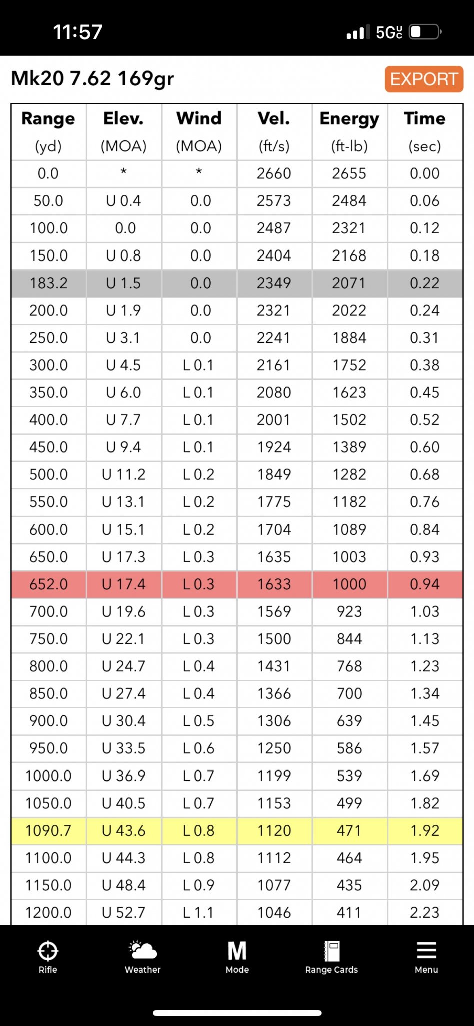

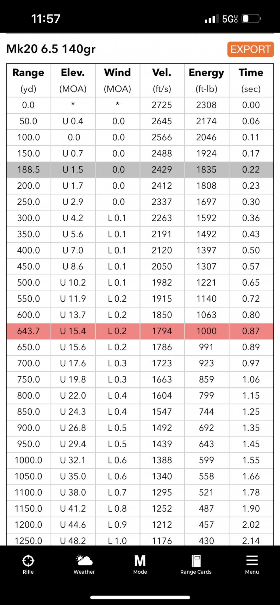

I’ve had good luck with the 169gr. SMK in my Scar 20. The increased BC over the 168gr. is noticeable at extended ranges in my testing, and the accuracy is there, consistent MOA groups and no problem ringing steel out to 1000 yards. It does not keep up with the Creedmoor beyond 1000 though and it took me a while to find a load that gave me good accuracy and SD/ES numbers. These are my cards for my 169gr. load and for my 140gr. Hornady BTHP load with a 6.5 Creedmoor barrel, same rifle.

The 169 goes beyond the 800 yard wall (~720 meters) better than the 175.
I really like it and its not jump sensitive and performs well in bolt and gas guns, extending max effective range by about 10% or so in my testing against the 175.
That said, The 308 is an 800m and in cartridge and the 169 provides a nice boost in hit probability beyond 600m over the legacy 168/175 in this regard but its not a wonder bullet that will turn your 308 into a 24-26” 6.5 creed pushing 140-147 class bullets, IMO.
